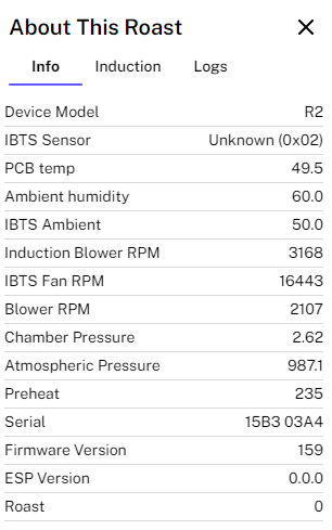

I was digging around through live roast data this morning and found in the roaster info where it says the IBTS is “unknown”. Any idea what that should say instead? Maybe something is actually wrong with my IBTS?
roaster_info
That is strange, I just saw another post where he talks about IBTS being “unknown” and that refering to a legacy IBTS, though I have no idea what that means.
Maybe that has something to do with it?
And why does your roaster info say you’ve 0 roasts?

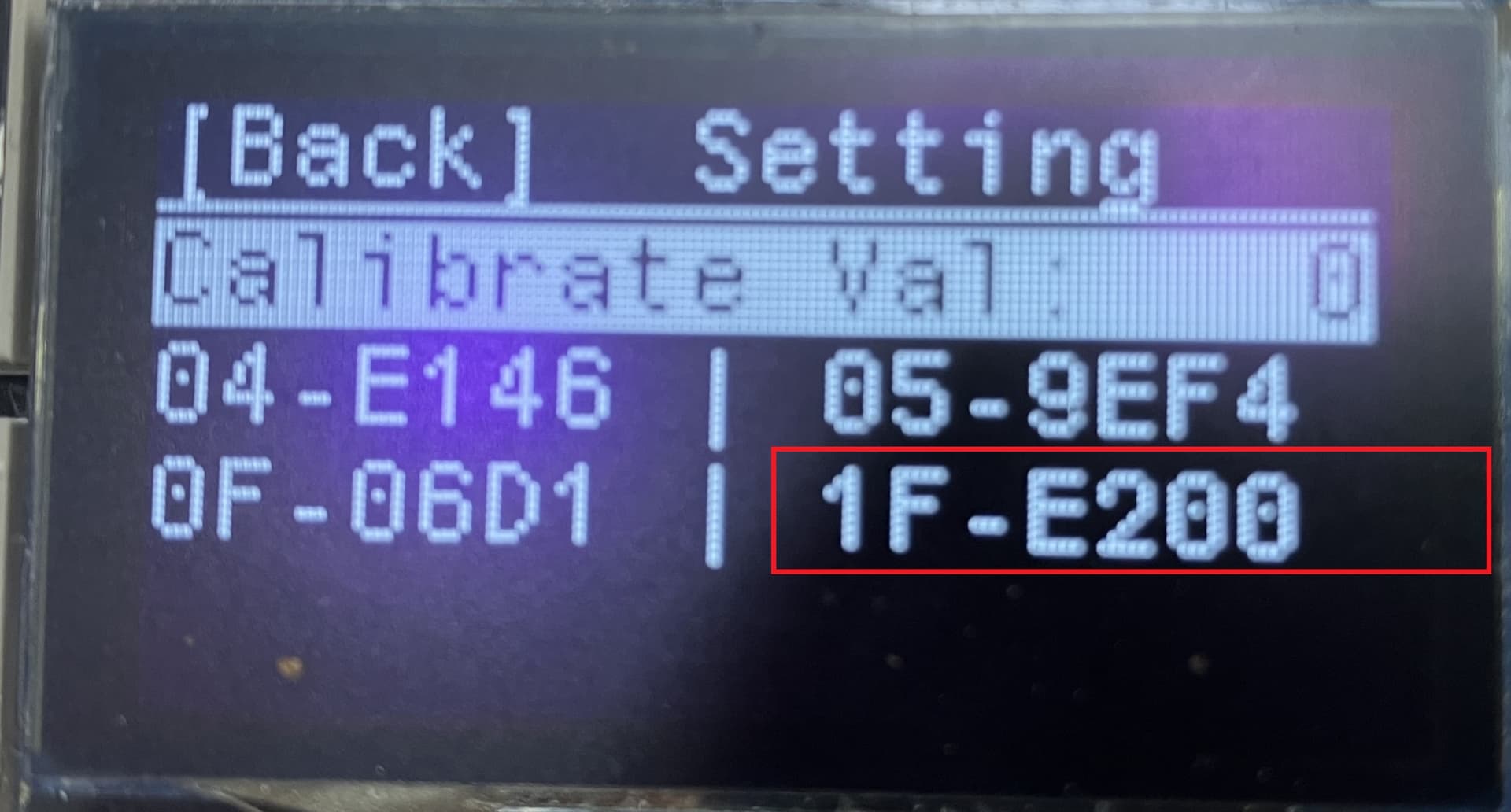

Hi all,
For the Bullet R2, seeing the IBTS as “Unknown” in RoastTime is currently expected. The R2 firmware that supports sending IBTS information to RoastTime has not been released yet, so some information may be missing or displayed incorrectly.
This does not mean that your R2 has a legacy IBTS. You can check the actual IBTS information directly from the R2 display menu. The IBTS batch ID should normally show E140 or E200, which are newer IBTS batches.
Sorry for the confusion. This information will be available after updating to the next firmware release.
Thank you.
Thank you for that info, @jedsadazisz! I see where mine is 1F-E200, so that’s good to know that it’s expected behavior for now.
@centralkycoffee I have no idea why it says 0 roasts. I’ve done close to 100 so far, but I never paid attention to that roaster info panel before so I’m not sure if that counter ever started going up or if maybe it’s more like a session counter where it’s the number of roasts since last power on. I’m going to try to roast some this morning, so I’ll watch and see if it changes at all.
