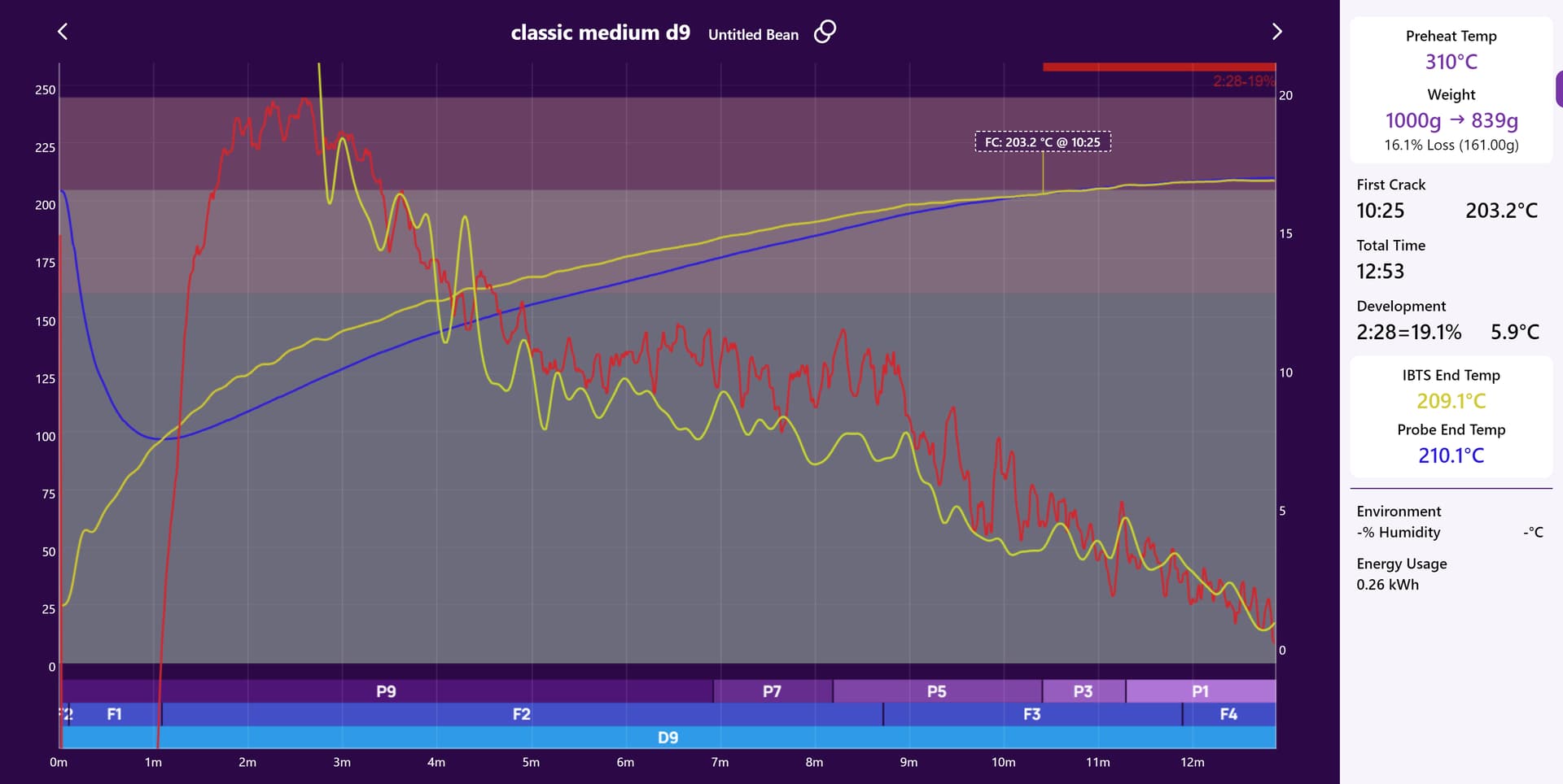

I didn’t have any close profiles to share, so I made some new batches for comparison. I was really surprised that the timing didn’t change much at all. I was under the impression that lowering the drum speed was speeding things up. I guess it goes to show you how easy it is to make a mistake.
Aside from the brief difference in fan settings, the settings on this next roast were the same except for the drum speed.
I didn’t see any change in roast time overall. I was expecting a bigger difference just based on the drum setting. others have shared in this forum their experiences as well. none of this is new information but I thought this might help the next person that finds this post.

Also, on 1kg batches the difference should be less, but not as much as it shows on your examples. Although, the D9 had a bit more steam coming into the FC and had a higher DT, so it was a little bit faster.
