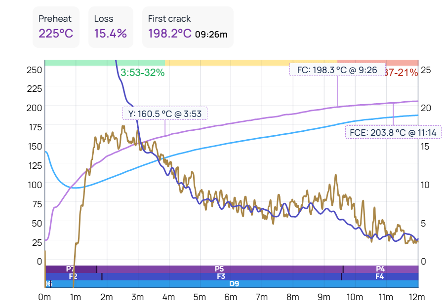

Hi, I was also tinkering with this and use 350 g batch size. In a recent roast I got within a few degrees of my target drop temp by 12 mins (211 is halfway between 1C and 2C start) and was a little bit off for 1C (a little bit higher charge temp or longer p7 would have done the trick).

I recently went through this exercise (for 550g batches) and found it really interesting and helpful. FWIW it took me 11 roasts to get to a result I was happy with!!
Here’s my final attempt, I decided to stop before I drove myself insane!
