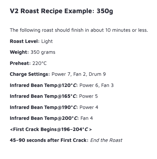

Check the screenshot attached. It’s from the Aillio BulletR1V2 official manual:
Hope that helps.
