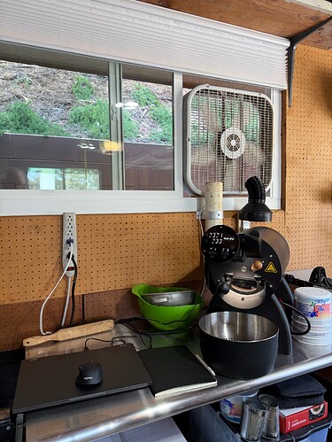

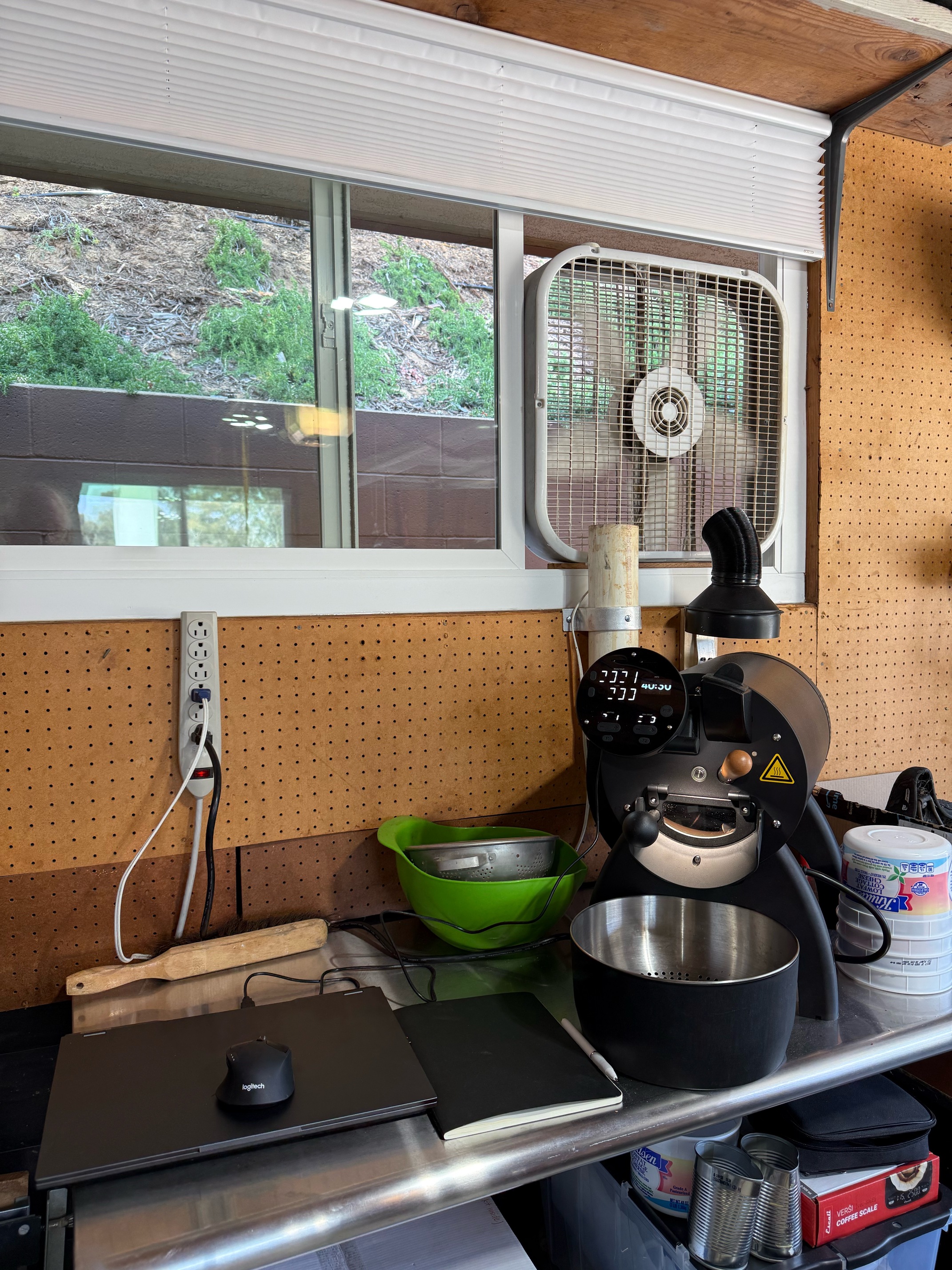

Old home roaster, new Bullet user. “Old” means I have had a variety of solutions to ventilation over time. The range includes roasting outdoors in a non-windy location, roasting next to an open garage door, roasting on an elevated stand below a small commercial hood, and this, which works best of all:
I’m still in the garage, this time with a cheesy $20 box fan in the window, set to its lowest speed. The 6” to 3” adapter works great for the drum ventilation, the decrepit looking 3” pipe is direct connected to the bean cooling tray with the rest of a 1m piece of 75mm heater flex duct.
The fan keeps all but light whiffs of roast smell away, the ducts are very effective at evacuating virtually all the typical smoke, including the heaviest parts of the roast.

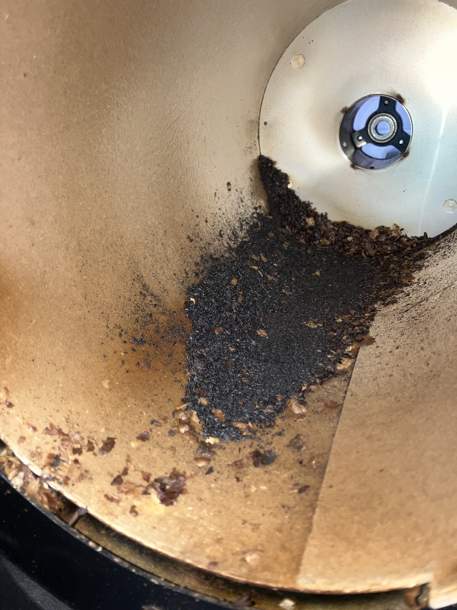

are you getting chaff buildup surrounding the drum? sometimes chaff builds up and then it just burns to a char.
usually more often with naturals. i used to blow air through the rear vent to expel the excess chaff after a roasting session, but currently in need of a new one, since the old one was too powerful.
Prior to moving upstairs to a dedicated space, my setup was identical to this and the CFM’s the box fan was able to move was exceptionally better.

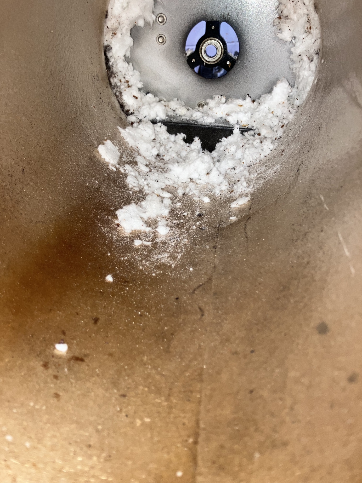

i can’t really say for sure about your situation. but because there is no seal between the main drum and the insulation fiber, you have to be careful if you blow air into the main drum. tech support said it was fine, but now having taken it apart myself and seeing it, i think they may have misunderstood my question at the time.
but more directly back to smoke and airflow, i did notice smoke coming from the tryer and that prompeted me to remove the drum and look inside, and it is important to vaccum or softly blow out the chaff surrounding the drum. with washed coffees, this isn’t usually as much of a problem, but i recently started roasting naturals more frequently and so this was my first experience with chaff build up outside the drum causing airflow and smoke issues. because smoke was comingnout the tryer at F3. which had never been an issue before. but yeah. i skimped on it a couple sessions and so important part of maintaining. as it can also lead to ventilatikn issues if the smoke isn’t fully exiting at the rear impeller.
note: this is note an issue with the machine, but more so a brief maintenance oversight on my part.

So I just discovered this this morning. I didn’t remove the drum but I tipped up the roaster with the faceplate off and a giant pile of ash just came out onto my workbench. I thought that vacuuming around the drum every few roasts would be enough to keep it clean but evidently I hadn’t appreciated this build up!
