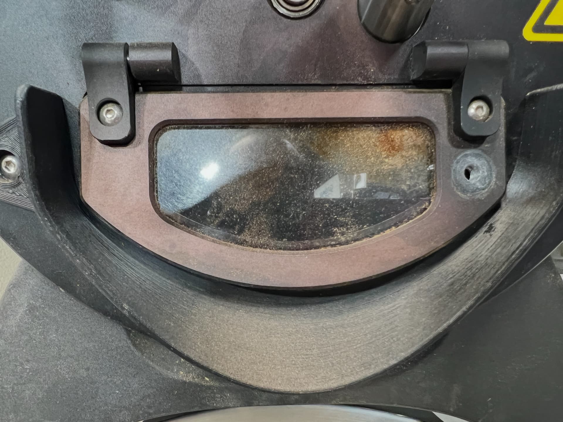

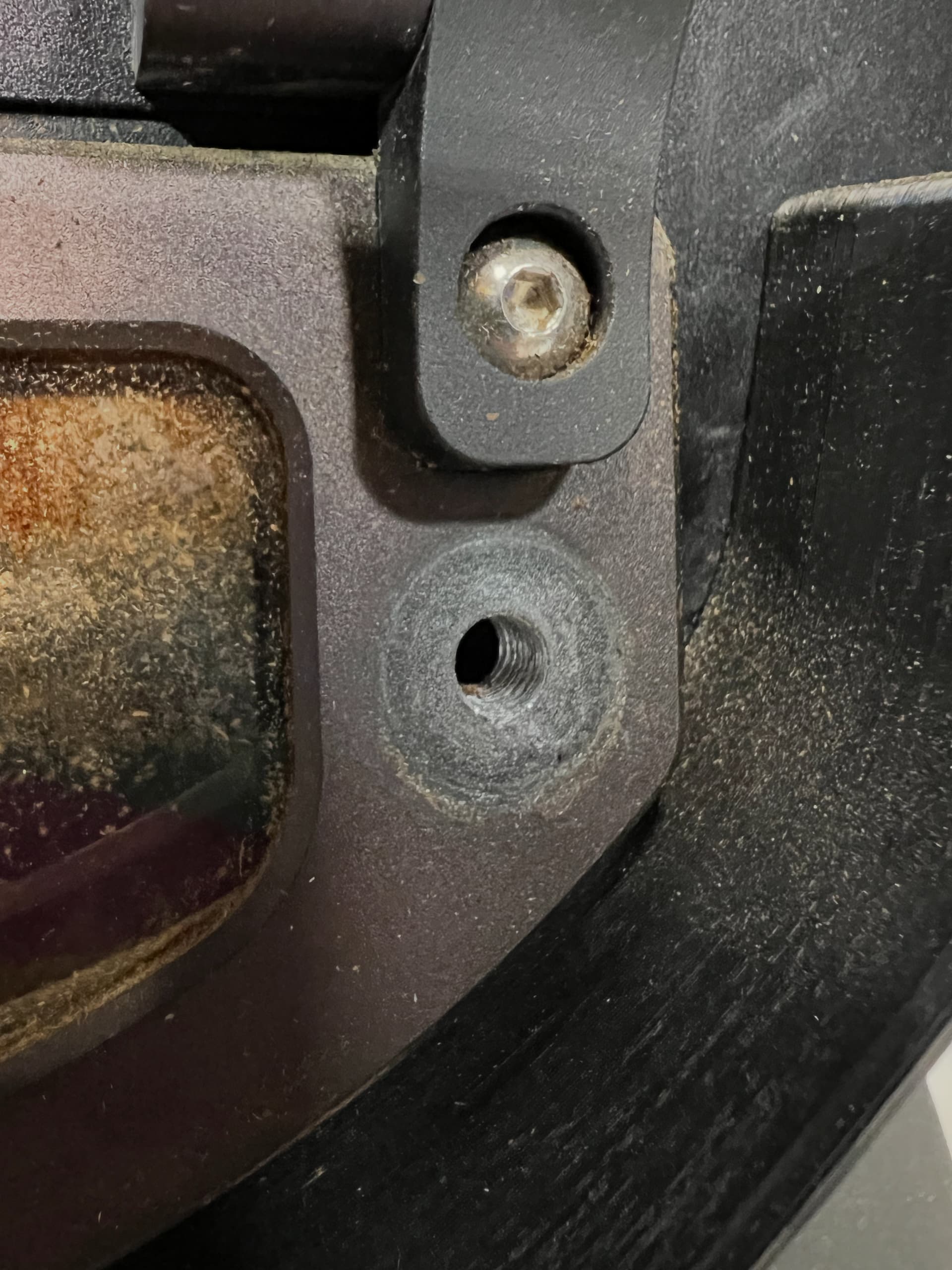

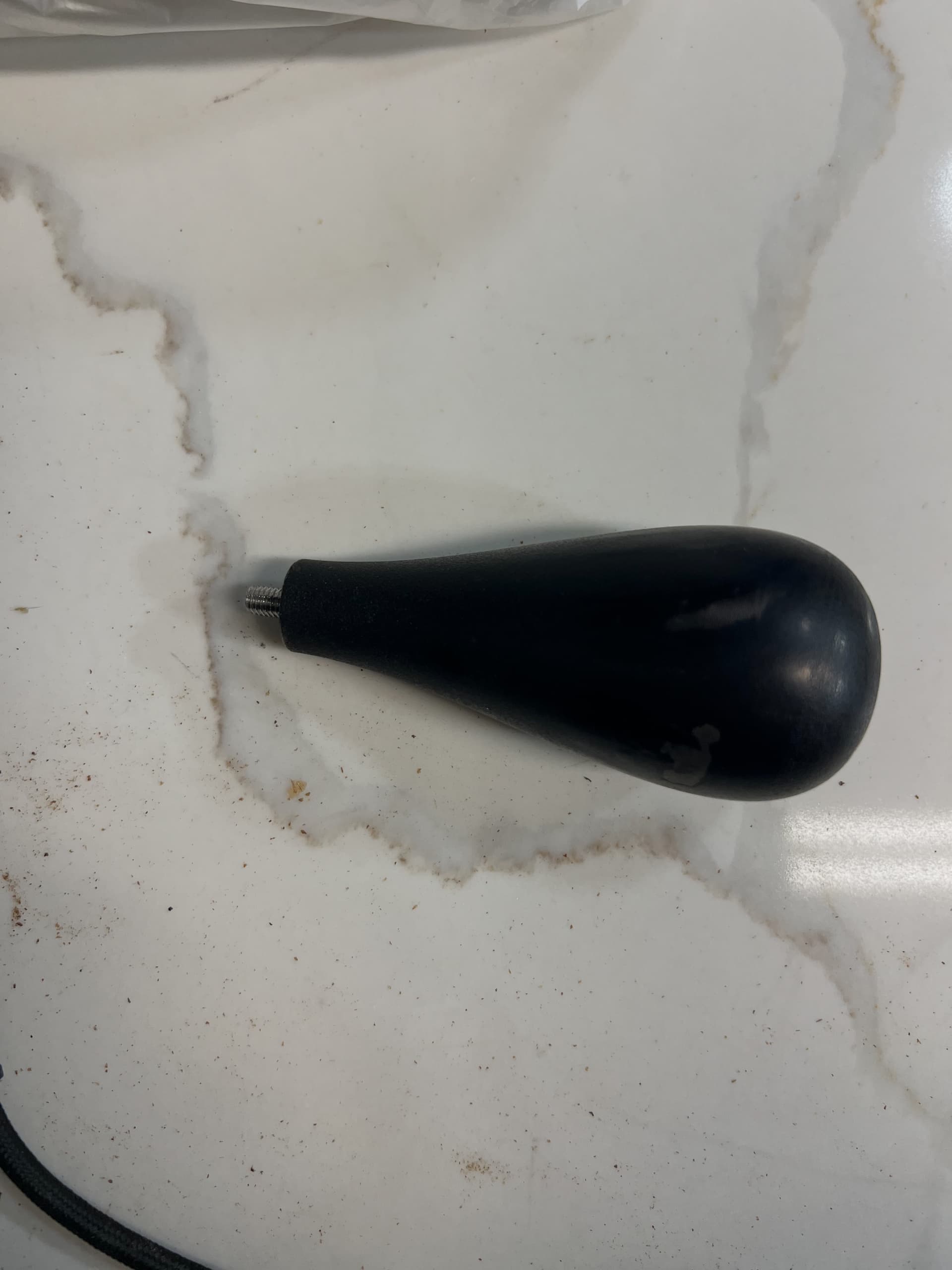

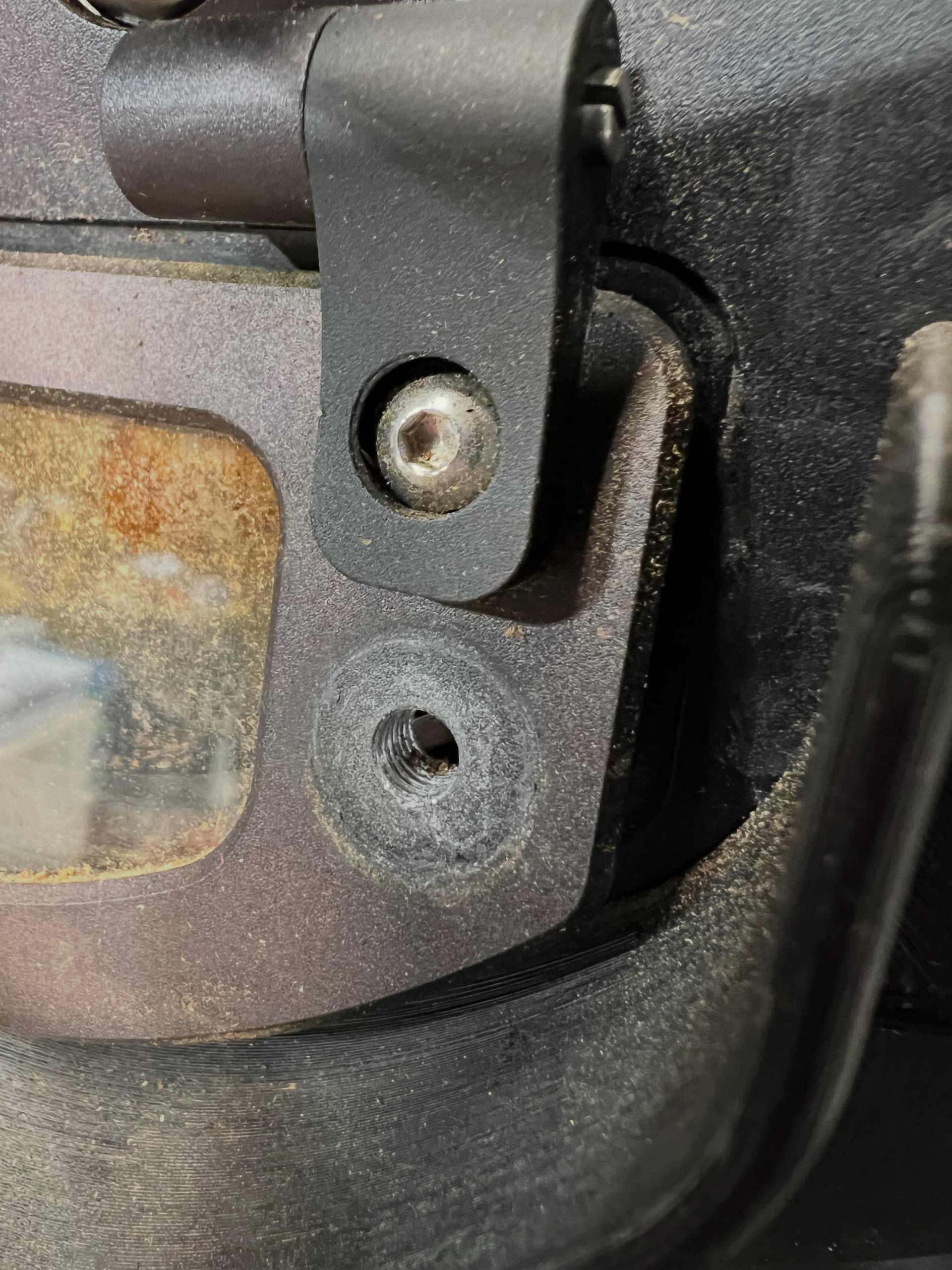

Hi @thewildcup,
Thanks for the post. Could you take some pictures of the Door Handle Screw and Door?
Best regards,
Kevin
Hi @thewildcup,
Thanks for the pictures. You’re right, the threads on the Door and the Handle Screw seem fine. Could you tell us how you been installing the Door Handle? Did you install the screw from the underside of the Door or just directly screw it on with the Door Handle?
