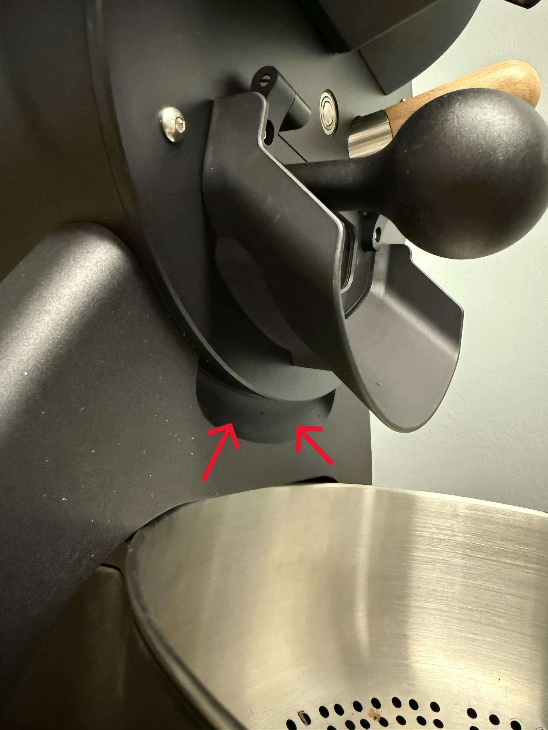

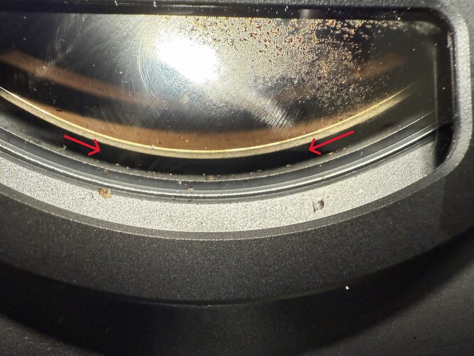

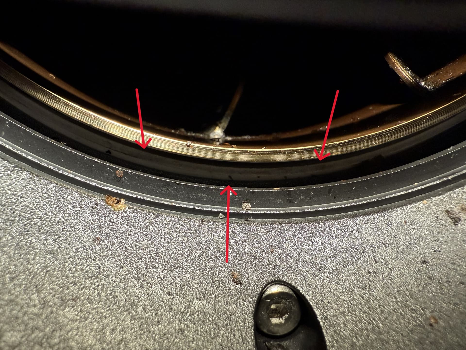

I got my Bullet R2 recently and I’m working through my seasoning roasts right now. I’m having an issue that when I dump the roast to cool, a couple beans will get tucked underneath the drum, where the arrows point in the pictures below. If I’m careful, I can get them to come out and fall into the cooling tray, but a couple of them have just fallen down. I’m not really sure where they went (presumably into the body of the roaster), how to get them out, and how to prevent this issue. Has anyone else run into this problem? I’ve looked at other topics about them getting stuck during roasting, but this is exclusively when I open the door to dump them for cooling. Any help is appreciated!

Thanks for the tips! I pulled the faceplate off this morning and found that the beans were actually falling into a little slot behind the bean chute that passes directly through and still drops them into the bean tray. Thankfully nothing under the drum! And I vacuumed the drum out while I had it open, and it was very satisfying to get all the beans out that have stuck during seasoning. Only a few more seasoning roasts and I’ll be ready to roll!
