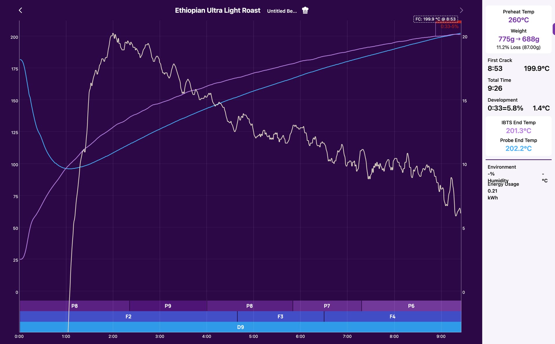

My favorite beans are Natural Ethiopians roasted very light. For a 775g batch size I usually charge around 260-265*C and dump around 5% / 30 sec development time. I’ve had success with finding some amazing fruit notes and clean, acidic cups

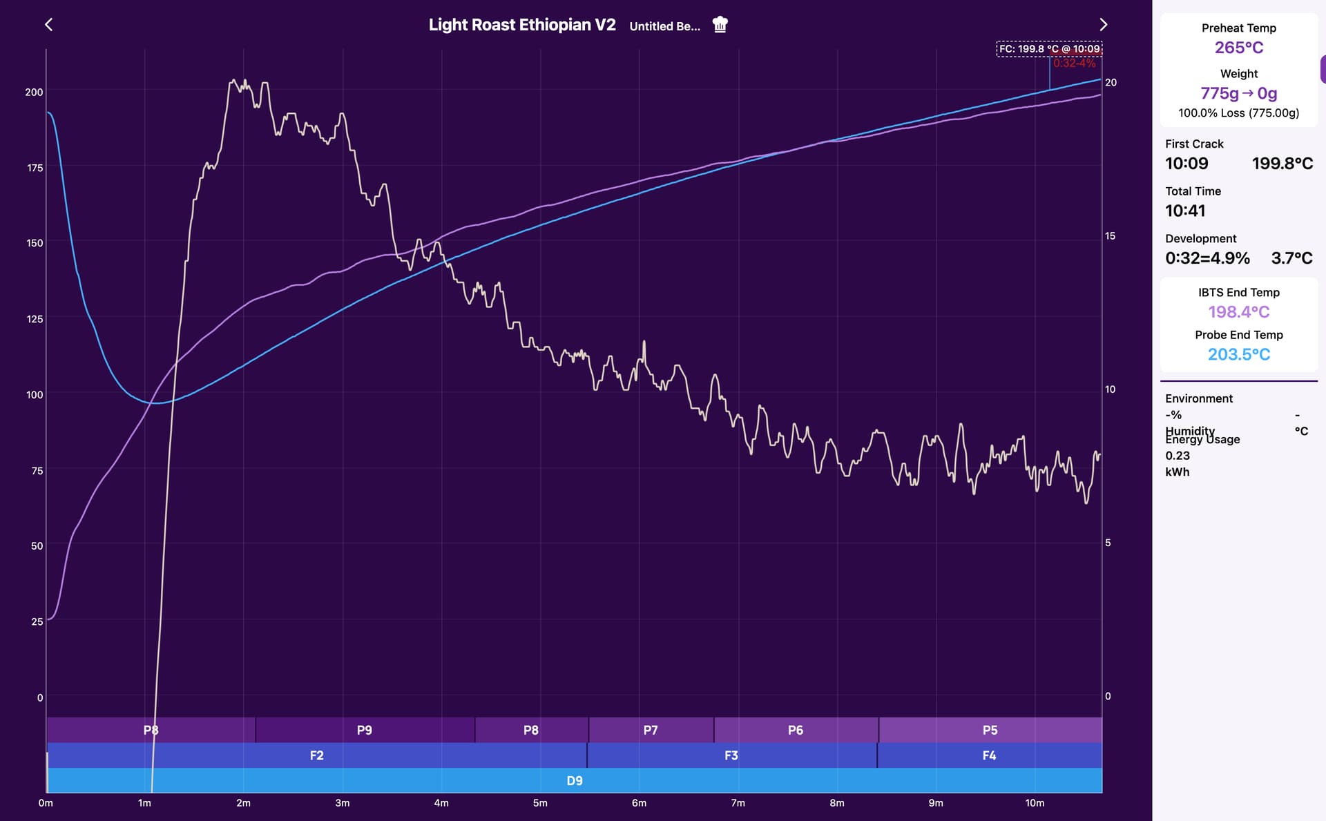

The P settings in the roast profile for my Ethiopians typically looks like P8 > P9 > P8 > P7 > P6 for the last couple of minutes. I don’t adjust drum speed at all but use F settings to manage RoR

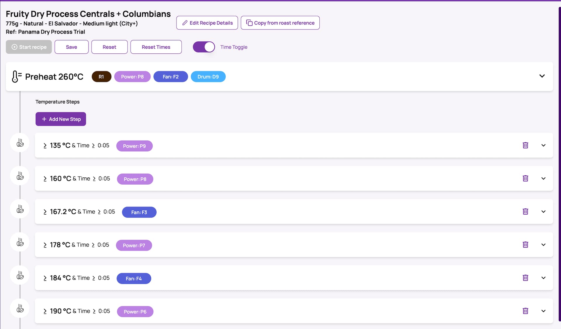

Here’s an amazing recipe I use for Fruit forward natural central/south americans that really keeps things light and fruit popping. It’s been fun to roast and my friends and clients really like it with no complaints about body or acidity.

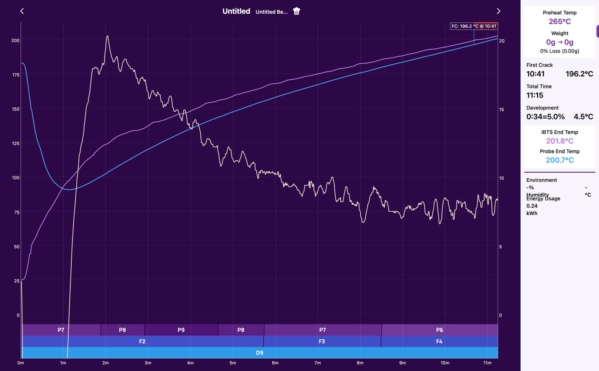

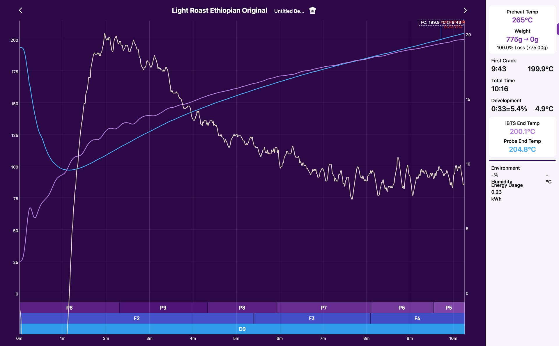

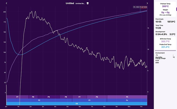

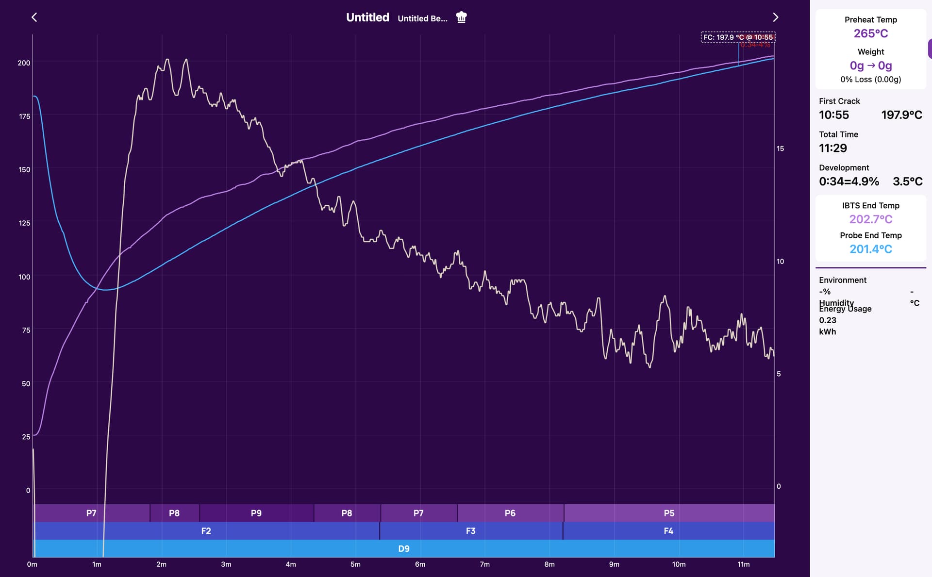

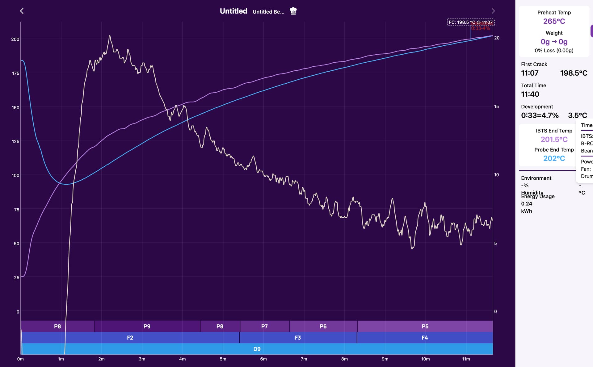

@gabyritaseek.qiAO here are three different ones from my session this morning. The original is the recipe in action without any modifications. For fun, I messed with the timing and settings in V2 and V3 to see if I could smooth out the curve. It extended total roast time by about 30 seconds. We’ll see how that affects the cup.
The original recipe I shared is with a Yirgacheffe Banko Gotiti and the cups I’ve been getting are great. Yesterday some strawberry jam came through as the cup cooled slightly. It’s not the most wild bean for this profile but I have found that using this for light roasts on Natural Ethiopians really brings out the fruit and keeps the acidity at a solid level.

@rusmas so I’ve adapted the recipe slightly this morning to see how reduced heat at the beginning of the roast affects my final cup. In terms of the roast profile itself is definitely extended the total roast time by about +1min (11:30). The curve was pretty good for the most part. I’m roasting two batches at the reduced initial heat and two at my previous profile that I shared above. I’ll let you guys know what the difference in cup tastes like later this week after it’s had some time to rest.
EDIT UPDATE: So I have no idea what to do with this data :rofl: I’ve blended the three trial roasts and will cup them later this week alongside the finished roast from the original recipe. I guess we’ll find out if there was much of a difference at all.
UPDATE: @rusmas – quick initial observations after a few days rest. The lower initial heat and extended total roast time definitely took away some of the potency and brightness in the final cup.

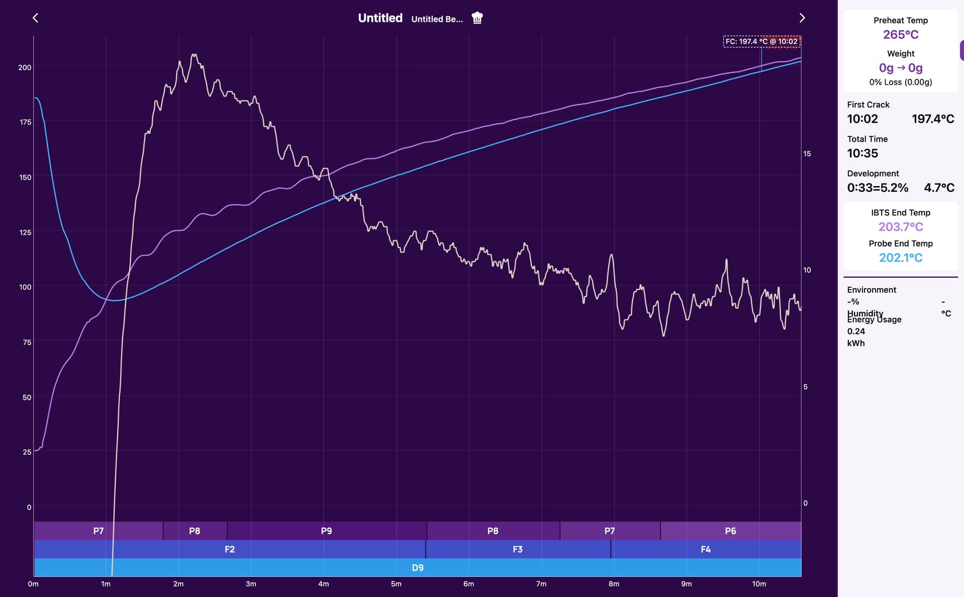

Here’s the graph and info from this morning’s roast. I pulled it a little early as I was aiming for City roast level but we’ll see how it turns out in the cup
I’m always hesitant to go too far and mute any bright fruit flavors that can be found.
How did it taste! @thewildcup Waiting with excitement over here … :smile:
:rofl: so that roast was still a little muted so I tried something else. I kept the preheat temp at 265* but started and ran the first half of the roast on P8 – never introducing P9. Very punchy flavors in the cup :beers: pulled at 10% DT and ended at City.
