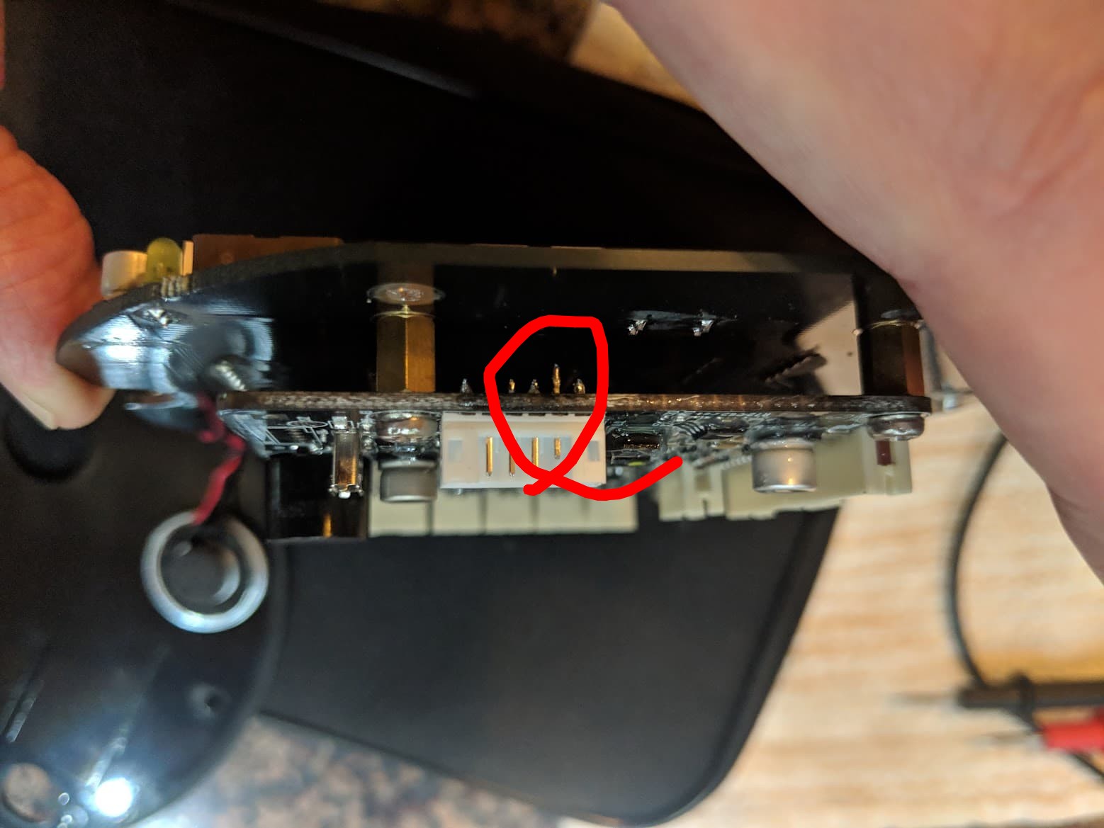

I had that same problem, and the culprit was the PCB. Take a look here, and note that the pin on the right side is pushed up:
Once I push that down and resoldered, everything was OK.

Hey, can you please explain this, may be circle mark - ‘Pin on the right side is pushed up’ Thanks
The circled pin was pushed up through the printed circuit board, so it was not making contact with the connecting wires.
