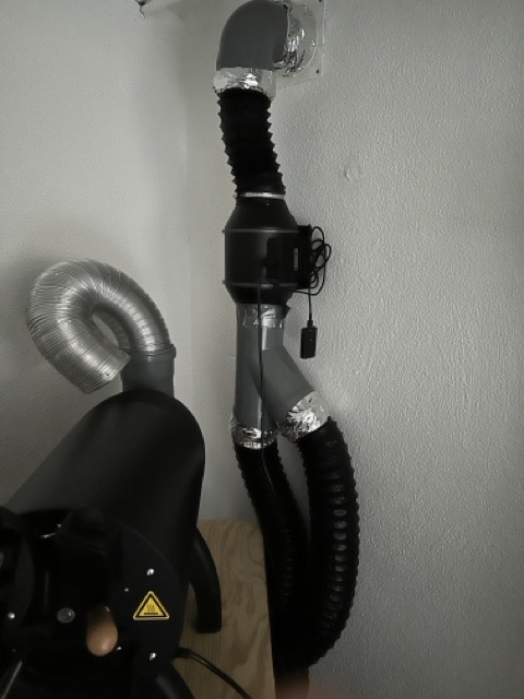

An active venting is recommended.
Yes, it can be a single duct with a Y in it. Important here is that the Y should be as close to the wall outlet as possible to prevent turbulence and backdraft when the cooling tray fan is running. Blastgates are optional but, at least in my setup, not required.
The diameter here is 100mm or about 4"
No closed system, just the duct tube above the rear exhaust - optionally and optically more pleasing, with a small hood attached to its end.
Lessons learned: Many ! Such as that my ventury system with a blowing instead of sucking fan did not work and that the easiest and most straightforward solutions work the best.
Another thing you’ll notice is that when dropping the roasted beans into the cooling tray you’ll experience quite some fumes. It can be reduced significantly if you ramp up the Bullets F setting to 12 at the very end of your roast, just two or three seconds prior to opening the flap. And of cause the cooling tray fan must be running.
There are some great examples here in the forum regarding venting options with Cloudline fans.
Below is my solution. It is still ugly but works very well.
