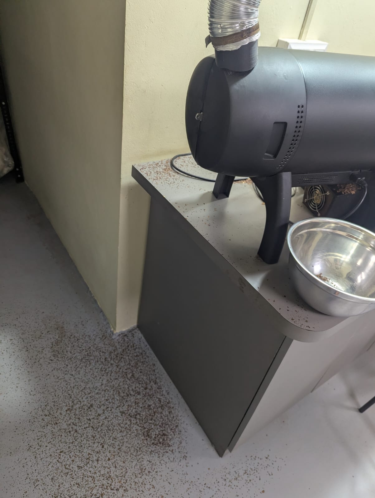

I’ve been using the Aillio Bullet for about three years now, and recently I’ve noticed an issue with the chaff. It’s not getting collected properly in the chaff collector and is instead spilling outside during roasting.

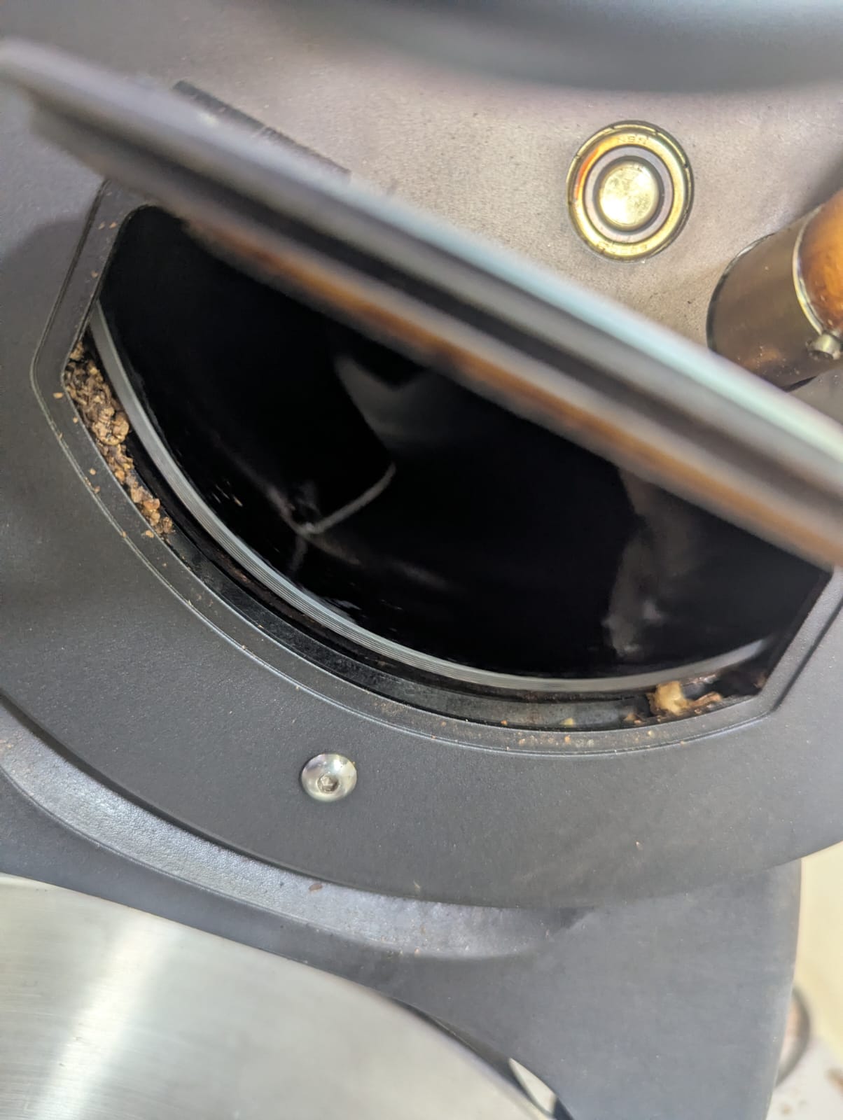

I also see that some chaff is getting stuck near the drum edge (in the gap area) and is burning there.

Chaff is not getting collected in the chaff collector. Instead of getting collected in the chaff collector it is falling on the floor

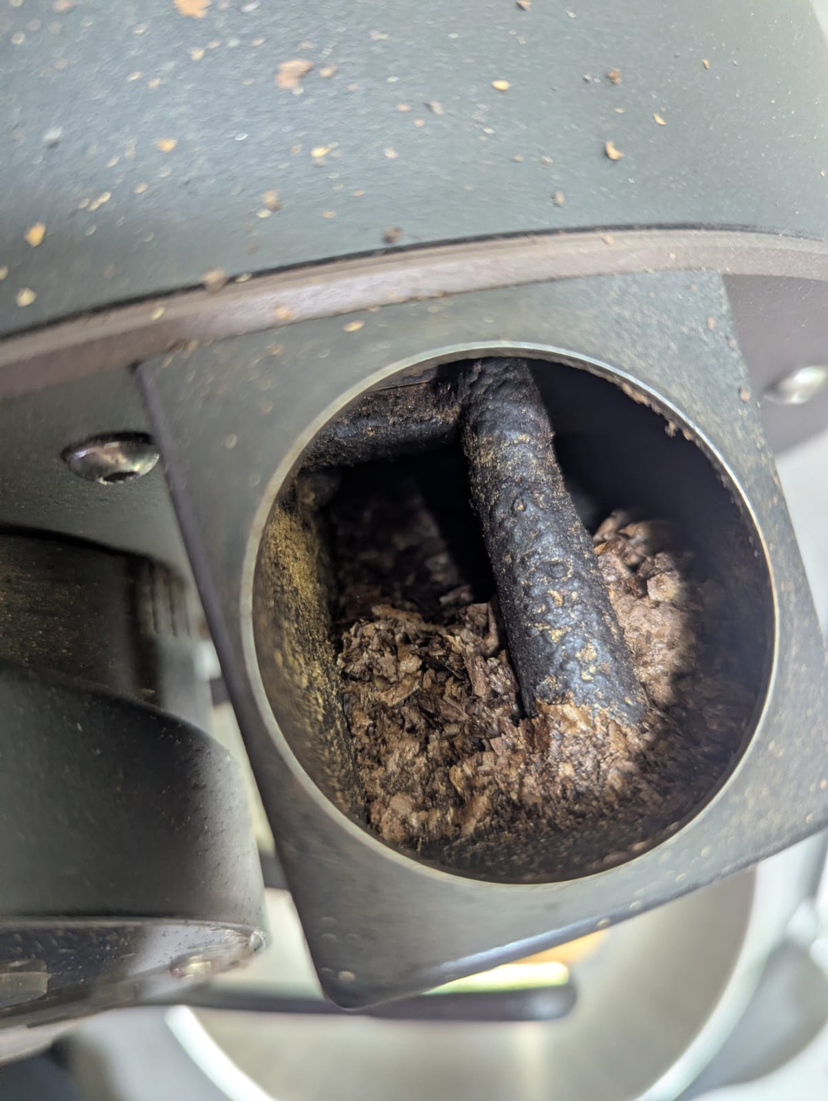

Sharing the images for reference
I would speculate that the exhaust transfer tube from front charging port (1st image above) to rear chaff collector is clogged or at least restricted. It needs to be vacuumed/brushed out every time you do regular maintenance. There may be some beans in that tube which are helping to collect chaff.

On my 6+ yearold old Bullet there seems to be gradual accumulation of roast debris which eventually restricts the exhaust flow. Initially I paid little attention to the exhaust transfer tube as it was initially always empty. Then about a year+ into use, roast profiles became… ‘different’. I stumbled on the transfer tube as my culprit: beans & chaff had been accumulating. So that came to be a check-point for routine maintenance. Initially it required some determined cleaning, but once it was cleaned out it became a simple quick pass with the vacuum cleaner to maintain it.

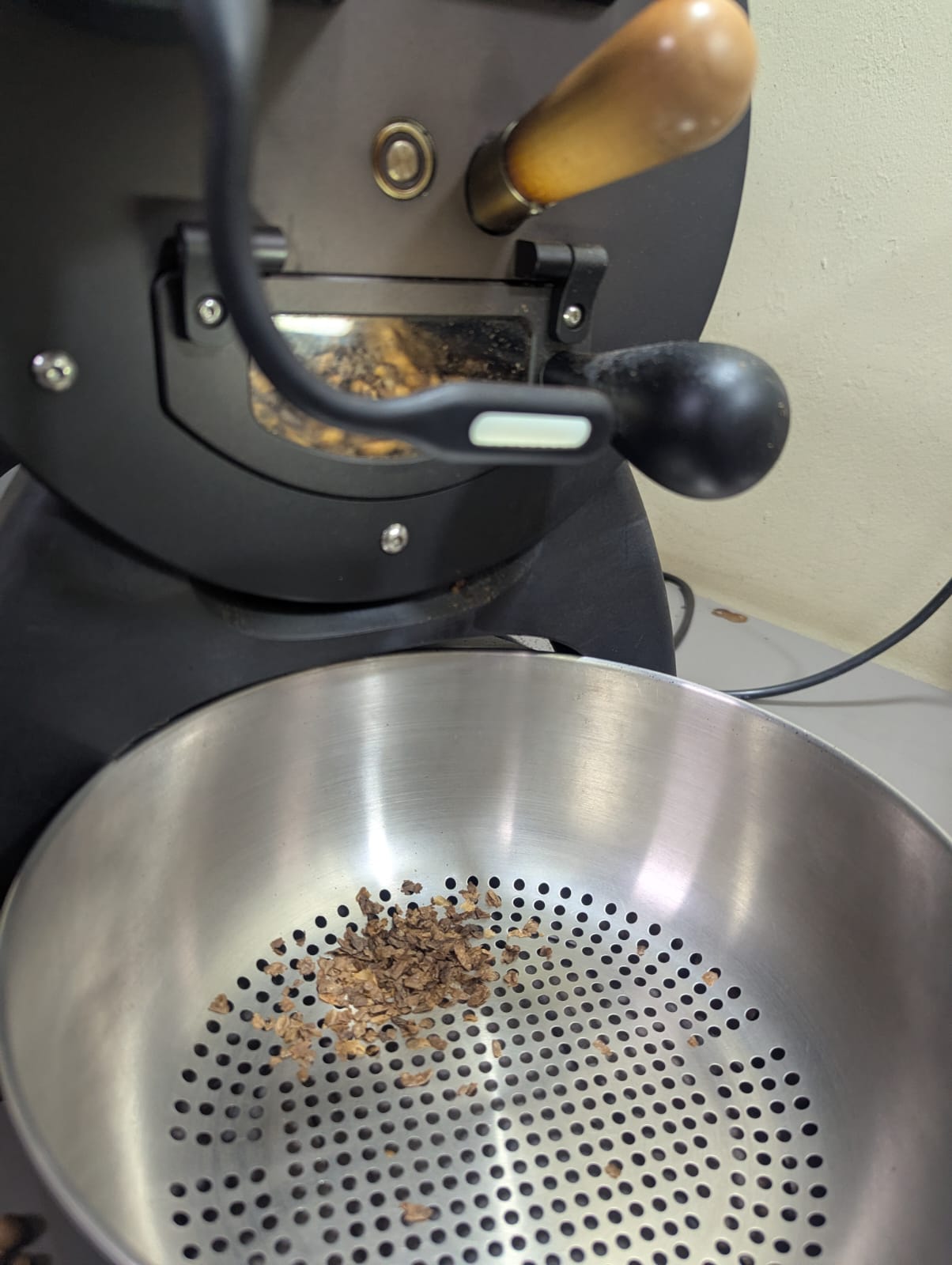

I can’t tell from your pictures if your chaff screen (that screen basket—forgot what it is called). Like already suggested, make sure it is not clogged with oily deposits. Give it a good cleaning with with descaling agent.
Also check to make sure your impeller fan is clean and spinning freely. I’ve had an issue that the little handle of my chaff screen was blocking the impeller fan. Once in a while, I remove the fan completely and give the whole area a good cleaning.
The chaff you show coming out of the front is normal. I believe the little crack is designed that way. For the few pieces that stuck in between the drum, I usually just brush them out. Some beans have a lot more chaff than others.
I worry about the look of your chute. From the picture, the chaff looks oily and baked on. Get yourself a nice long brush and make it part of your cleaning routine to brush off any residue. Reach into the exhaust channel to check for any obstructions.
Also consider checking your exhaust system to make sure there aren’t any obstructions or accumulated chaff inside.
