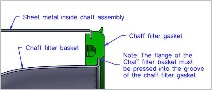

The filter canister that is part of the chaff collector was sliding out and making a racket during the late stage of a roast. I know it has been discussed. But what I was missing in what I saw posted about this is that this filter fits into a lip in the rubber casement !!. Is this written up ? I have seen " make sure the metal handle is not sticking out but making sure the filter is held or sealed into this rubber lip never caught my attention if mentioned somewhere

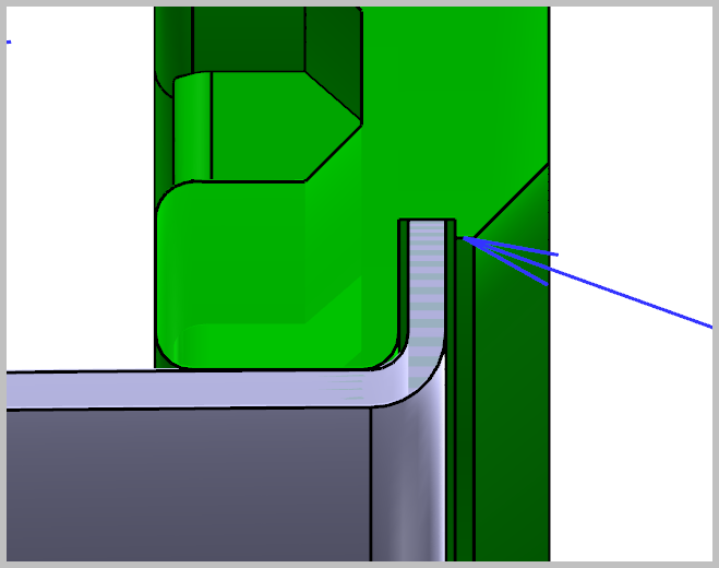

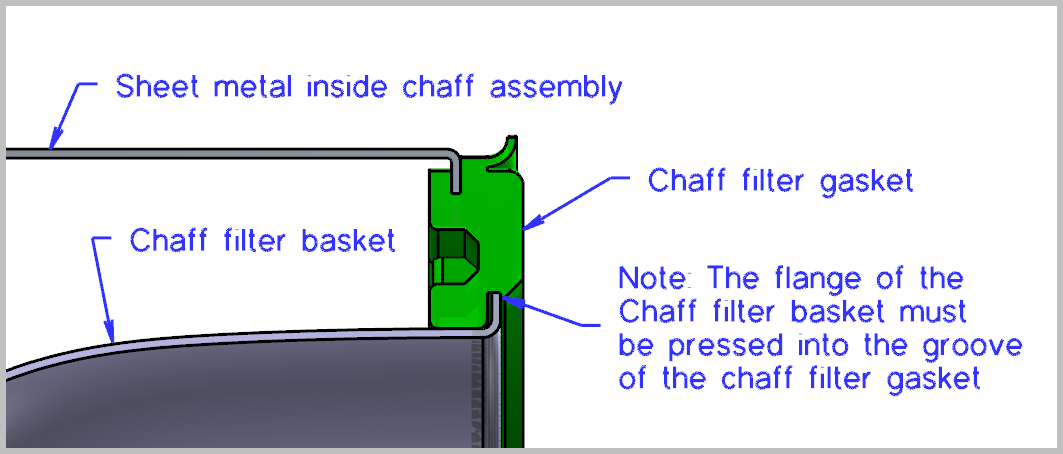

There was a thread that had a couple of illustrations of the rubber gasket and the groove that the basket needs to fit in. I will re-post them here.
Yes since my original post on this subject I have learned that the chaff basket “pops” into that lip in the rubber.
