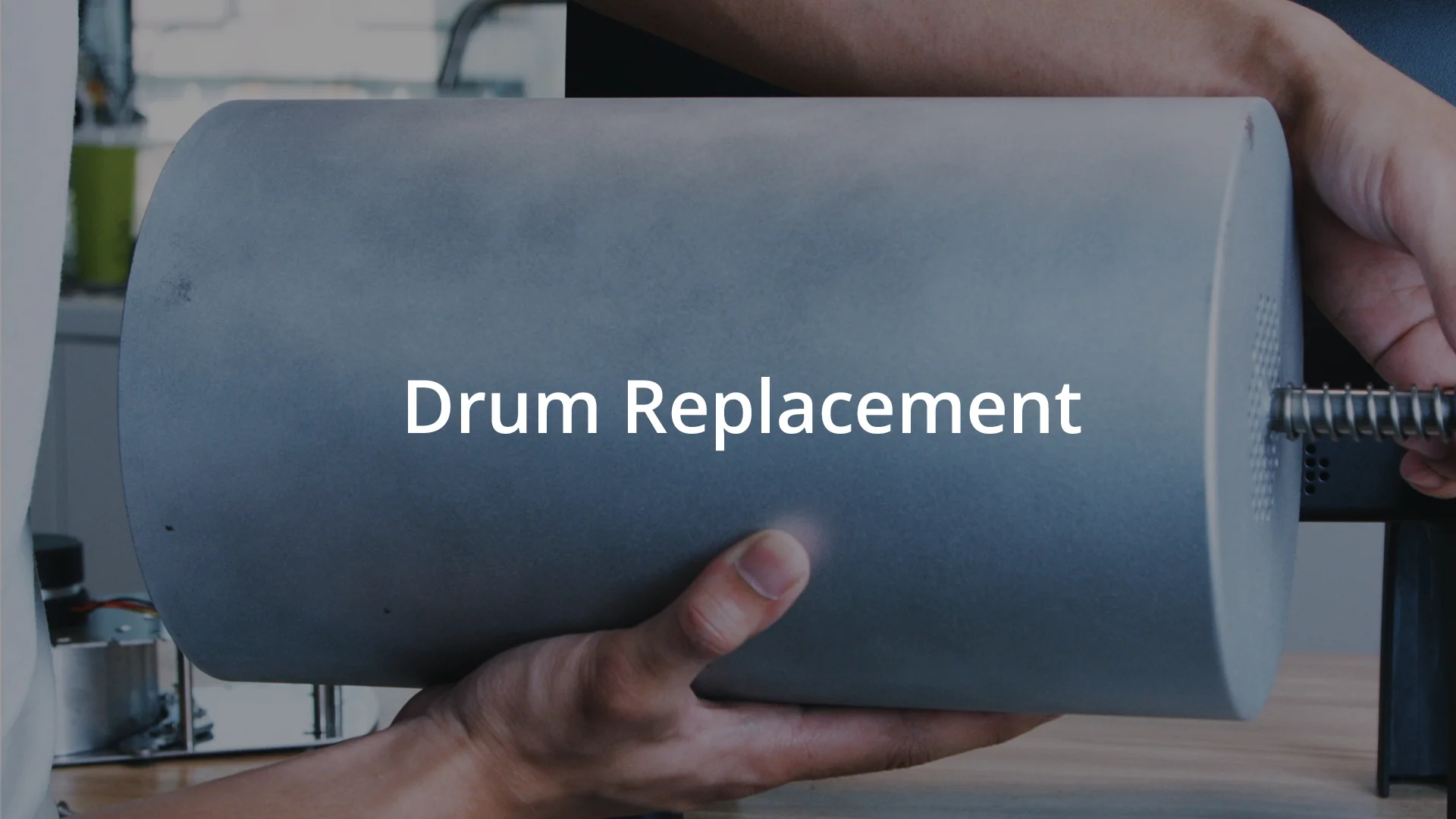

Sounds like there might be some beans inside of the Drum and had caused the Drum to stop, though it rarely happens on a new Bullet. Please try removing the Drum and see if there’s anything between the Drum and the Mica Tube. Here’s how:
