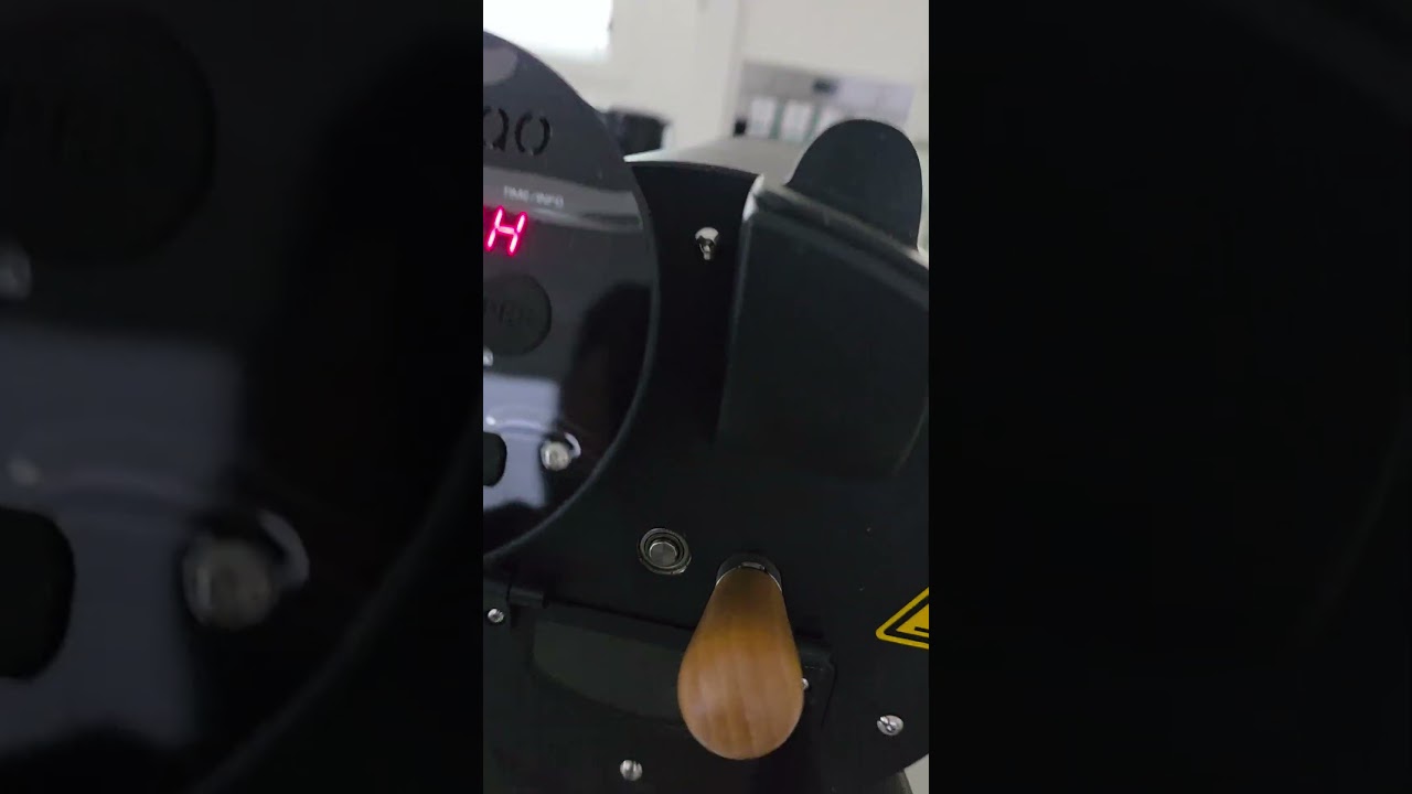

I’m having this problem now.
I’ve tried adding shims and realigning the drum and I’m still getting the same issue.
Any tips?
The sound seems to be coming from the friction between the door handle screw and the drum. The screw should not be sticking out, not even a little. It really sounds like that. Does it make that sound without the handle? If not, check if there’s a bean that wondered underneath the drum.
