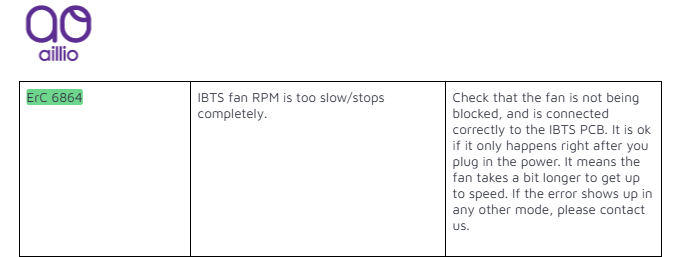

The purpose of this post is to try to get some guidance on my next best steps. I know the Aillio site lists these potential causes below. I am wondering where to start, given my roaster’s newness and relatively little use. I can start going through these step by step, but it’s a lot to do, so I am hoping that the experts here could at least reasonably guess at the most likely culprit and best place to start.
  • The IBTS Cable has obstructed the IBTS Fan.
  • The IBTS Cable/IBTS Fan Cable is having a connection issue.
  • The IBTS Module is overheating.
  • The IBTS Fan is reaching its end of life.
The roaster stays in my garage, which is well insulated, relatively dust-free, and doesn’t get either too hot or too cold. I keep it on a rolling worktable, and it never gets jostled/bumped around at all. I faithfully clean the chaff collector and check for drum obstruction before every roast, and the chaff screen was removed and cleaned about 3-4 roasts ago. I have never had the cover or face plate off. My most recent roast was 8-10 days ago, with no issues at all.

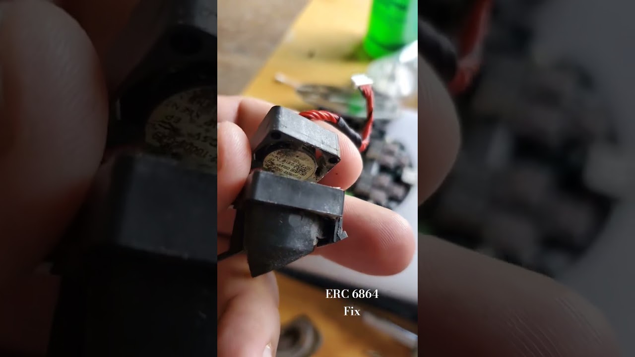

Hi @markwallac.aHd1
Based on the community information, for ErC 6864 you can try checking and cleaning the IBTS fan, and checking the cable connection.
You can refer to these guides:
These videos may also help:
Hope this helps.
