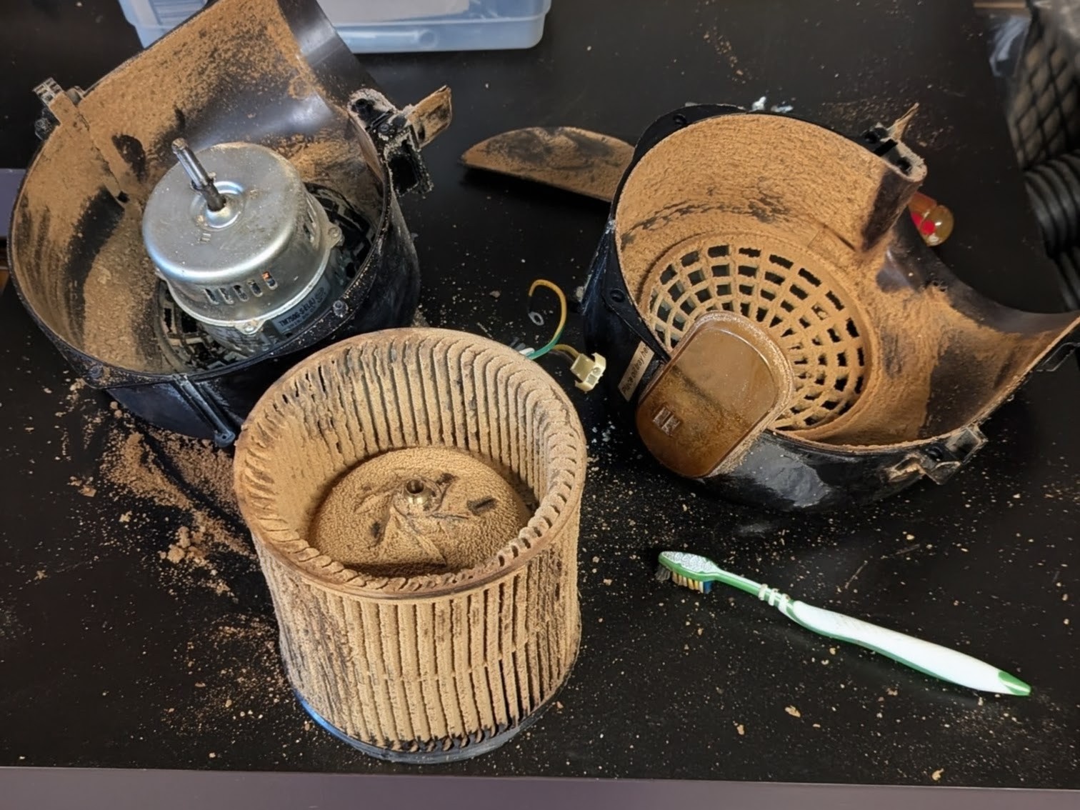

My overhead exhaust hood starting making a serious noise at high speeds after 390 medium to light roasts, I decided to take apart the encased blower unit and discovered a complete caking of coffee dust clogging the air flow of the blower blades. After a complete cleaning it is back to working properly. The exhaust uses baffle type filters which evidently don’t collect all the particles flowing out of the Bullet during roasting. I will have to add this cleaning task to my maintenance schedule.

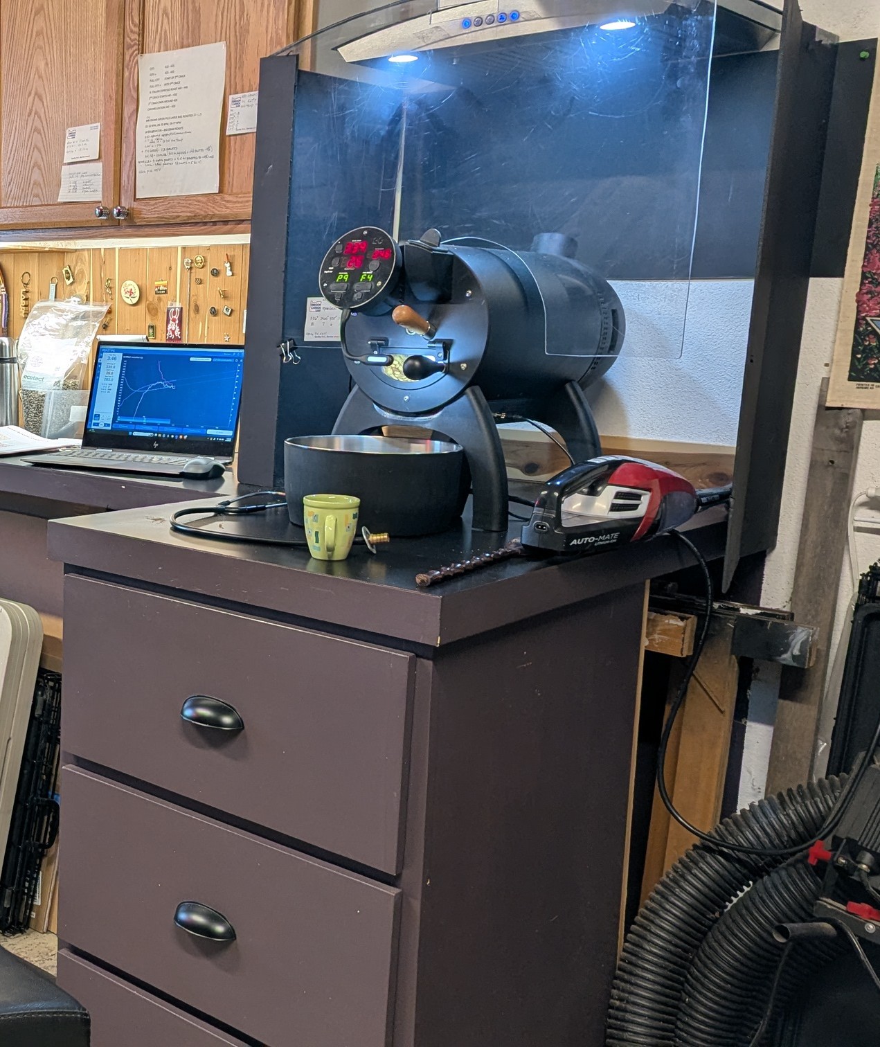

I installed sides, see link, out of black 1/4" foam core with a hinge on the right side for accessing the chaffe collector and a 1/8" acrylic front cut to fit the hood and the Bullet. It completely eliminated any smoke spill over from the hood.
