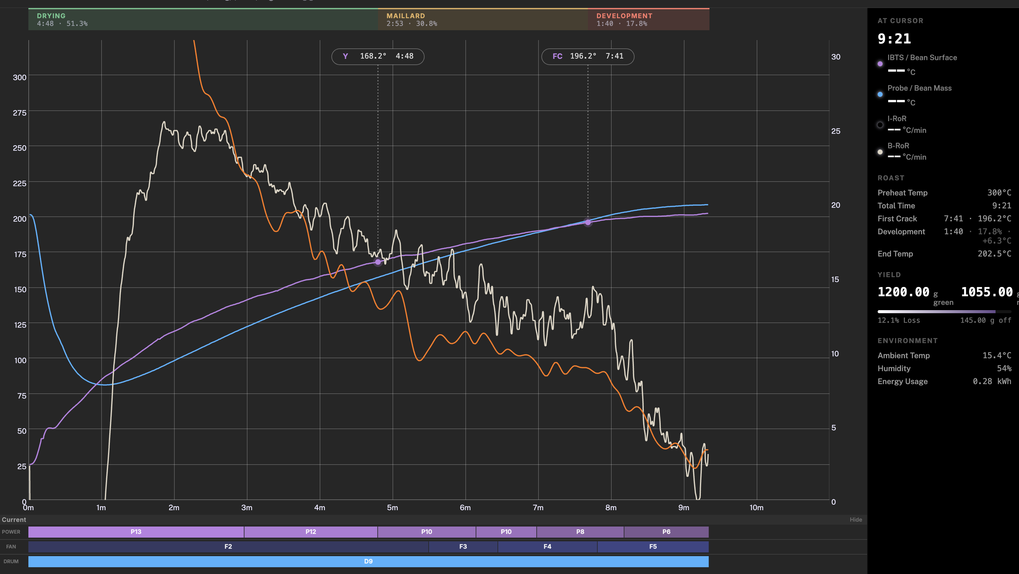

Here’s a typical example roast (this is a washed Peru):

As for roasting, you’ve pretty much nailed it. You could play with balancing out the drying and the Maillard, but that won’t really make too much difference. Try and see. Also, the graph here looks more like something close to a medium roast. I drop many of my beans during FC, with max development at around 10%. But I do like experimenting and changing profiles constantly. You’ll often hear roasters talking about “espresso roast”, which is to say “we roast darker”. There’s no such thing as a specific espresso roast. The grinder is what determines the type of preparation. Roasting darker usually happens in commercial environments where people need consistency, something like fast food, to be able to pull many shots that are all the same. You don’t need to do that. You may concentrate on taste alone. Forget the channeling and pretty shots, ratios, etc. Look for taste.
