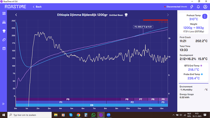

So I roasted about 10kg’s on the bullet till now. It is a v1 r2 with the IBTS serial no 1409 so quite early. I started with smaller batches like 600 gr and went up to 1.2kg.
I got some replies back from the guy I bought the roaster from, he says my curves are too flat.
Can someone explain me a bit about the theory? I tried to read and watch some movies but it is not getting clear enough to me.
So what happens if FC will be earlier or later? What happens if I slow down after FC or speed up the roast?

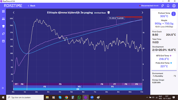

What do you guys think about my graphs?

We would suggest that you avoid charging any batch size larger than 1kg. Charging up to 1.2kg may result in inaccuracy, and more importantly, wear down the parts, such as the IBTS Lens and Chaff Filter, way faster than they should.

Thanks for the info. The recipes for 1.2 kg you saw on Roast.World might be the ones for the R2 Pro, as they can roast up to 1.2 kg.
While it’s possible to roast up to 1.2 kg on the R1V2, it wears out the parts more often than usual, so you will have to keep up with the maintenance to avoid damaging the electronics, which is why we generally don’t recommend doing so.
Based on the provided roasts, the Bullet should be working fine at the moment. We’re not sure what “too flat” means, but the crossover between the IBTS Temp and Bean Temp seems to be in the correct range, and the IBTS First Crack Temp is within tolerance.
For your information, you should anticipate the first crack at IBTS Temp 195 °C - 205 °C. While the crossover varies in batch sizes, it should not be below 185 °C.

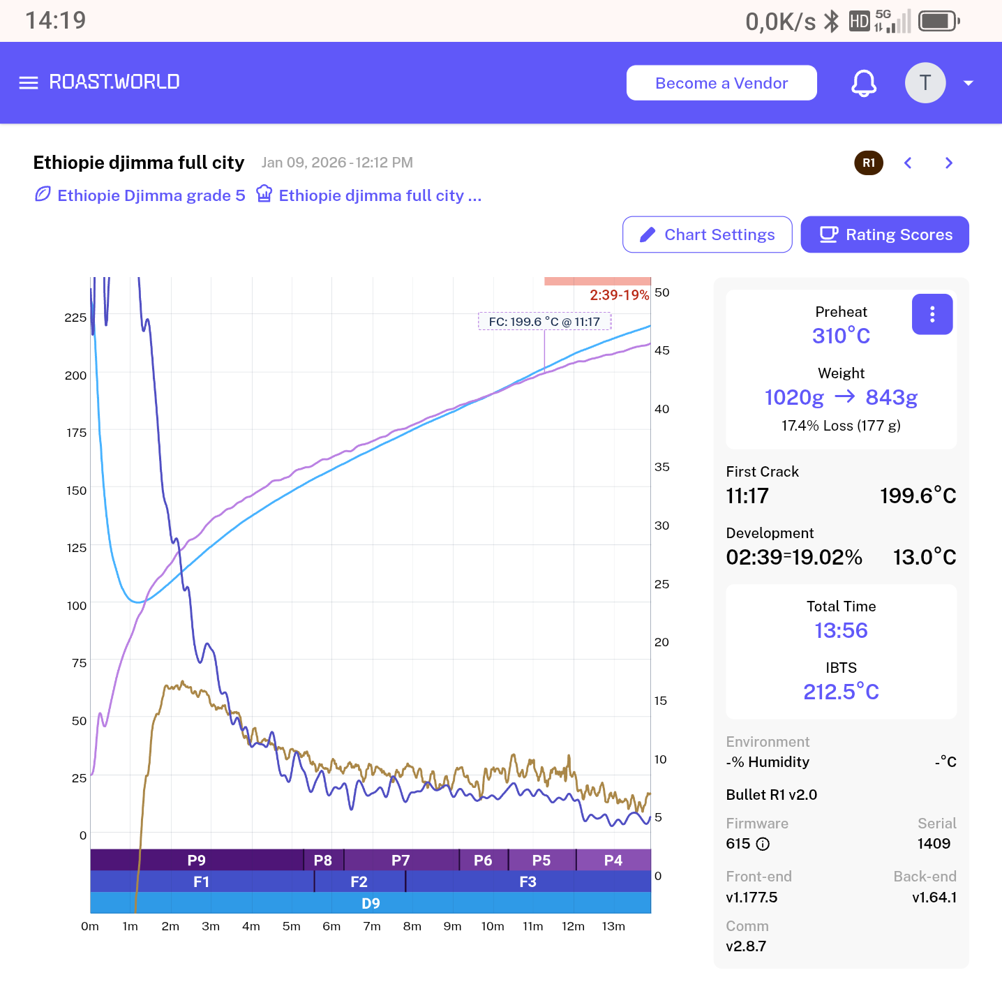

I am I still in the oke ballpark close to 14 minutes?
Can you review my roasts?
I’m curious, did you give the roaster a good clean recently especially the lens for the IBTS and the bean temp prob? While you reached FC around the temp that made sense for your batch size and you used a high charge temp, it is a bit weird that it took you 11 mins to get to FC. On my 1 kg batches with same charge temp as you, I reach FC at between the 9 and 9.5 mins mark.

Yea a low ambient temp like that will affect your roast times even with a long pre-heating time (e.g. 30 mins) and if your beans are also equally “cold” it will drop the temp in the drum drastically even with the max pre-heat time you have. That drop explains what I see in your graph with the sharp drop.
