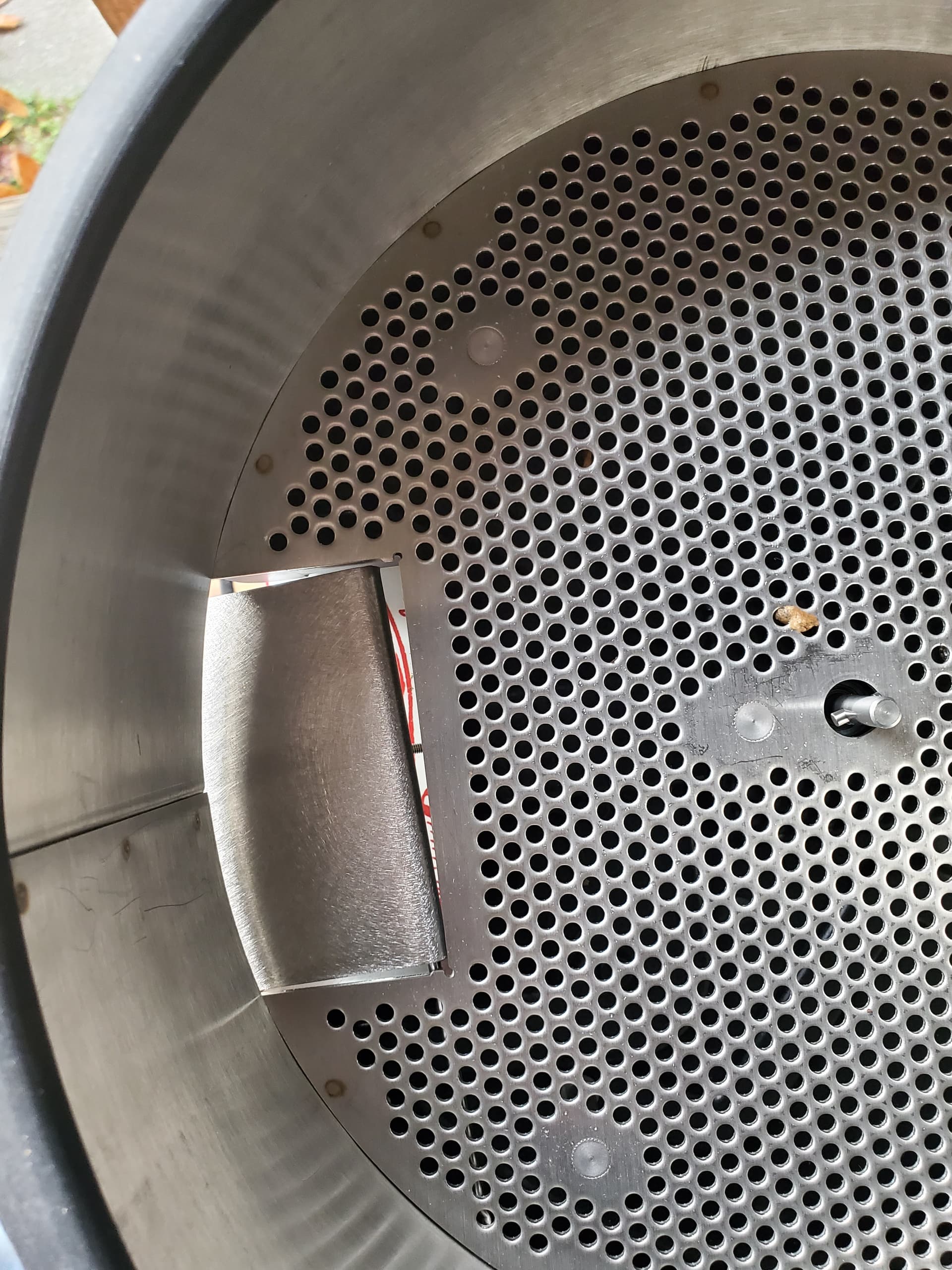

On my unit the bean drop door has a rather sloppy fit and doesn’t raise up enough to seal off the bean drop hole which could easily result in beans spilling out onto the floor. Fortunately I can push it up with my finger and so far it stays put until I lower the handle. I am going to examine the hinge system on the door and hopefully find a way to snug it up, but if that fails I will look at some other method to get it to stay up. I’m a bit leery of just trusting it to stay up when I’m not really sure that it will. This is something that should have been fixed before sending these out. It’s not a deal killer, but it would have made me pretty mad if I hadn’t noticed it before doing a roast and spilling a bunch of beans.

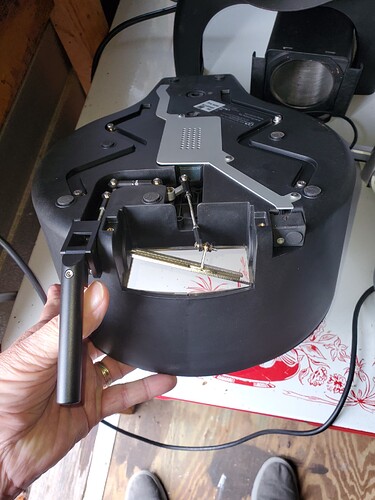

After examining my cooling tray rather thoroughly I can see where the problem is. The flap that opens and closes to dump the beans has a hinge pin running through it. The pin is securely attached to the tray at one end, but is not even protruding from the flap at the other end.
If you need additional pictures I will be glad to snap them, but I think these pretty well show the problem.
Seems like some part is missing.
If you contact aillio support they will send you the spare parts needed.
I don’t know how this could happen, but I will follow up with production to let them know.
Aillio support was quick to respond and they even put up a video showing step-by-step how to fix the pin issue. My flap is now working as it should! Great service…many thanks!!!
