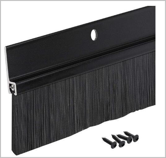

This is looking pretty good. if you are still getting some smoke that is trying to make your life “uncomfortable”, You could cobble together a brush sweep
made with duct tape and some creative cuts with scissors.
I would want a little cool air flow to enter the exhaust and not a solid seal that would pull the heated air out of the Bullet. So: minimal gap, but not sealed.

So the new setup worked MUCH better than the first attempt. No chaff escaped the garage or the roof vent which was a success. However, there was still some chaff and smoke seepage during the roast itself. I’m exploring your brush sweep idea as well as a couple of others.
I’m wondering if part of the reason there doesn’t seem to be adequate suction from the Vivosun in this configuration is because it’s also drawing from the ductwork leading down to the cooling tray. I was considering installing an adjustable baffle in just below the roaster on the 4" wye and keep it closed during the roast but open during cooling phase. Another option, similar to the brush sweep, is figure out a better “hood” to sit closer to the Bullet exhaust port to catch the loose ends.
