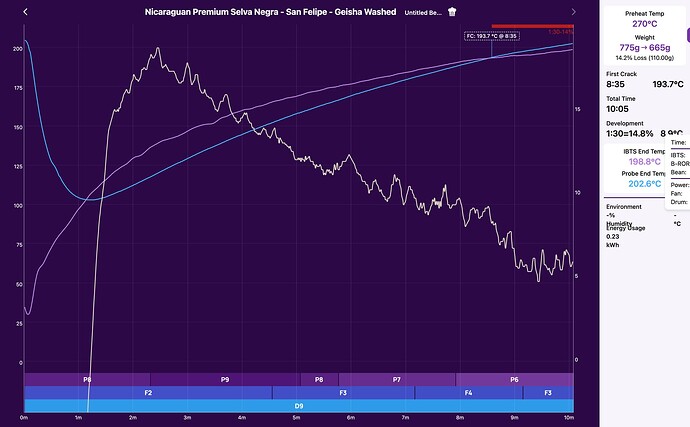

Roasting this Nicaraguan Geisha and it’s FC comes soooooo early. I know it’s not misreadings by the Bullet because the IBTS and BT Probe track really nicely and there’s no significant variation to cause concerns. FC was ROLLING around 195C but started around 192/193C. I’ve never had a bean hit FC this early before. Just curious to see if anyone else has? Beautiful roast curve too :partying_face:

I wanted to say it’s probably normal for highly processed Geshas, but then I saw that yours is washed. So I checked your other roasts, and between all the beans cracking around 195-196, adding that the crossover between BT and IBTS happens far too soon, my money is on a dirty IBTS.
Good shout. I’ll clean it this morning and see how that affects roast logging
Forgot to say that you’ll need to adapt a great deal. It did seem odd that your PH is just at 270°C for a 775g batch. Preheating to that temperature, you should be around 187°C on BT at the start of the roast, but you’re starting at 205°C. That would be more of a 285-290°C PH. So, keep in mind that you’ll need to up the PH and adjust your roasting routine once the sensor is clean. Why do it then? Well, because it’s never a good thing when something as hot as that goes 10-15°C over set temperature without you knowing it. On max PH, which I think is 310°C, the machine would probably give an error and go into cooling mode, because you’d overshoot the set temperature.

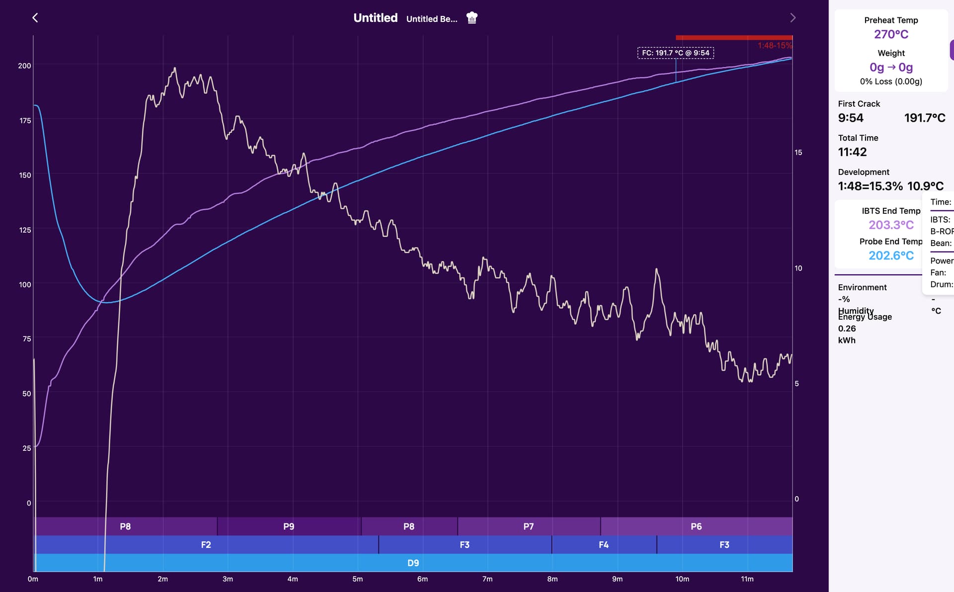

First time roasting this geisha up after cleaning the IBTS probe and I’m still getting a very early first crack. I mean audible rolling around 196*C

Well, 196 is perfectly normal, especially if it’s a big bean gesha. I really don’t know why that is, but it simply is. Mine also cracks around that temperature, but it’s anaerobic honey. I thought it might be the processing, but yours is washed. There are other beans that crack earlier, but it’s a non-issue, just the way the bean is. I wish I knew the exact reason. By the way, why is the screenshot here so different from what is seen in Roast World? There is no crossover over there and the FC is at 196°C.
There isn’t any crossover on the screenshot. It’s close but not crossed and for some reason it only recorded the BT reading of 191.7C not the IBTS reading at FC that was 196.3C
Yeah, you’re right, who knows what I saw. In RoasTime settings/Roast config is your “primary measure” set to IBTS?
It wasn’t until now! Thanks for pointing that out so I could change it.
