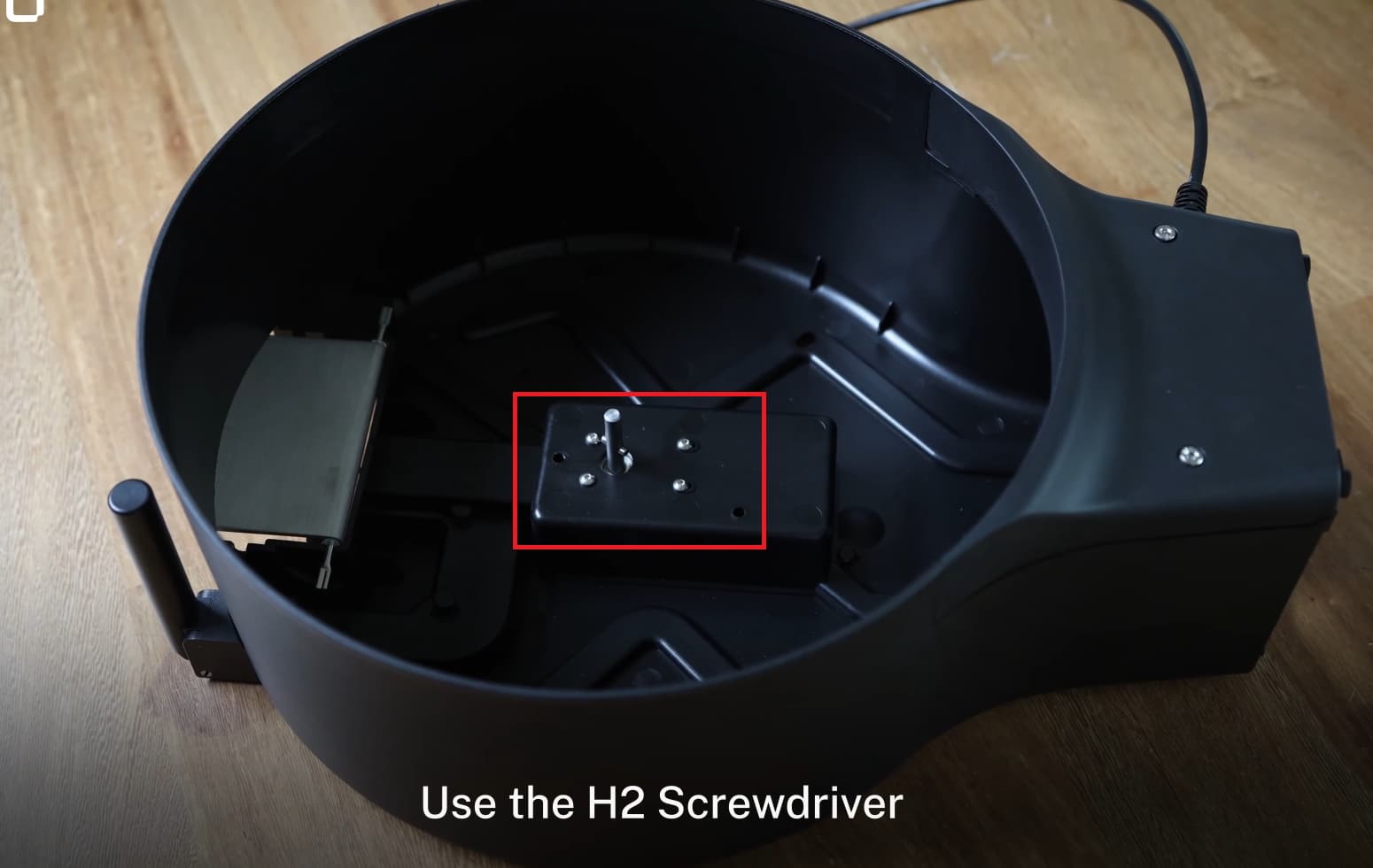

Thanks for sharing the video. From what you described, it does sound like the stirrer motor may be loose.
Please try checking it using the steps in this video:
Pro Cooling Tray - Stirring Motor Replacement

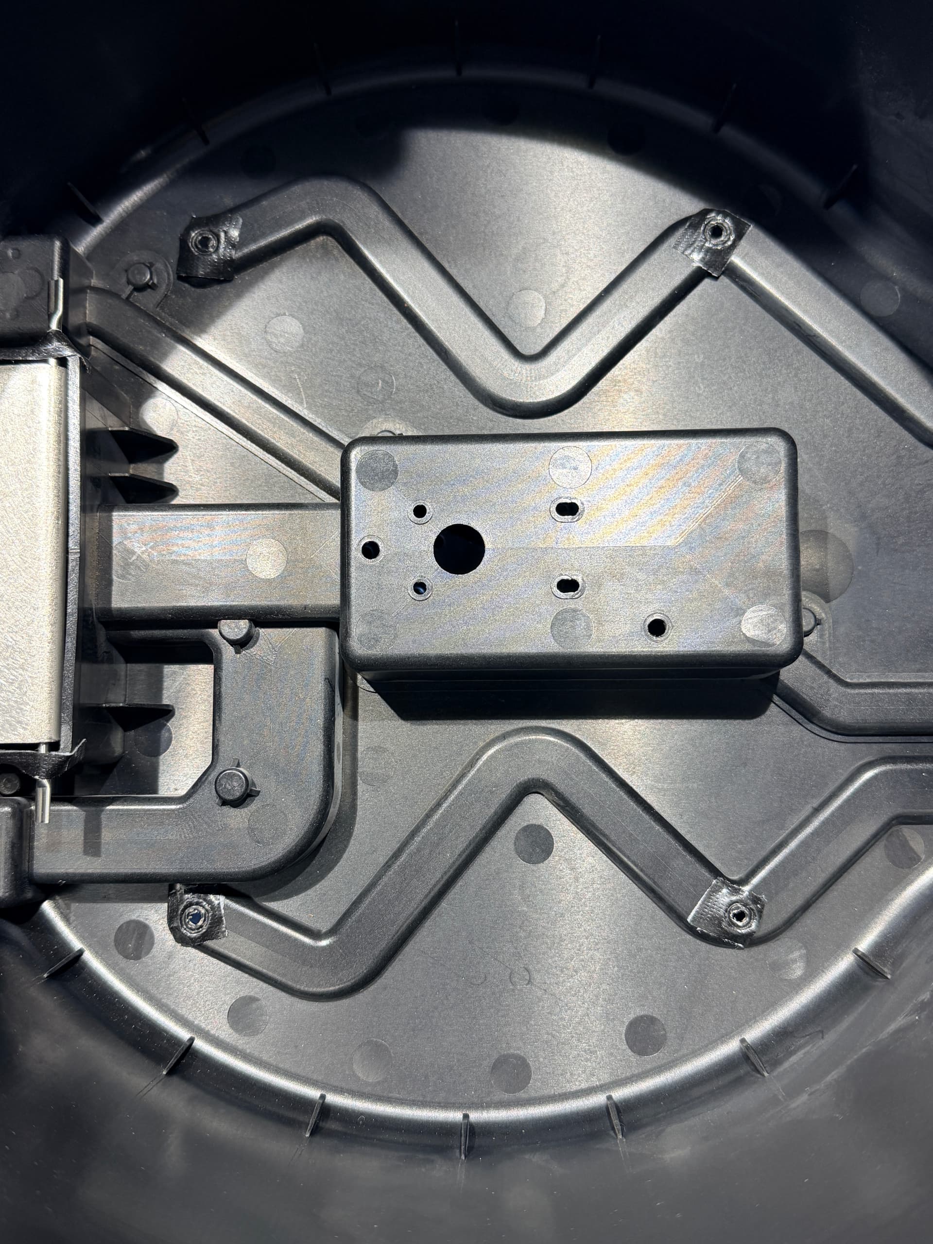

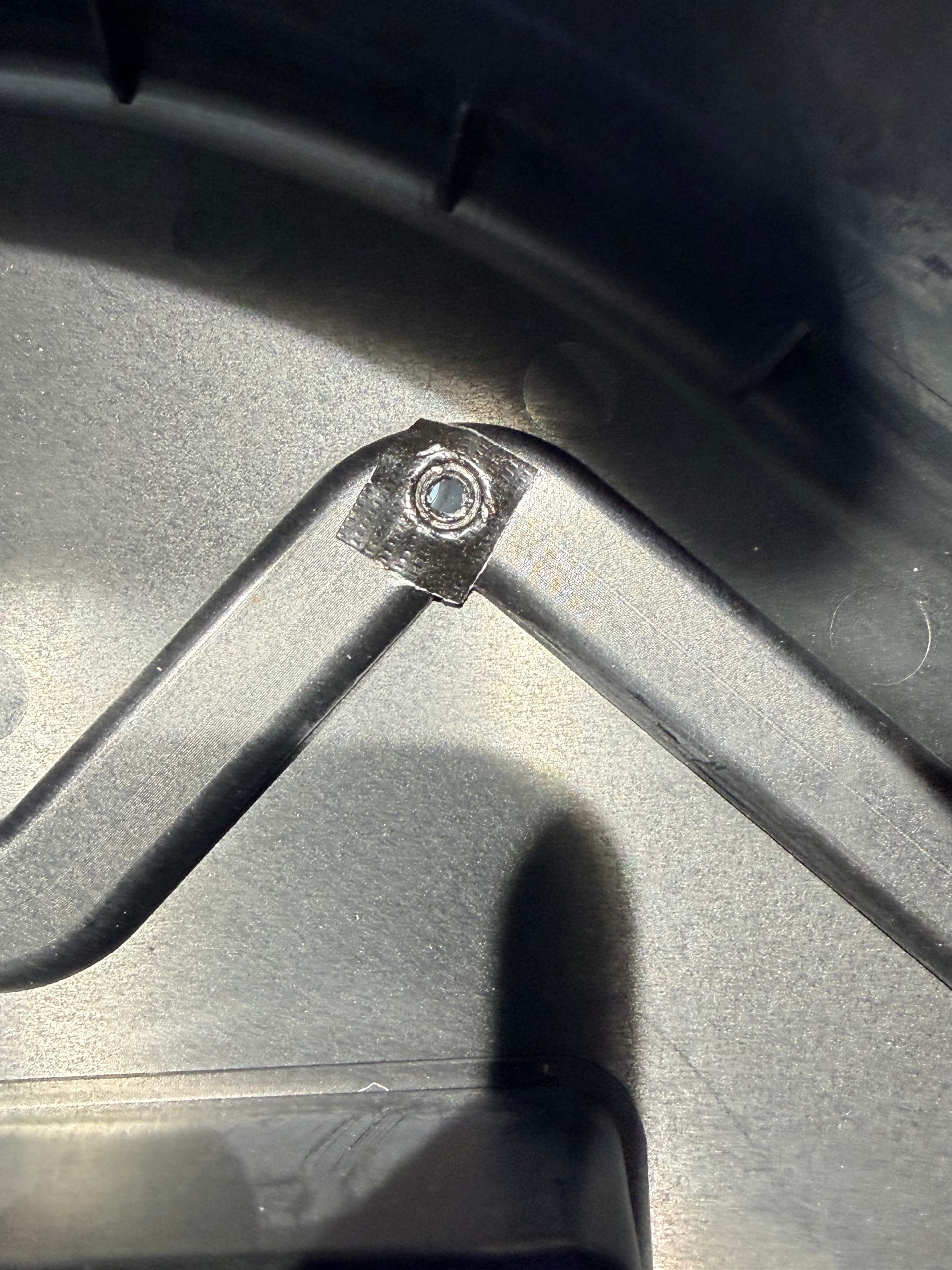

FYI: I used some black ducktape to keep the washers in place.
Did the same to keep the door pin in place

Hiya! Thanks for the pics but is not that. The pin is ok, the issue is the stirrer. Is very loose and this allows beans enter under and make it wobble and noisy

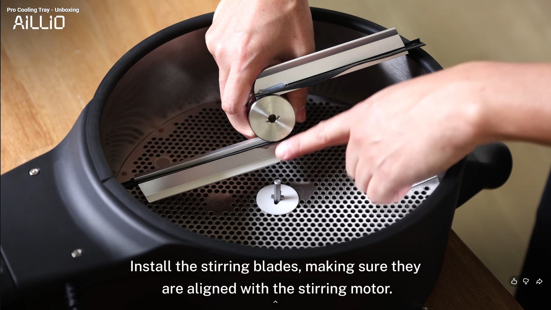

Hi @matiascanzani.I9fA
Thanks for the update. It would be very helpful if you could share a video or photo without beans inside the cooling tray, as this will make it easier for us to investigate the issue.
You can remove the stirring blade and press the cooling tray button to run the stirrer motor by itself.
Possible causes could be:
  1. The stirring blade is misaligned with the motor shaft
  2. The rubber insert on the stirring blade is misaligned or not seated properly
  3. The stirrer motor core itself is loose
Pro Cooling Tray - Unboxing
