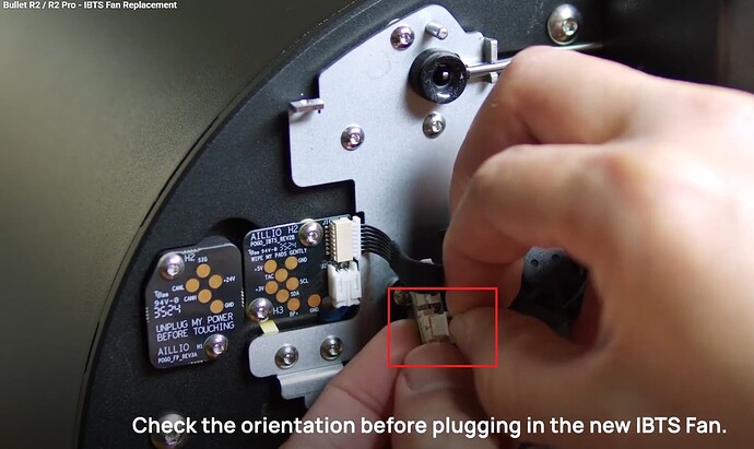

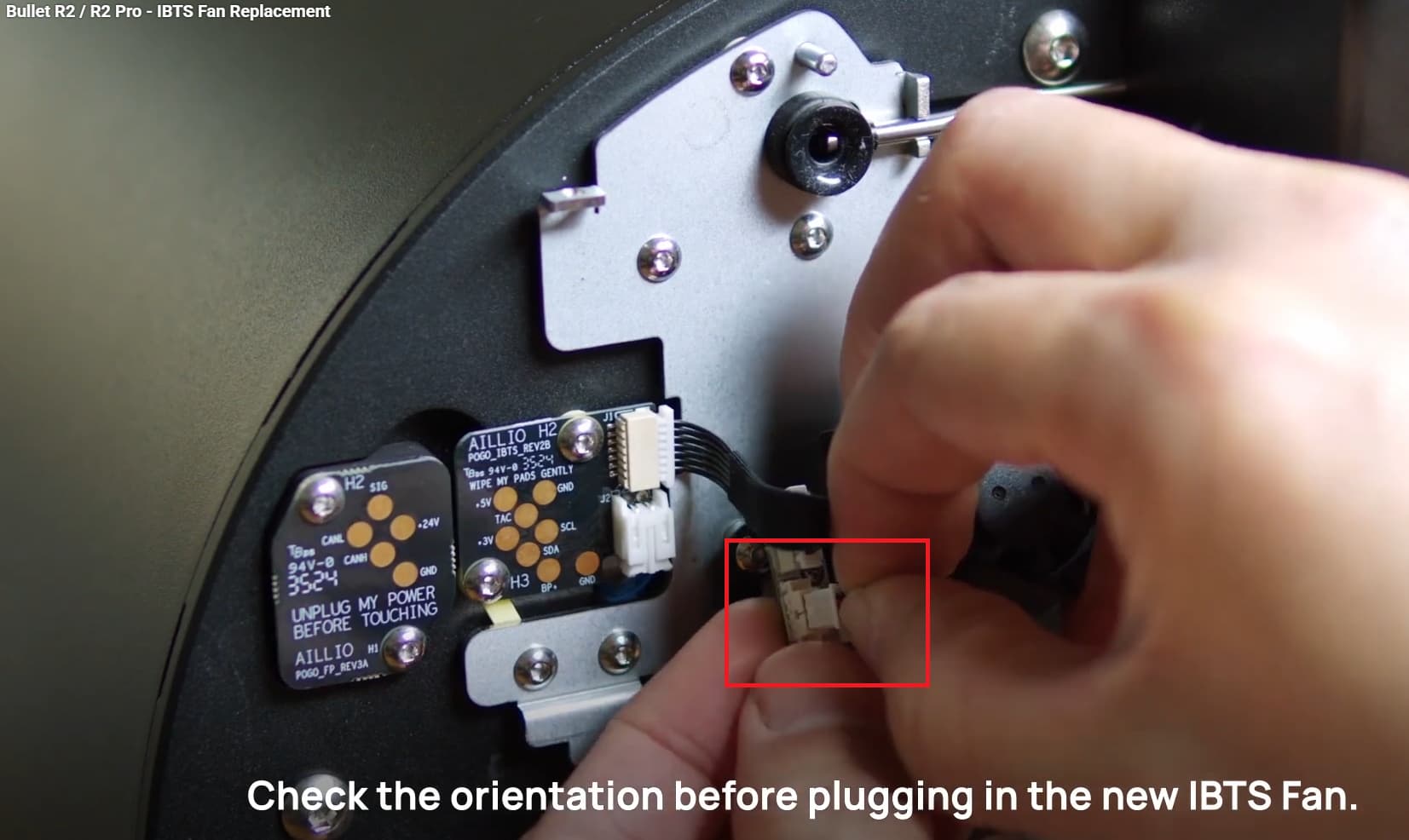

You can recheck the IBTS fan connector, as it might be loose or not fully connected after the cleaning.
If the connector is not properly seated, the roaster may detect the fan as stalled, even though the sensor itself was not changed.
For reference, you may follow this guide:
Bullet R2 / R2 Pro - IBTS Fan Replacement
