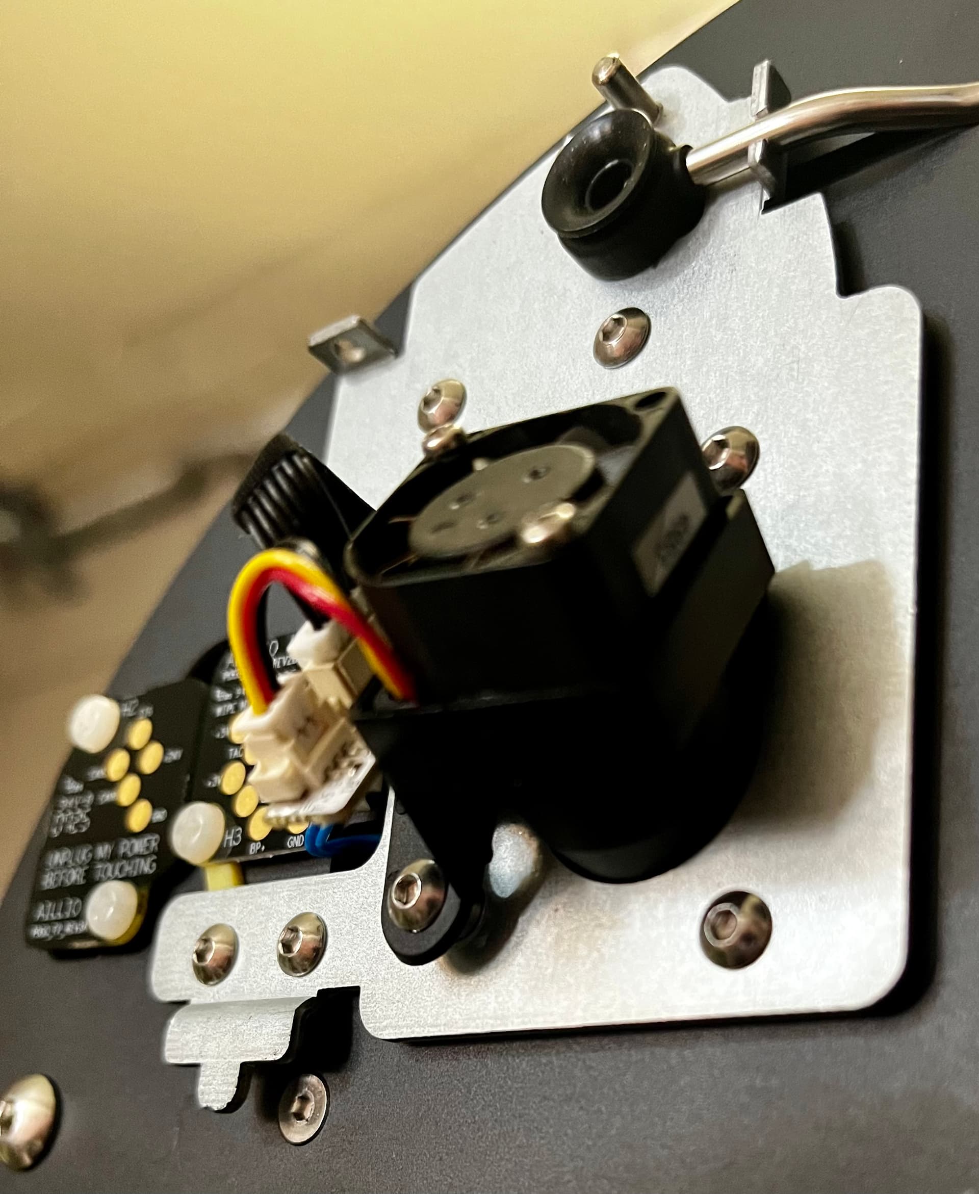

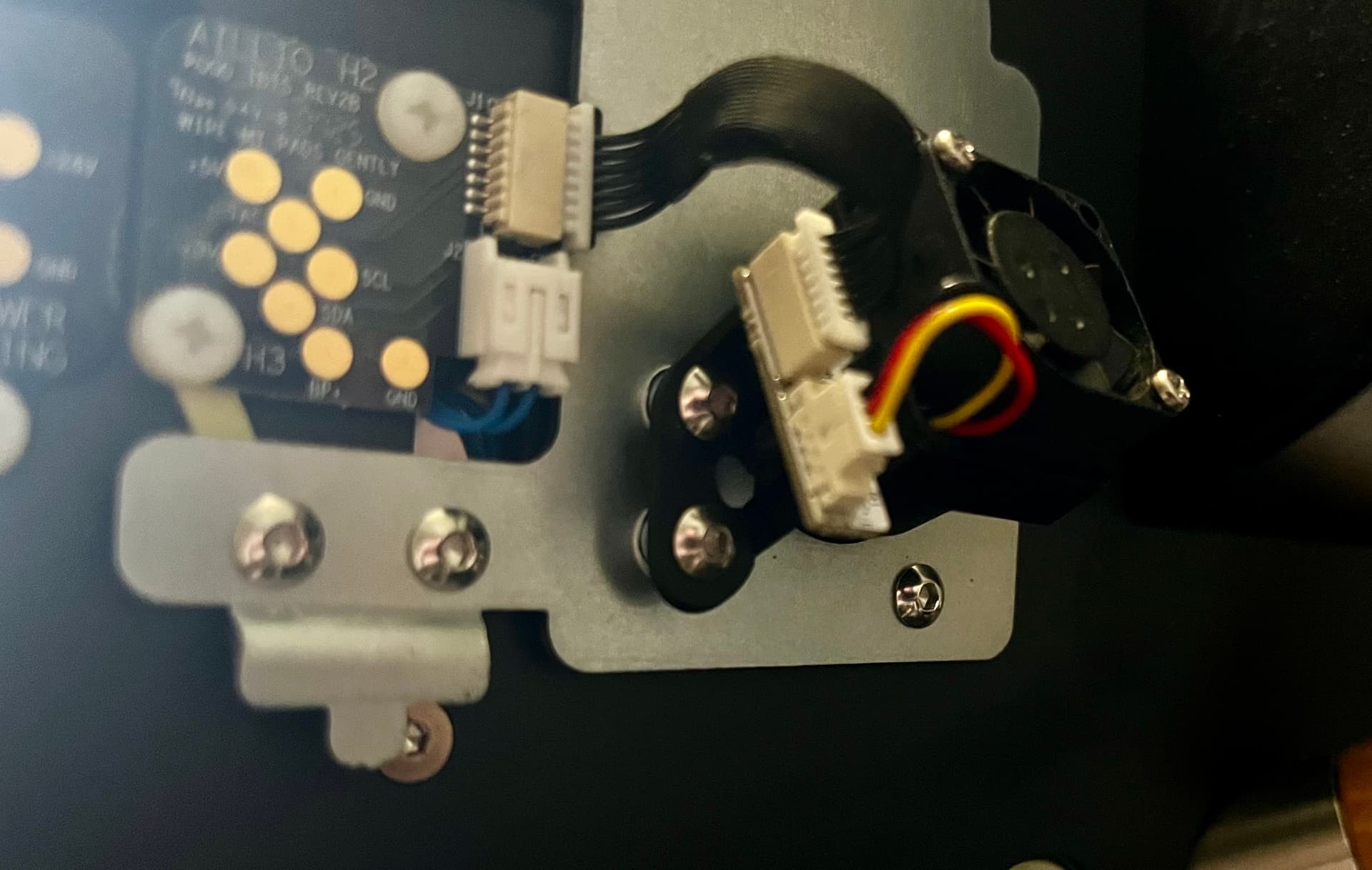

Hi @ant.roasts
Could you please recheck that the IBTS bracket is installed properly?
If the bracket is not seated correctly, it may affect the temperature measurement and cause noise in the IBTS curve/RoR.
Thank you.

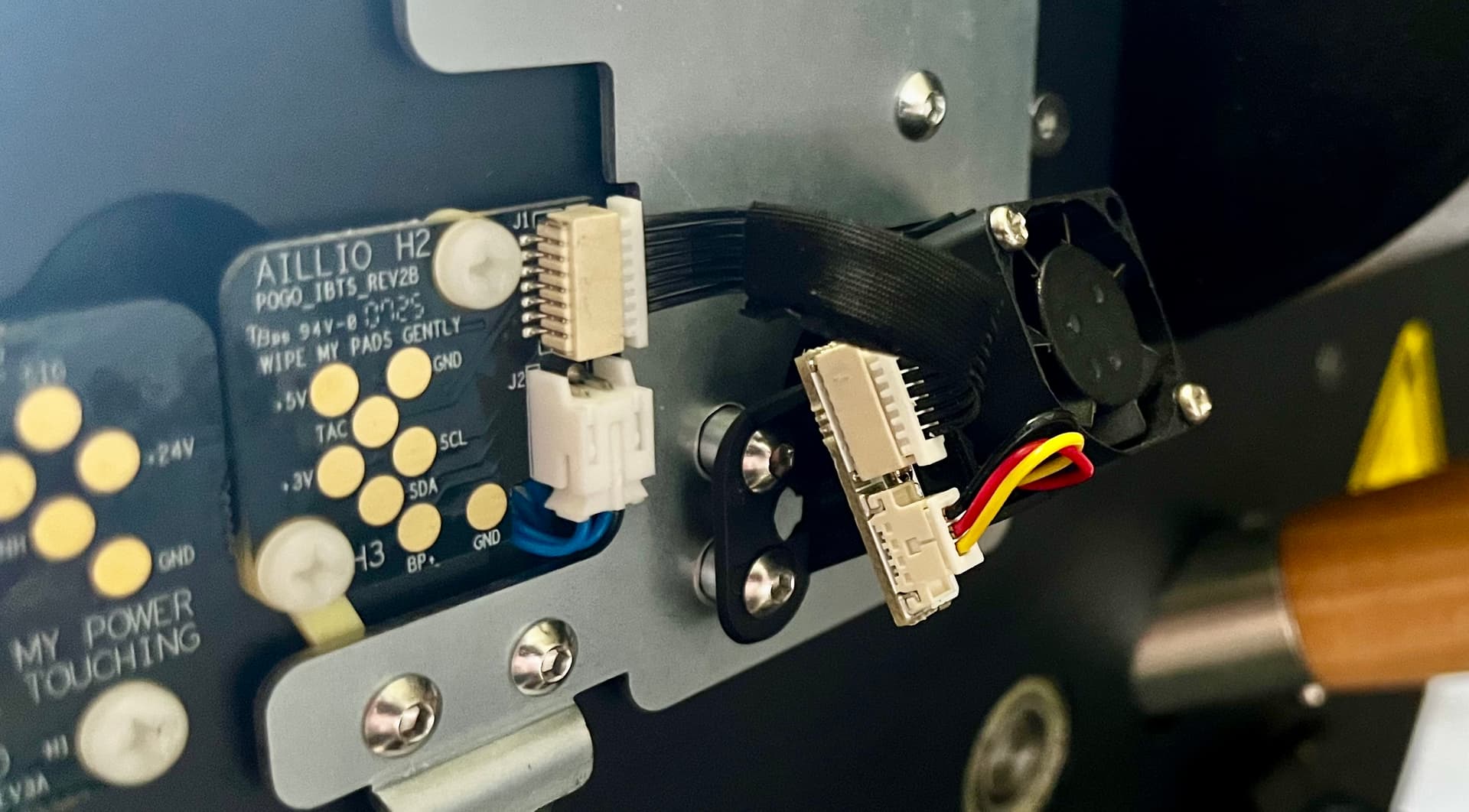

hi @jedsadazisz the brackets looked and felt seated correctly - are there any other items to look into?
Hi @ant.roasts
Thank you for checking. From the photo, the IBTS bracket looks seated correctly.
Could you also please check that the IBTS cable/connectors are fully inserted and properly seated on both sides? A loose or partially connected cable can also affect the temperature reading.

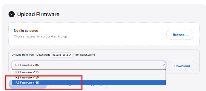

We also suggest updating to the latest firmware version, v165.
You can update using the web updater tool here:
bullet-r2-web-update
You can also try rolling back to the previous version, v116, to compare and see if the IBTS curve/RoR noise is still present.

Thanks again @jedsadazisz - I just checked and the IBTS cable/connectors are firmly in place.

Hi @jedsadazisz I’m receiving this error when attempting to download v165- “Download error: Failed to fetch”.
I was able to download and update to v159 yesterday.
I had the same issue trying to get the v165 firmware. My problem first went away after updating with v159 but it literally only lasted one day and then it started happening again.
