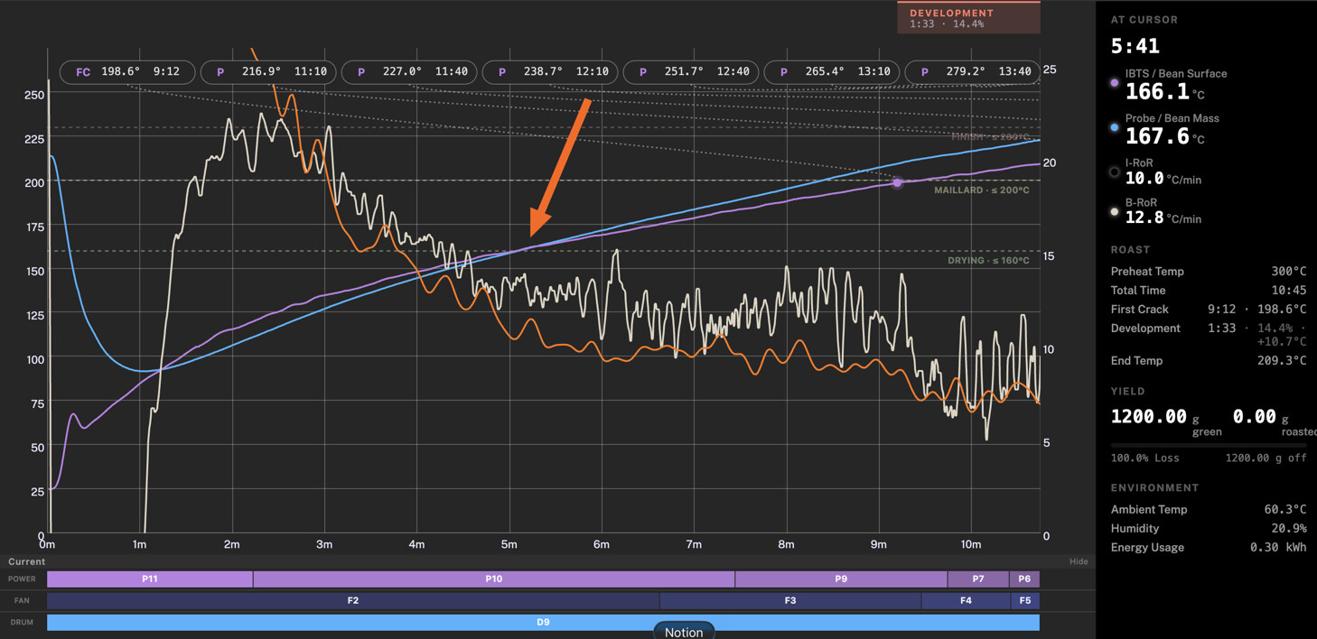

I’m using a Bullet R2 Pro with RoasTime v4 and I’ve noticed that on some 1200g batches the IBTS curve starts reading lower than the bean probe well before first crack , not just near the end of the roast.
In this example, the roast is a 1200g washed Colombia batch:
  • Roaster: Bullet R2 Pro
  • Batch size: 1200g
  • Coffee: Colombia washed
  • Preheat: 300°C
  • Drum: D9
  • Starting power/fan: P11 / F2
  • First crack: 9:12 at 198.6°C IBTS
  • Drop: 10:45 at 209.3°C IBTS
  • Development: 1:33, 14.4%
At around 7:58, the readings were:
  • IBTS: 187.7°C
  • Bean probe / BT: 194.7°C
  • Difference: BT was about 7°C higher than IBTS
The part that concerns me is that the curves crossed well before first crack , not only during development or right before drop. First crack still happened at 198.6°C IBTS, which seems within a normal range, but I’m not sure if BT being higher than IBTS this early is expected on larger R2 Pro batches.

BT is not just slightly crossing IBTS. At drop, IBTS is around 209°C while BT is around 227°C. That feels too high to use as a real endpoint reference. In this case, would you still trust IBTS more for drop decisions, assuming FC is around 198-200°C IBTS?

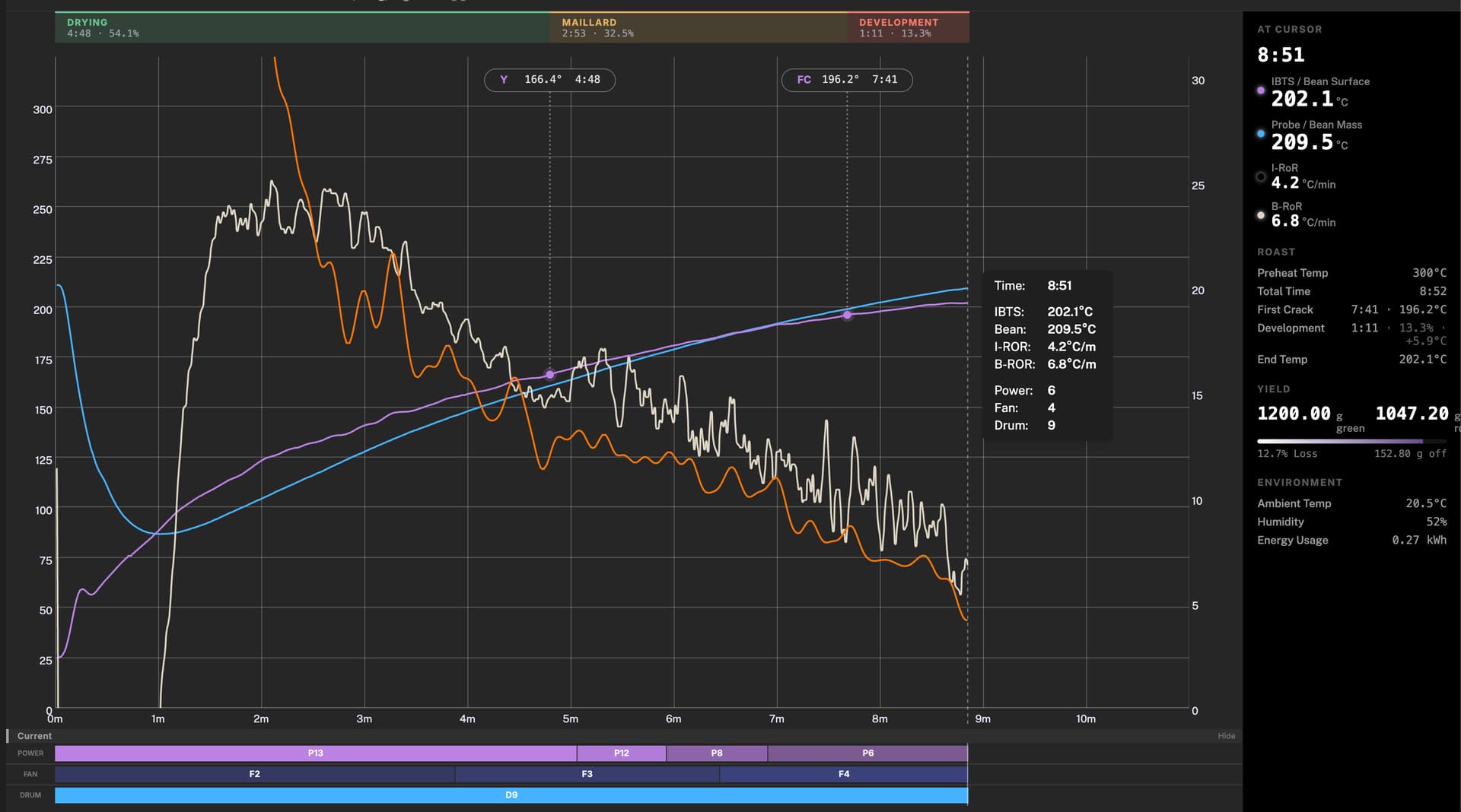

I have the same issue.
This is also a 1.2kg washed Colombian roast, roasted on R2 Pro:
