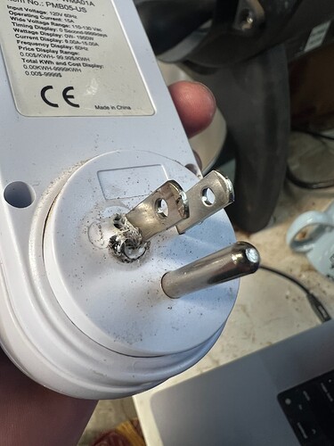

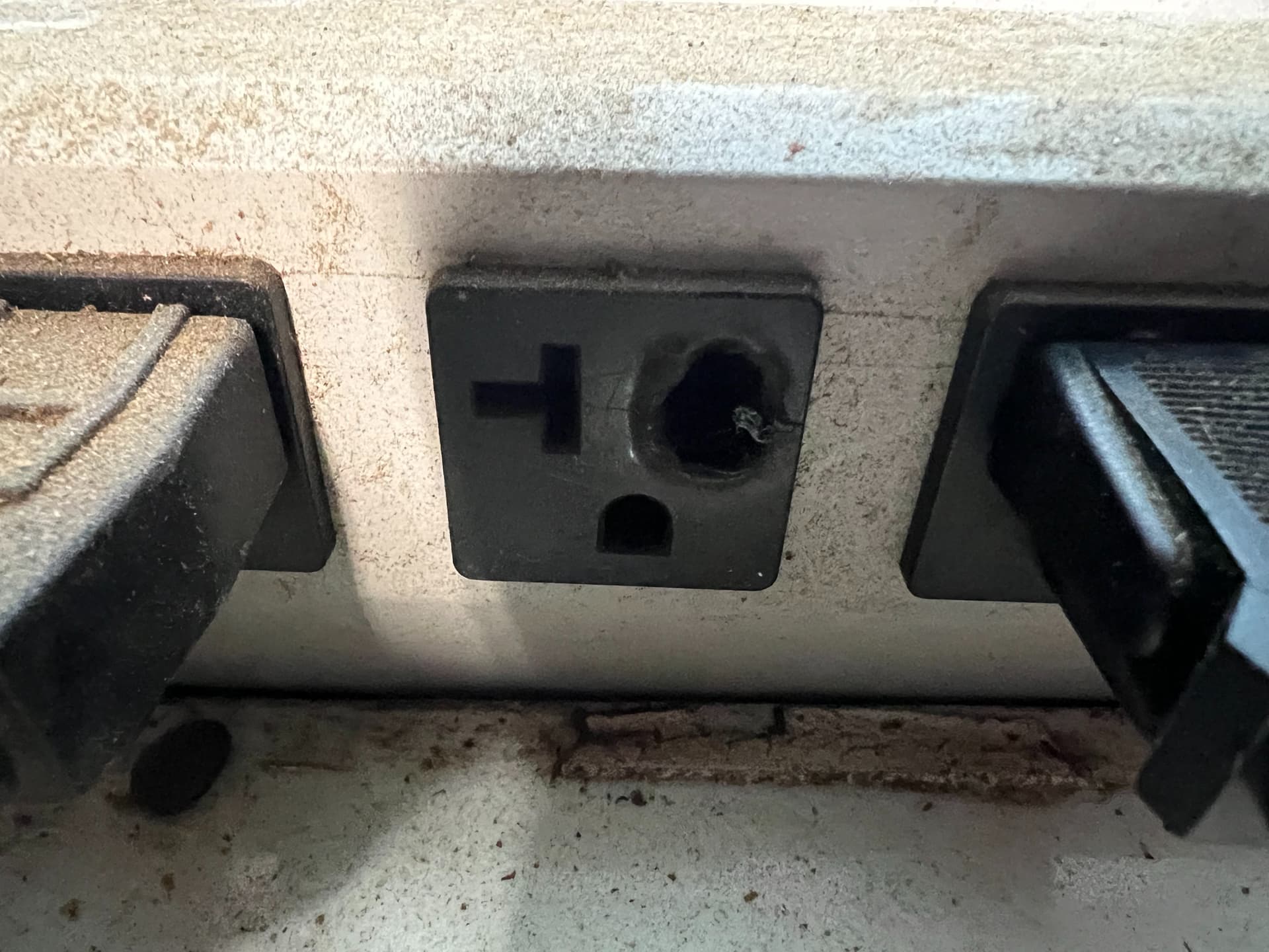

Well I think I found the culprit although I’m still not sure why there was a surge that fried my voltage meter. I’ve used the voltage meter for at least 50 roasts with no issue until today.
