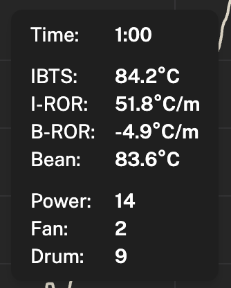

The CSV file with all of the roast data doesn’t seem to match the data shown in RoasTime. This is a sample from one roast at the 1min mark. RoasTime shows an IBTS temp of 84.2ºC and I-ROR of 51.8ºC/m, whereas the CSV shows 82.38ºC and I-ROR of 30.04ºC/m. The bean temp/ROR is also off.

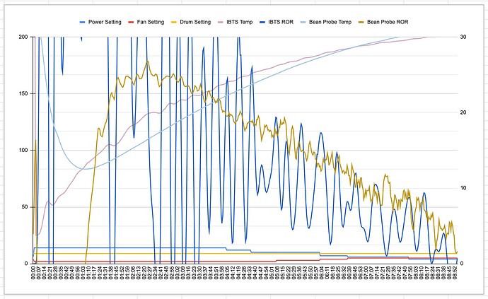

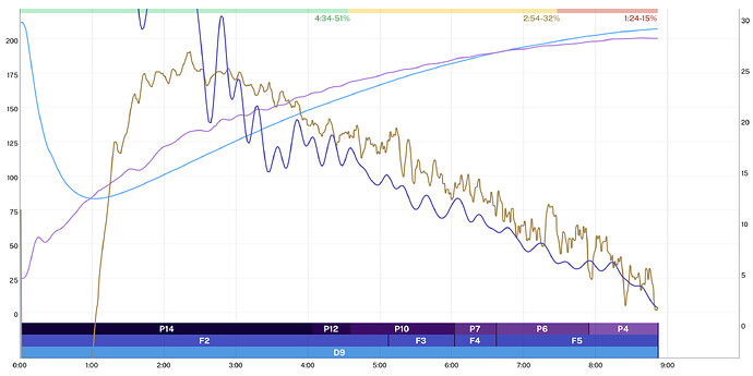

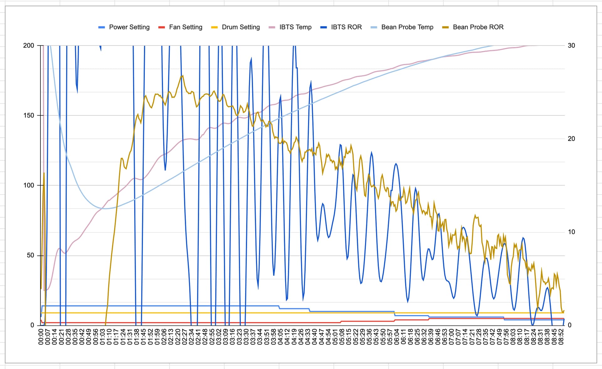

If I make a graph from the CSV data, it looks very different to what’s shown in RoasTime (mostly the IBTS ROR):
