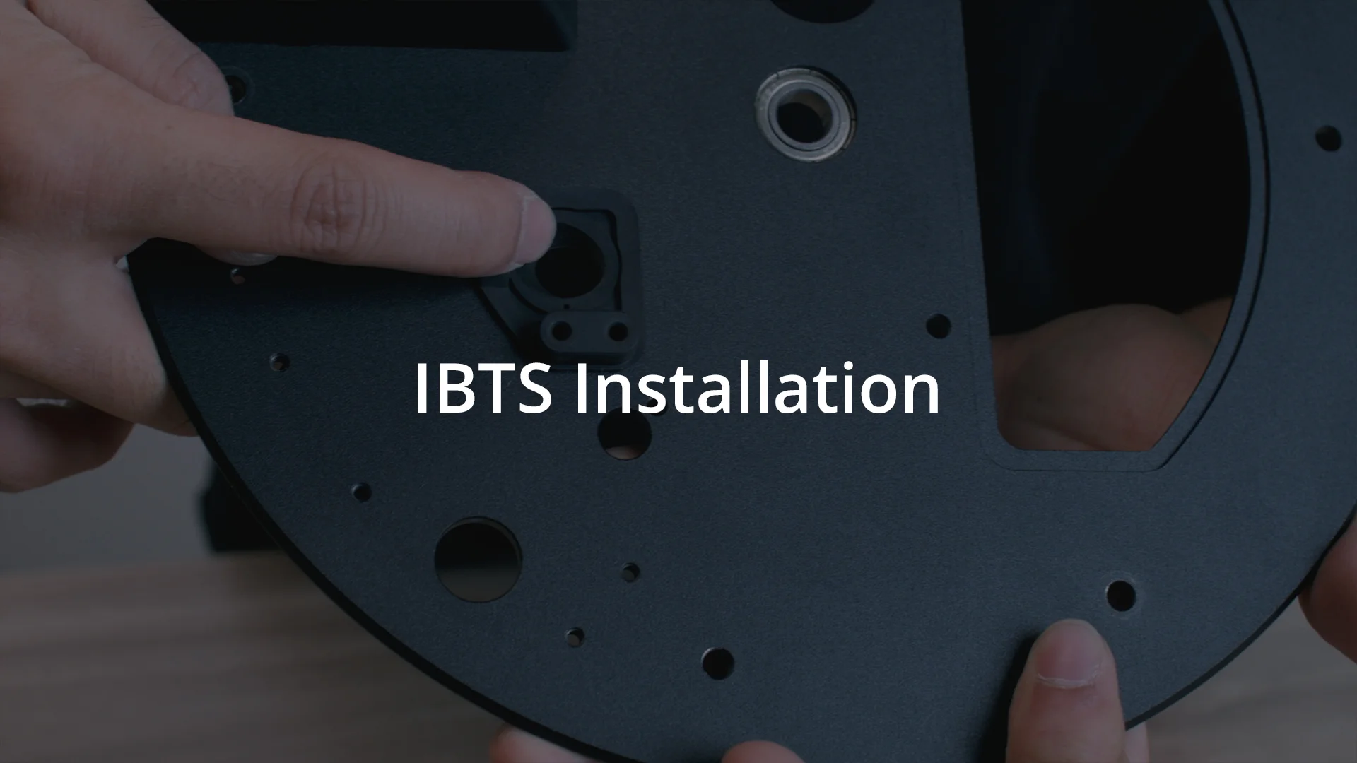

Hi,
Here’s a guide to installing an IBTS Module:
Please contact [email protected] if you need more information.
Best regards,
Kevin
