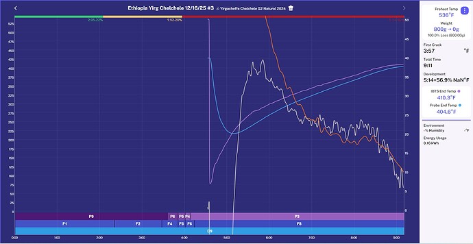

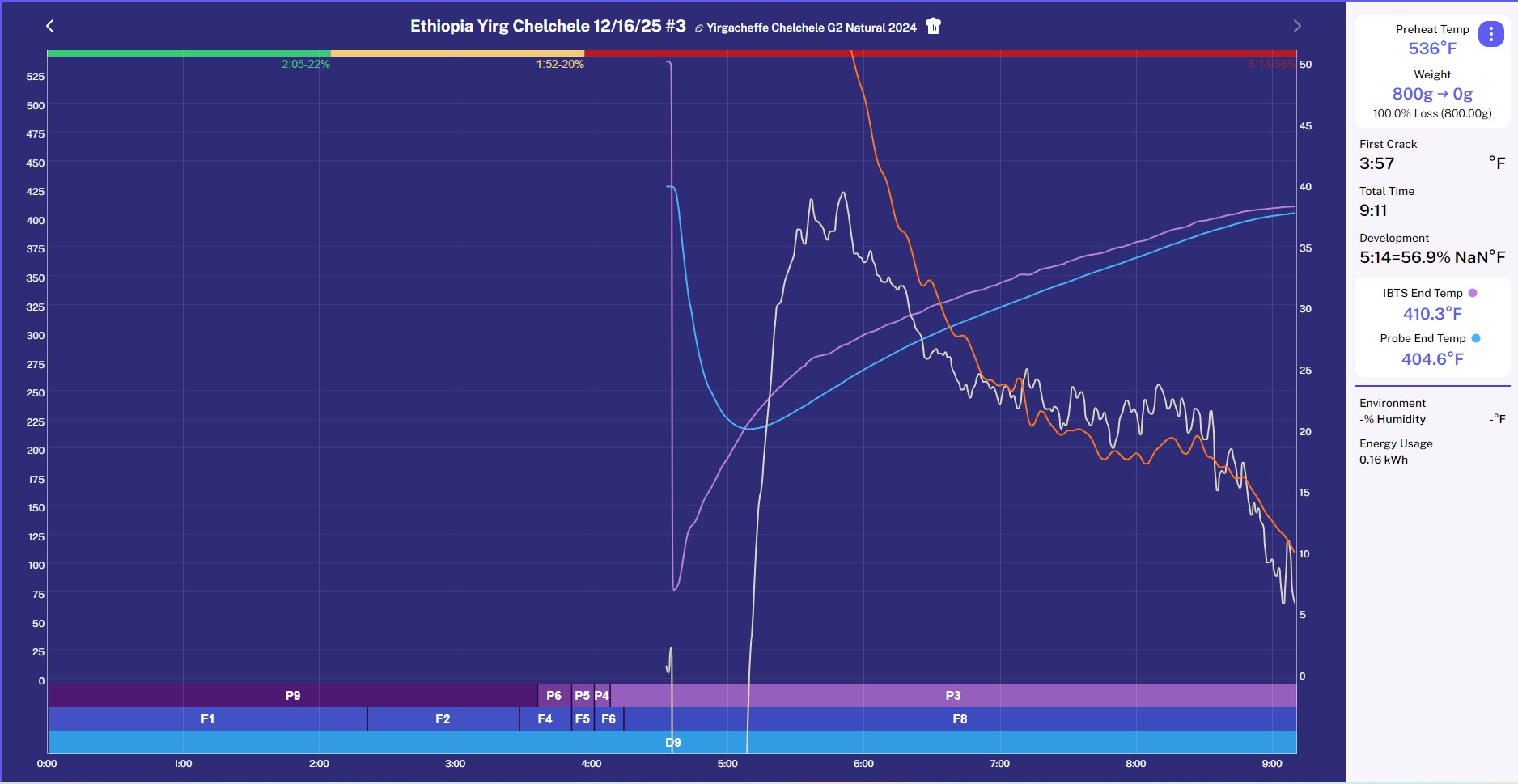

Hello, I updated to this version last night and I’m having all sorts of issues. Here are what my roast graphs look like
Why is there so much dead space on the left side? When I mark yellowing and 1st crack the times that show up are way off from what they actually are. Anyone else having similar issues?
Has this issue been resolved? I am planning on a significant roasting session over the holiday and I know RT will force an update, which is something I would typically do before I start my session. This forced update without a choice to hold off has always been a pet peeve of mine. :slight_smile:
I was able to fix it by powering down the bullet, closing out of roastime, waiting 30 seconds, then restarting everything. I have had zero issues sense.

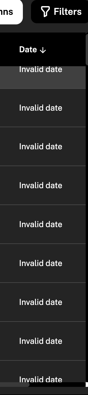

just tried it, but on Date shows Invalid date. not comfortable, have to use the legacy again.
