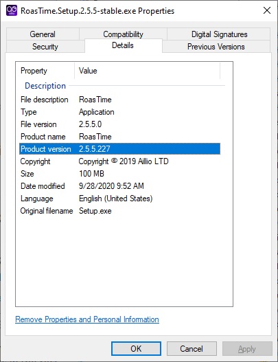

This happens on two different Windows 10 PCs, running the latest Stable 2.5.5 RoasTime software. Given the state of development with the software, I’m starting to wonder if this function just isn’t finished in stable, and maybe I should try beta or alpha…

Can any of you who have recipes that actually work as expected give me a screenshot – or just a text list of trigger settings and actions – that I can try to duplicate? And are y’all running beta or alpha versions of RoasTime? Screenshot here of the version details of the software I’m running:
