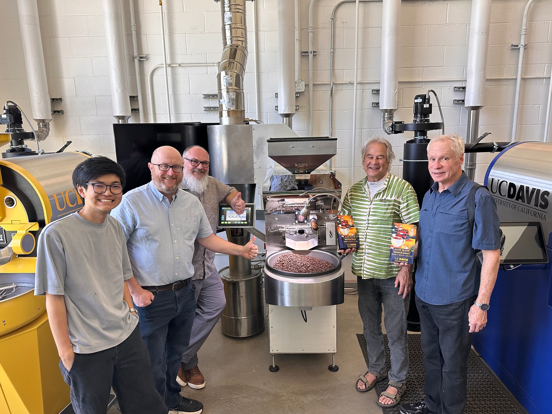

Interestingly, I visited the Coffee Center at the University of California, Davis last week. They have a number of large commercial roasters. While there, they did a demo roast for us on a Loring. It doesn’t have a window into the roaster to see the bean color and it was too loud to hear FC. They largely use bean smell and color from the trier. I’m the guy in green…
As a BTW comment, They have 2300 students take their classes and the director told us it’s the only university-based research center in the US. It’s the most popular class on campus. UCD has about 32,000 students

Very interesting about UC Davis. That makes sense on a commercial machine like a Loring where hearing FC is not practical. In that setting, smell and trier color would obviously become much more important.
