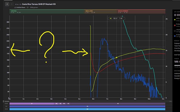

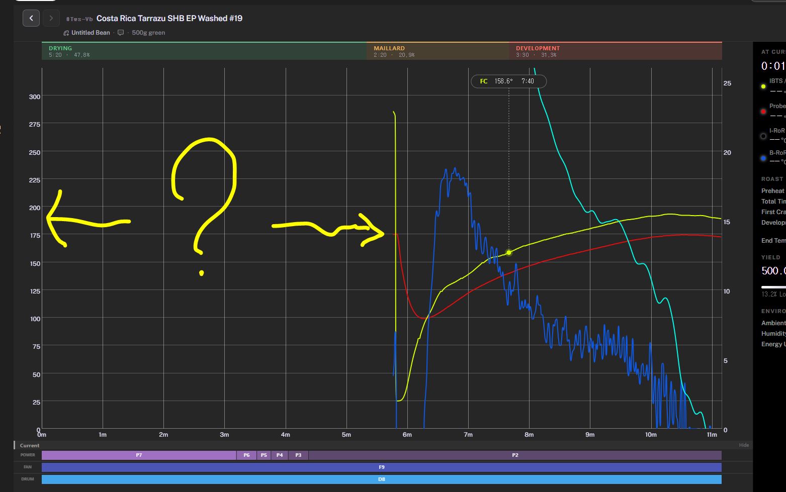

In my case when I start playback mode or overlay mode, the starting point of new roasting profile follows timeline, doesn’t fix at 0:00(slide to right side).
Is this just a happening or program error?
Must be a program error. Have you made sure you’re all up to date on the latest firmware?
