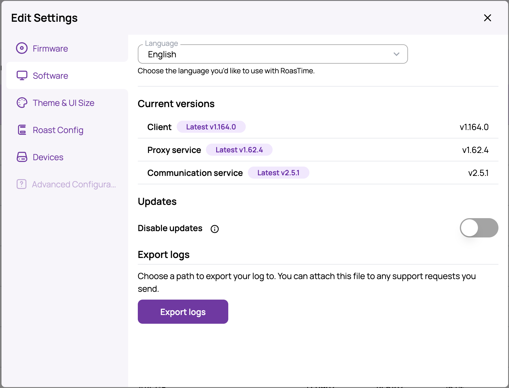

I roasted this weekend and tried to print a bag label but when I press the Print Image button in RoastTime, nothing happens. I am using the latest version of RoastTime on macOS Sequoia. Anyone have any ideas how to troubleshoot a non-functional Print Image button?
Please make sure that your Mac allows you to download the file from Roastime, try to disable your antivirus, and Roastime has a similar Save As - Export Logs button, where you can try to download it here
And this print bag label will have the next upgrade soon, Please let us know if the issue is still present.
@varistaillio, thank you for the response.
  1. I have confirmed that nothing is blocking RoastTime’s access
  2. I downloaded the ARM version for macOS from the Aillio website and reinstalled
  3. After launching the new version, it said there were updates and to quit and relaunch
  4. I quit and re-launched and Roast Time upgraded
  5. However, the Print Label button still does not work - it doesn’t do anything.
Here is the version information for the freshly downloaded RoastTime
And the logs where it checks for an update and says it is up to date
{"context":{"service":2,"version":"4.11.10","action":"CheckForUpdates","logLevel":30},"message":"FE is up to date","sequence":"9","time":1748606802265,"version":"2.0.0"}
{"context":{"service":2,"version":"4.11.10","action":"CheckForUpdates","logLevel":30},"message":"BE is up to date","sequence":"10","time":1748606802265,"version":"2.0.0"}
{"context":{"service":2,"version":"4.11.10","action":"CheckForUpdates","logLevel":30},"message":"Comms is up to date","sequence":"11","time":1748606802265,"version":"2.0.0"}
Your client version is v1.165.6 but mine is still v1.164.0 even though I just downloaded it from Aillio.
I really would like to use the bag label feature and I am happy to test a beta release if necessary.
