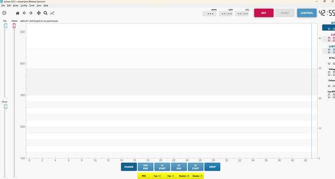

I guess I will have to go to artisan. This is VERY frustrating & dissapointing.
EDIT:

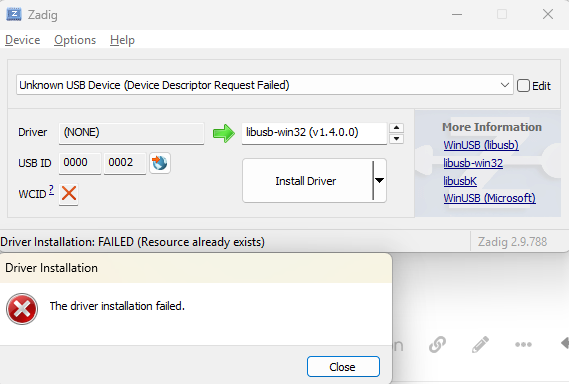

Well, Artisan won’t see the roaster either. Zadig says it is an unknown USB device, and installing drivers fails. What do I try next?

device discriptor request failed is most likely a hardware problem. Any of the USB ports or the cable could be damaged, so try different ones.
Also try restarting both the computer and the roaster.
I had tried all of the USB ports, updating and restarting the computer, and a different cable. I did not want to restart the roaster when it was hot, so I finished the production session manually.
After restarting the roaster this morning it did reconnect to roastime. Does this mean the hardware problem is in the roaster? What do I do if this happens again during a roasting session? Could there be a problem with the usb module in the roaster?
