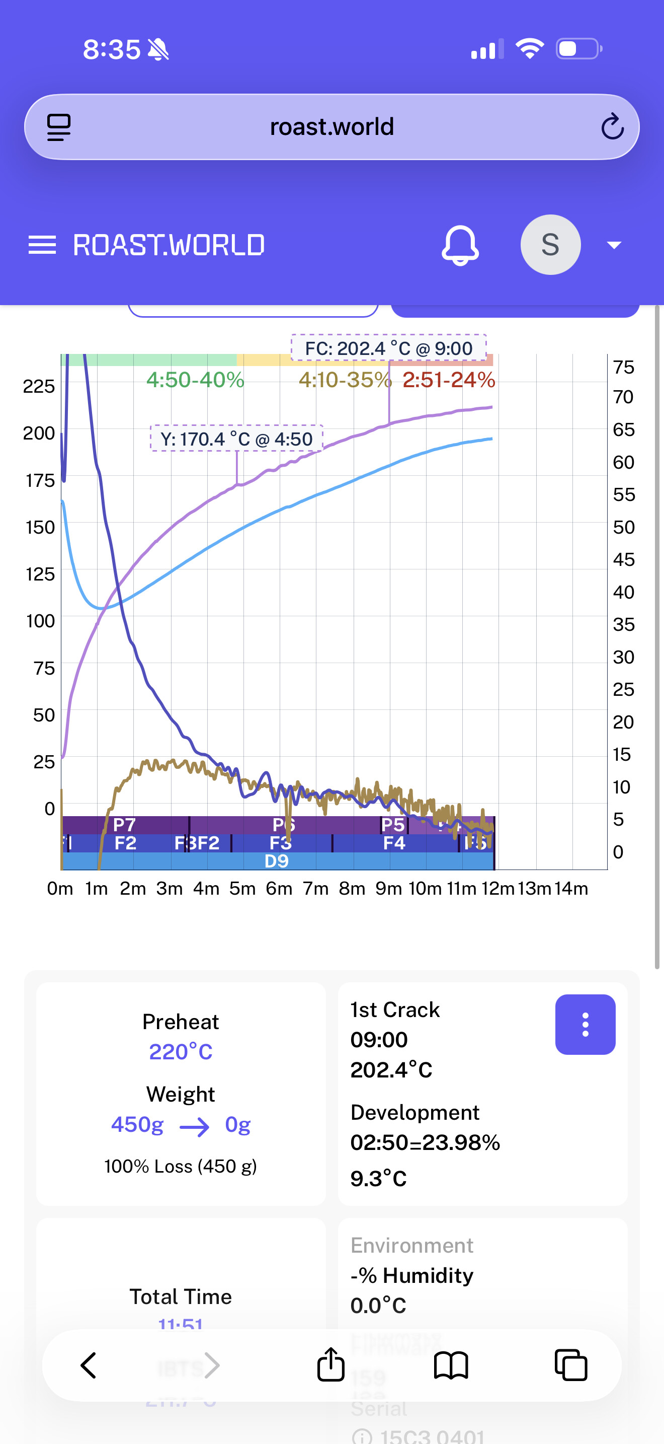

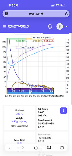

Why is my RoR all over the place at 160C? I’ve updated the firmware already
I’m struggling to understand why my RoR jumps and drops so significantly once I hit around 160-170? I just got the R2 and at first I was getting huge spikes at 160C and did some research noting I needed a firmware update. After that it seemed to go away but I’m struggling in the malliard phase to keep temp stable

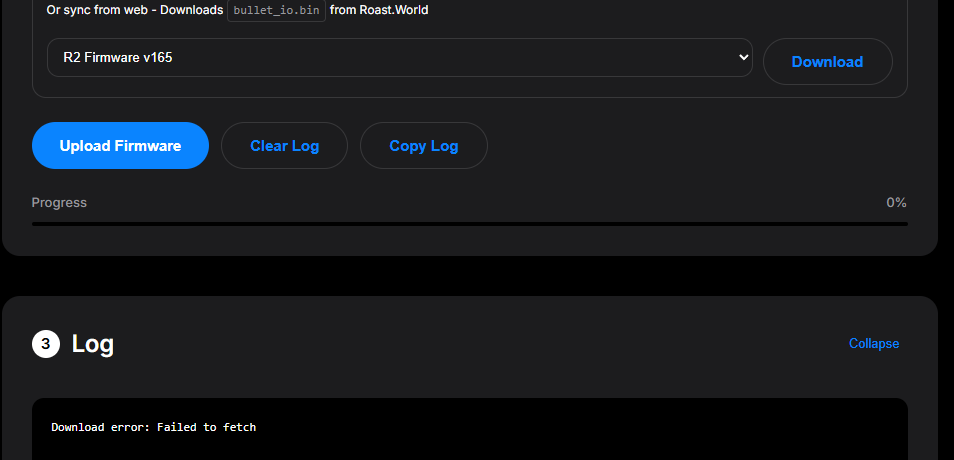

Thanks for responding! I tried to download the v165 and I keep getting the same “failure to fetch” message.
I’m also receiving the same when attempting to download v165- “Download error: Failed to fetch”

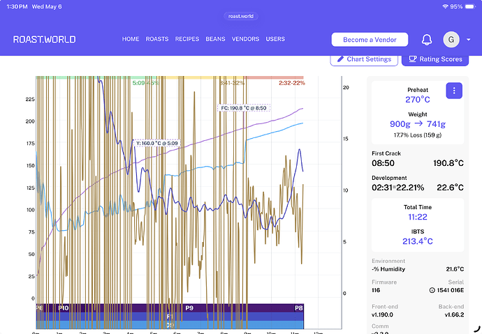

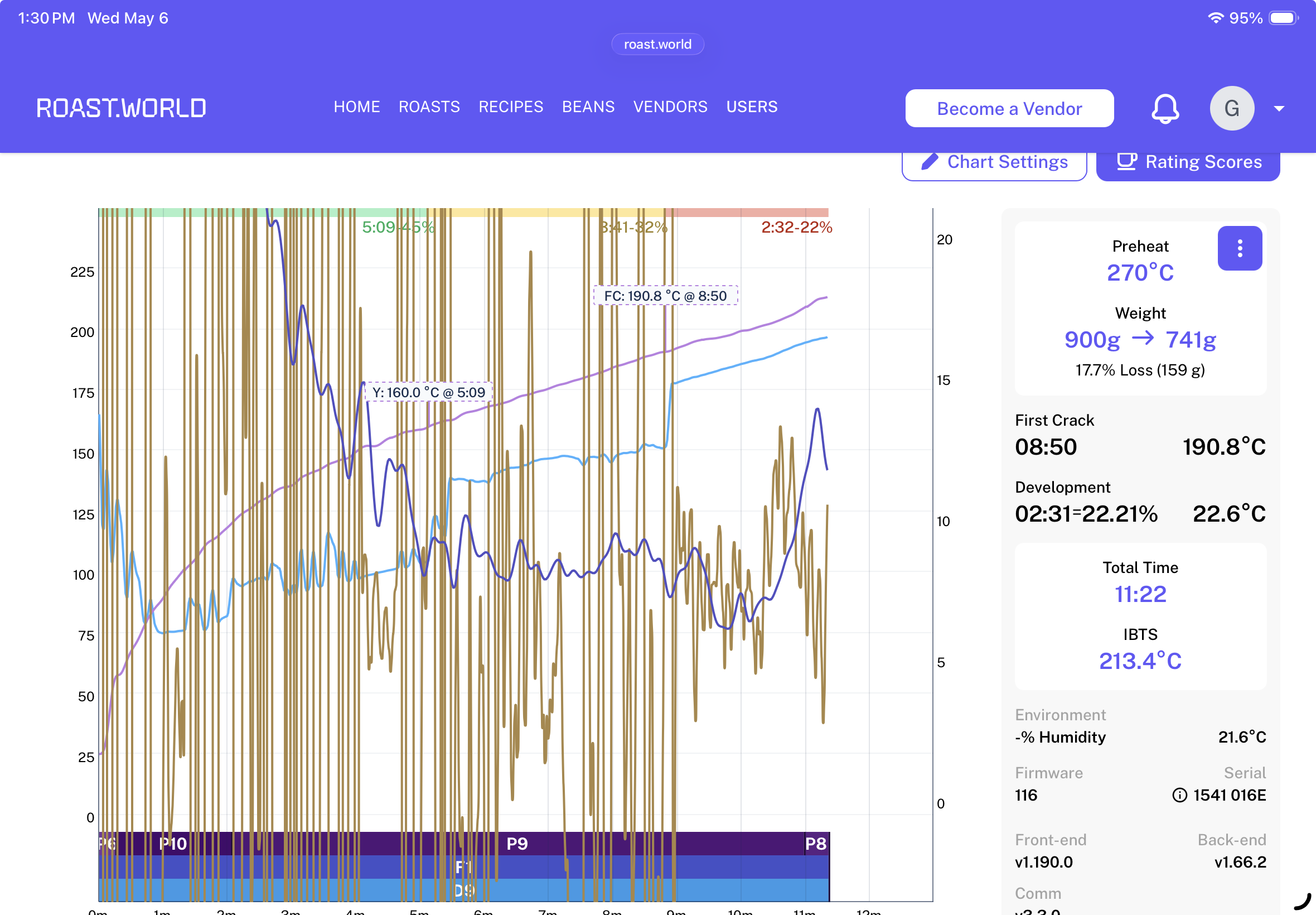

Is this the same issue? Bean temp is all over the place, so I have been following the ibts info during my roasts.
Feed back would be appreciated.
-Greg
I have same issues after updated every firmware with my R2 Pro. :thinking: :thinking:
This is more likely to be a defect bean probe. Please reach out to support to get a replacement.
