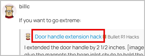

If you want to go extreme:
The handle never gets hot now.
The extra leverage, helps keep the door closed.
The magnet keeps the door open while dropping roasted beans.

If you click on the blue Door handle extension hack link in my post above, everything is listed there including sources (mostly from Amazon)
Also pictures of the different components and cut to length dimensions.
I used high temp RTV for gluing the magnets to the bullet.
