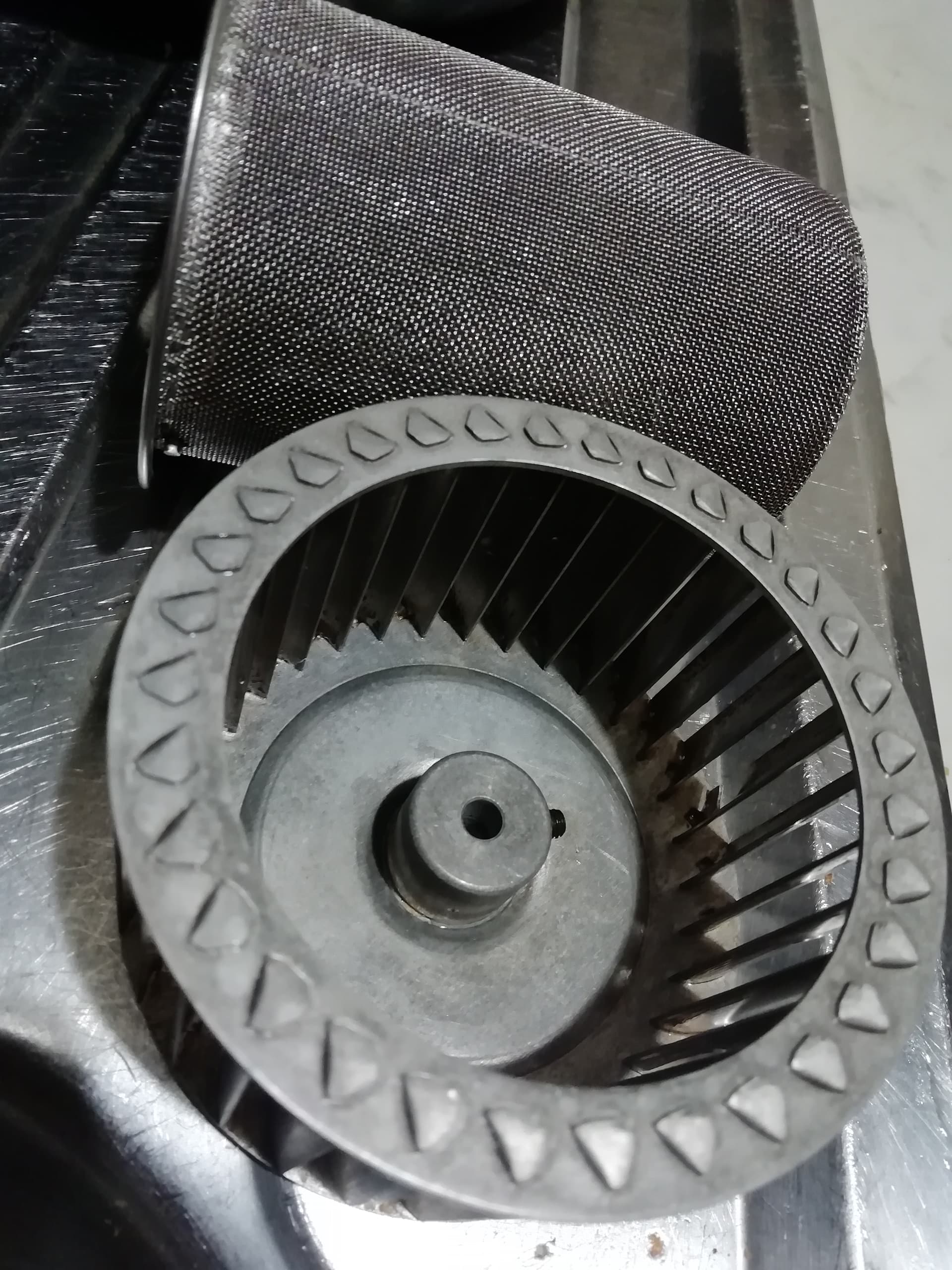

That is because of sodium bicarbonate. You could use just that without the other ingredients, which might, in the long run, be detrimental. Maybe not, but I can guarantee that you’ll get the same results soaking it in water, just off the boil, with baking soda. Here’s a picture…

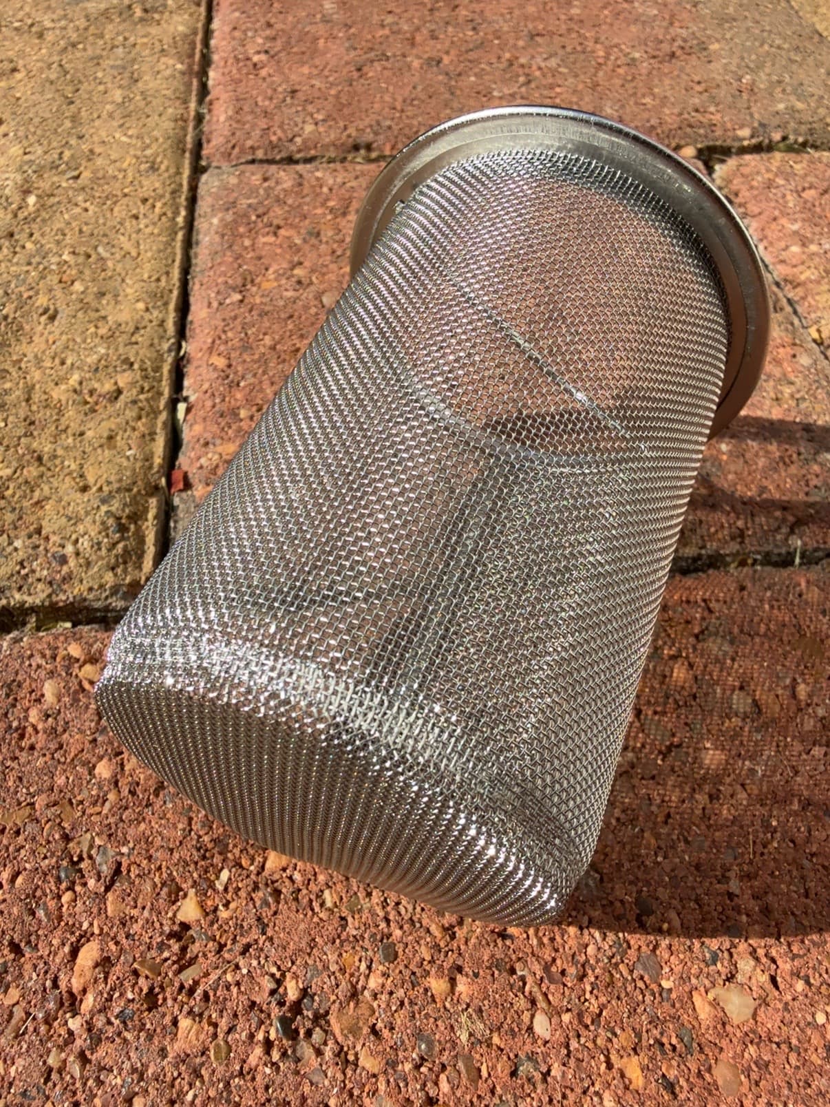

Another method that has worked very well for me is cleaning the stainless-steel chaff filter in an ultrasonic cleaner with Simple Green concentrate diluted 1:4 with water. It removes the buildup very effectively, and the filter comes out sparkling—almost like new.
This photo is after 260+ roasts. I haven’t seen any visible corrosion or damage, but 1:4 is a fairly strong mixture, so I keep the cleaning cycle brief, avoid prolonged soaking or excessive heat, rinse the filter very thoroughly with clean water, and let it dry completely before reinstalling it. For routine cleaning, a weaker dilution such as 1:10 may be the more conservative choice, with 1:4 reserved for stubborn buildup.
This is simply what has worked for me; Aillio’s documented cleaning methods do not specifically endorse Simple Green.
