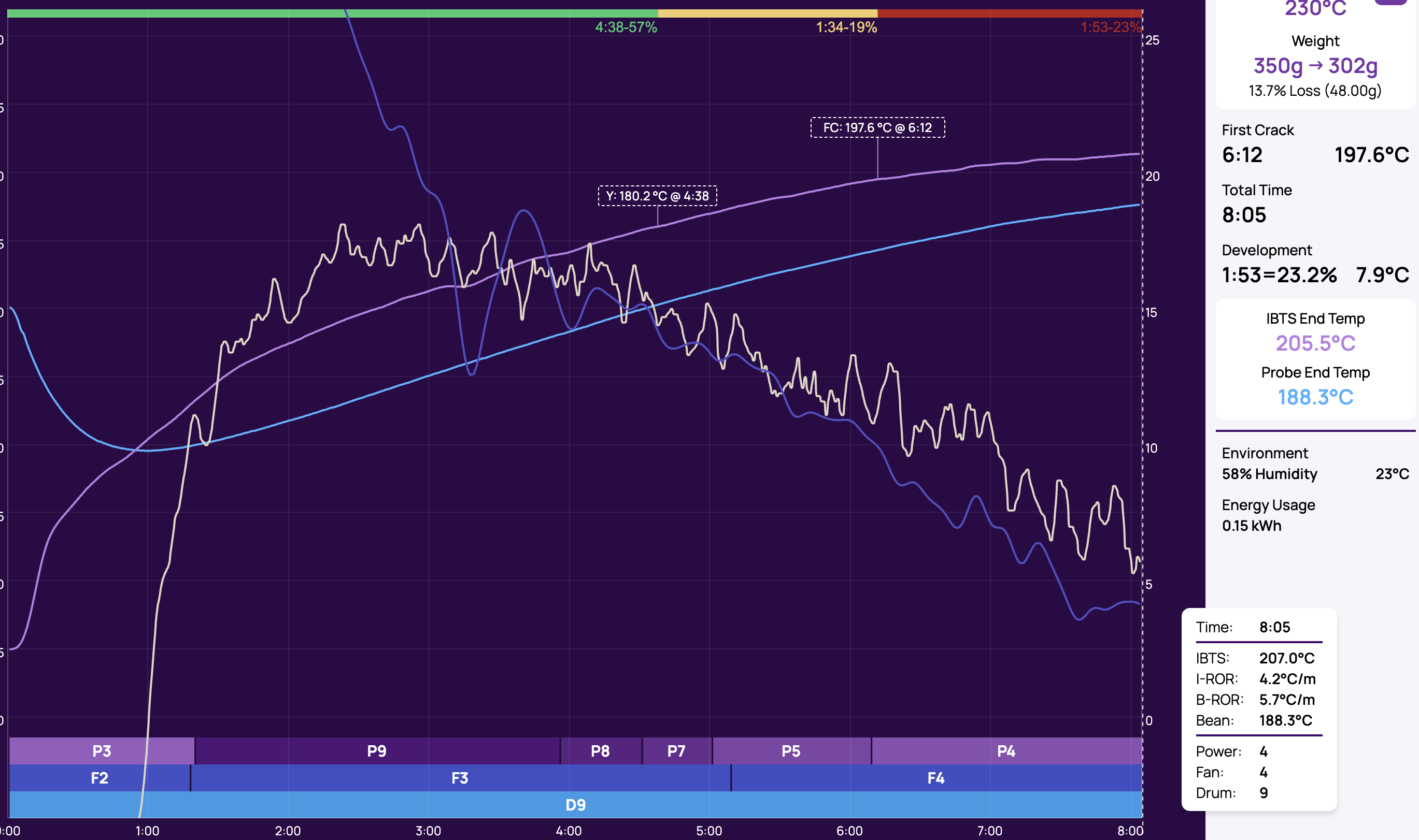

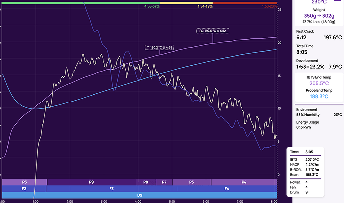

Hi @jacob , I’ve had this issue recently and found this thread. Has this ever been resolved? Please see the screenshot, with a circa 1.5c difference in IBTS temp.
