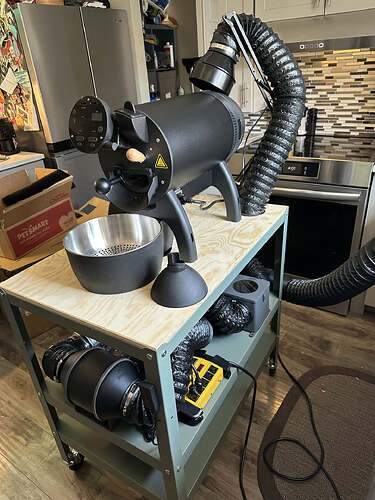

Got my setup completed! This has been very good so far:
Everything collapses very easily for quick setup and clean up. When not in use I just roll it into a corner of a room near my kitchen.

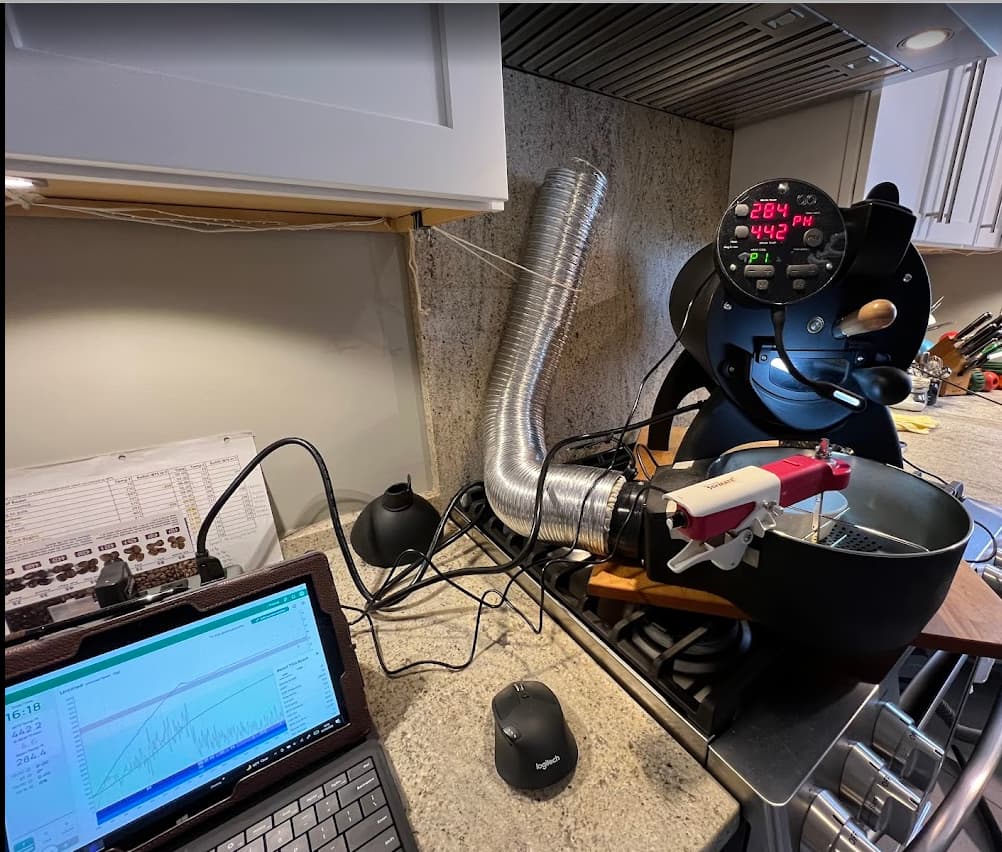

I don’t use the cloudline, I use my range hood that has 6 settings up to 900 CFM. The only 3D printed adaptor I use is the one for the cooling tray so I can connect a semi-ridge vent hose to it to direct the smoke closer to my range hood. I do have a MERV 13 filter behind the range hood’s grease trap to protect my blower from unnecessary dust from the smoke (there are some for sure) - I take that MERV filter out when I’m doing roasting. That hose you see is a 4" one.
My current setup now:

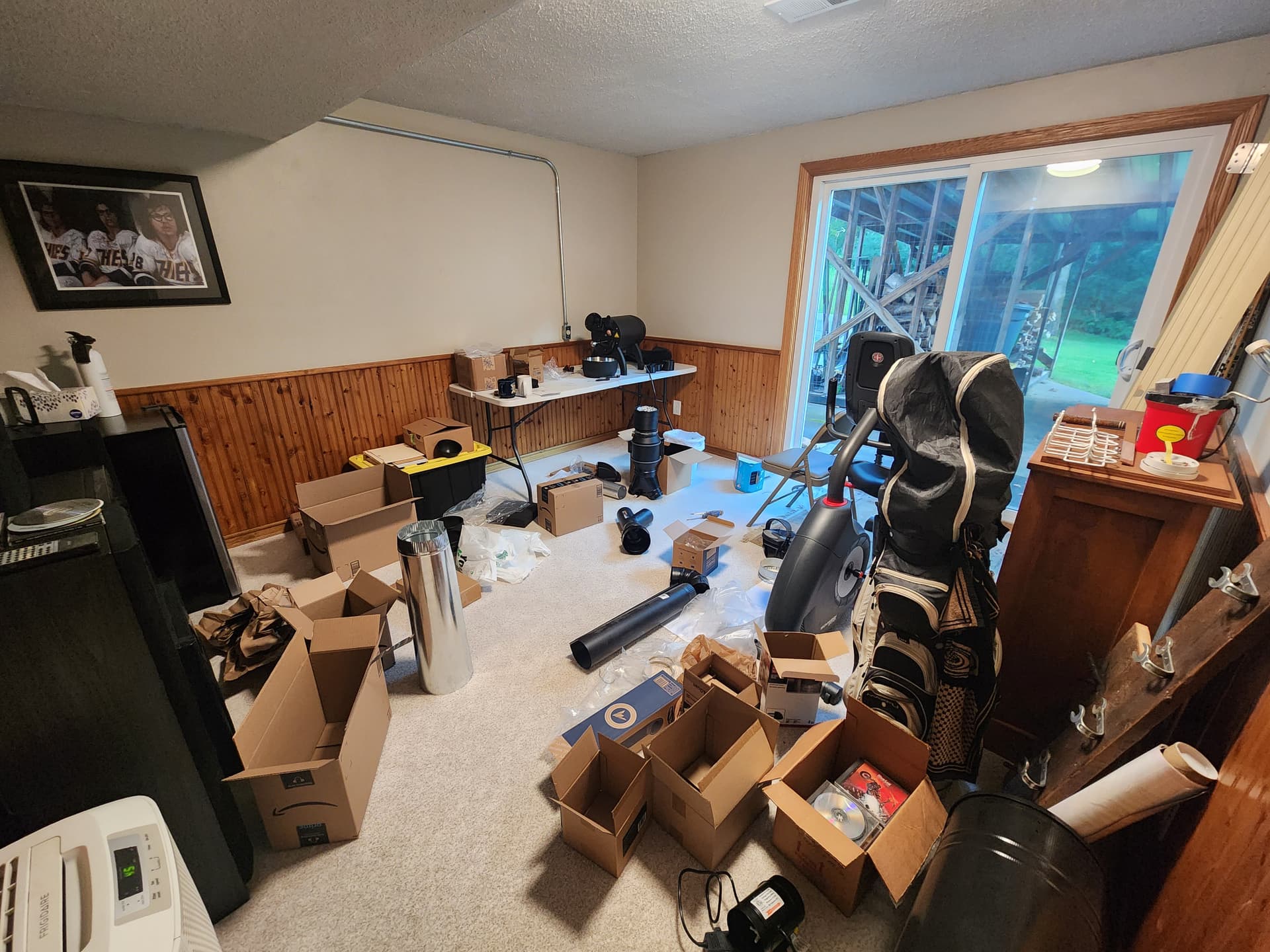

Hello everyone,
Just got my roaster a couple of weeks ago, got electrical ran and i am building my table at the shop right now hence the temporary on for design purposes. Here is what i got as of now, it will improve hourly as i do know the location i want to mount the fan and where the exhaust is going out the wall into a 6" damper style vent.
The location is permanent in this room, thats why i’m using a permanent location for the exhaust vent. A bunch to return but it wad all needed for R&D!!

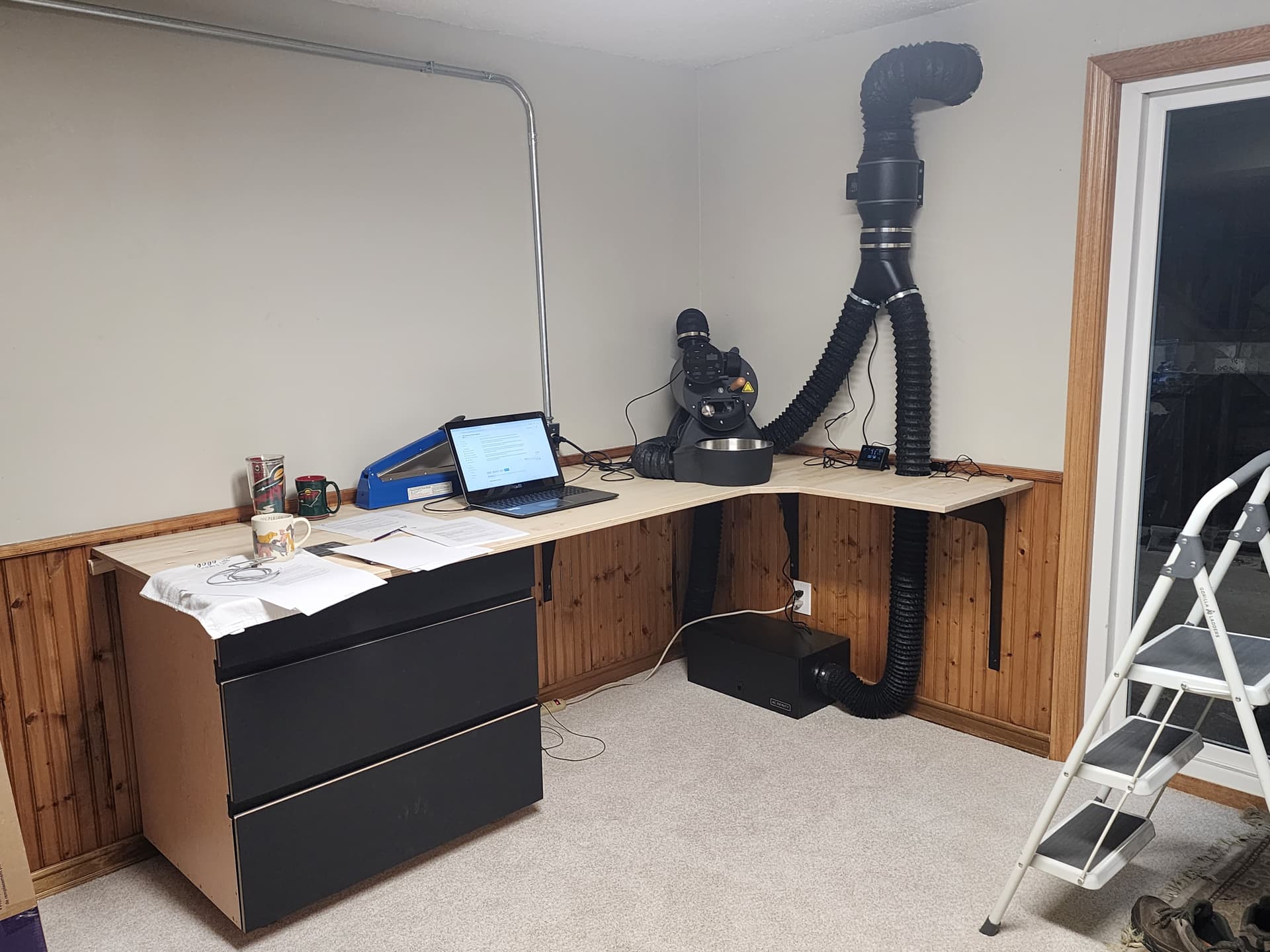

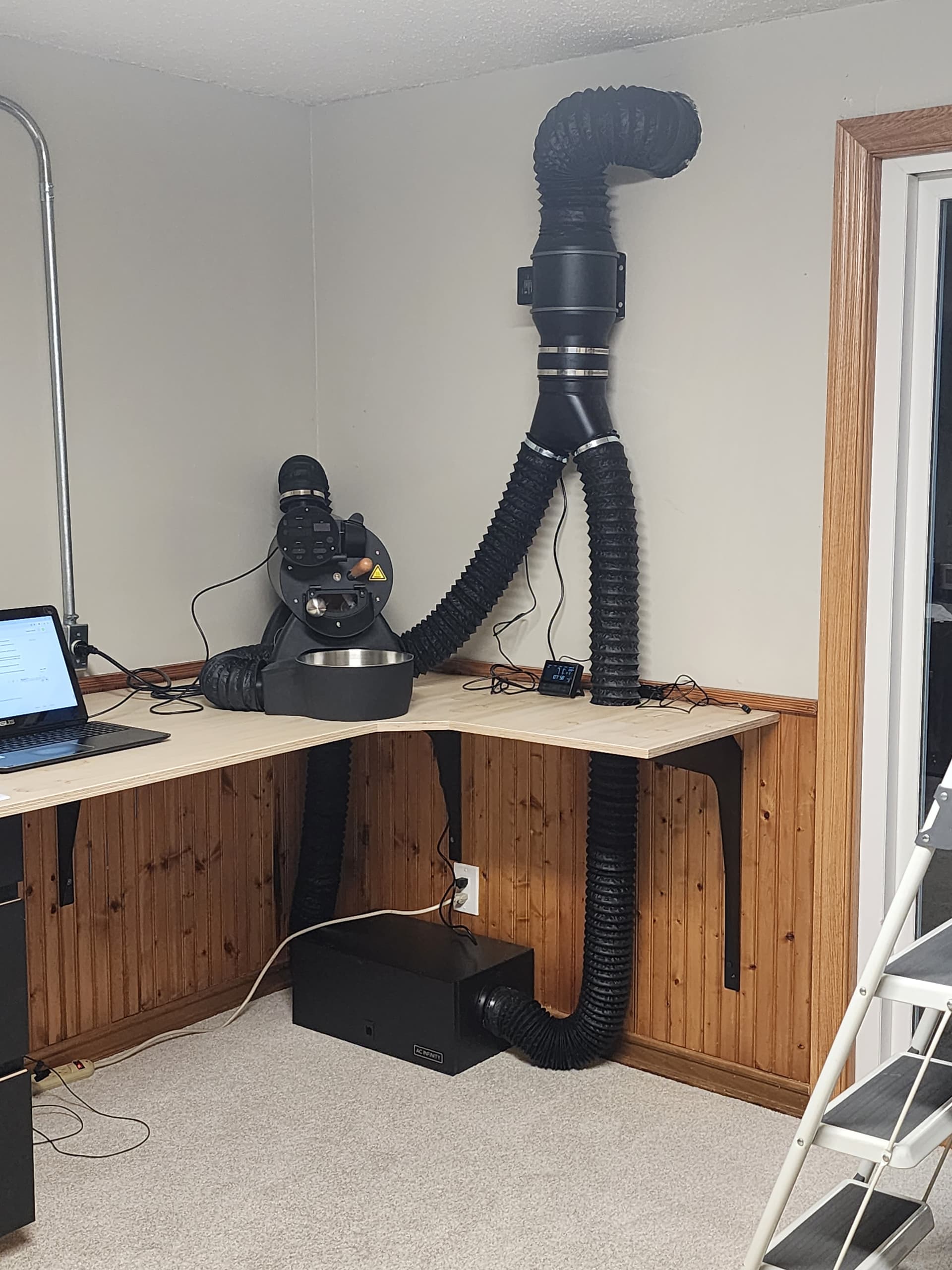

Well, this is trial set up.
Im going to try this and see how it may effect the temp in the roaster and fan speed of exhaust, as seen before i do have the parts to modify if needed…
This look smart! which size is your AC Infinity Inline Filter Box? because I’m thinking to get a 6" or 8".
Great setup ! What is the size of the AC Infinity Inline Filter Box? I’m thinking to get a 6" or 8" but maybe is too much. But I need to control as much as possible the smoke to not bother the neighbors
It is a 6", it works great.
If you have the r2 pro, the vent needs to be clamped to the filter cooler fan box as its pretty strong and blows right off and fan at 9 at the cooling stage to equalize pressure. It does work good though. I also did the bullet exhaust a bit different as the 3d parts work but are a bit brittle and cracked where it connects to the bullet. I am using semi flex tubing right now but i am going to 4" black stove pipe when i have time to get it.
Thanks for your reply. Nice to know about this tips. Are you using carbon filter too?
