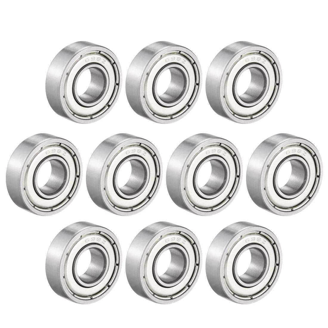

I just replace bearings with “uxcell Deep Groove Ball Bearing Double Shield 10mm x 22mm x 6mm Chrome Steel Bearings”:
