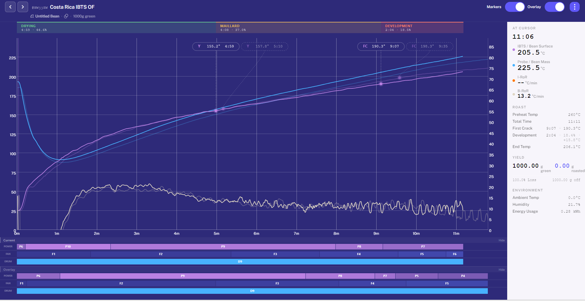

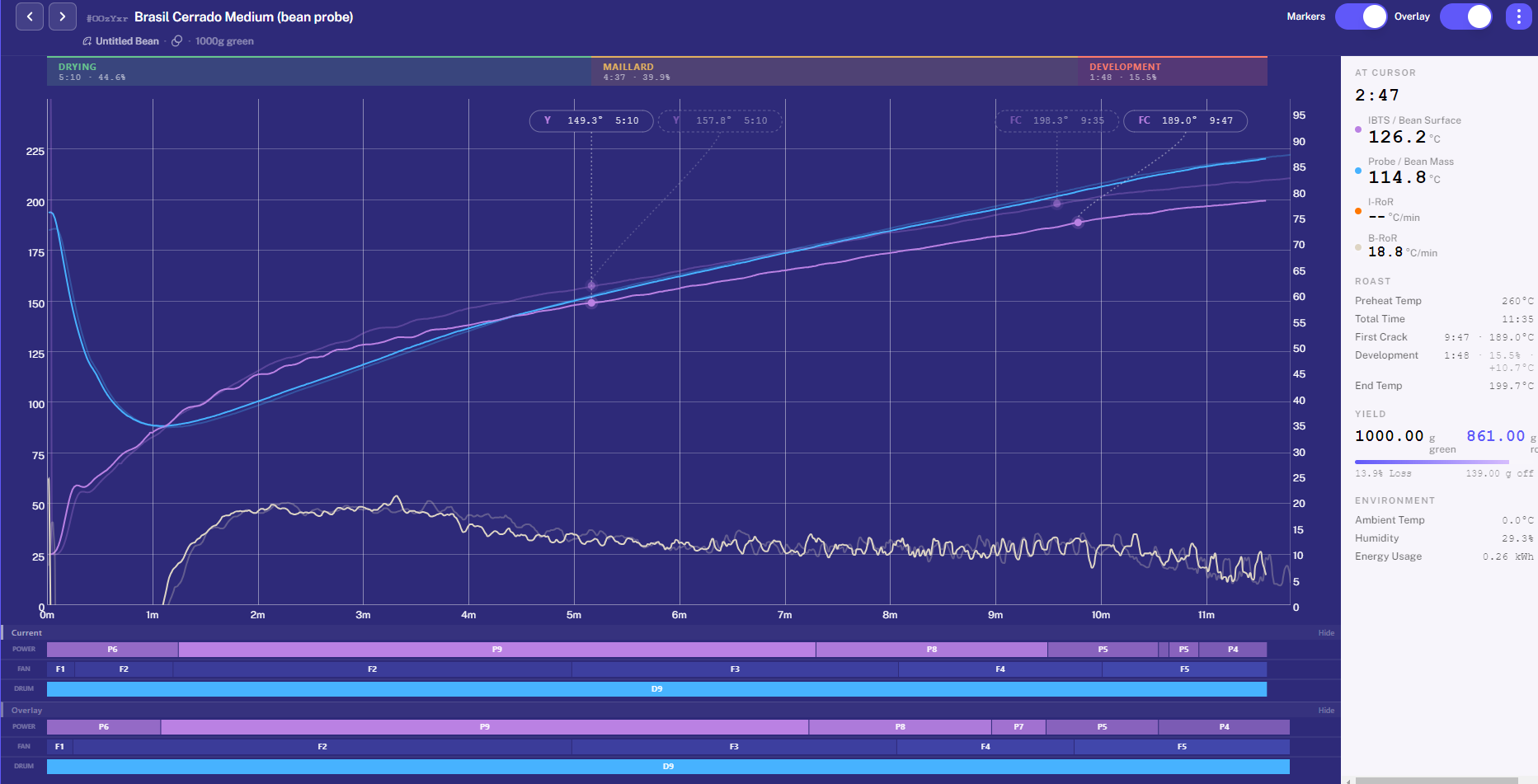

If I use an existing roast profile in overlay mode and repeat it exactly, the IBTS sensor reads the correct temperature at the beginning of the roast. Around the yellowing phase, it reads approximately 5°C lower, and around first crack it reads about 10°C lower.
Previously, first crack starts at around 198°C, whereas it now starts at around 188°C.
