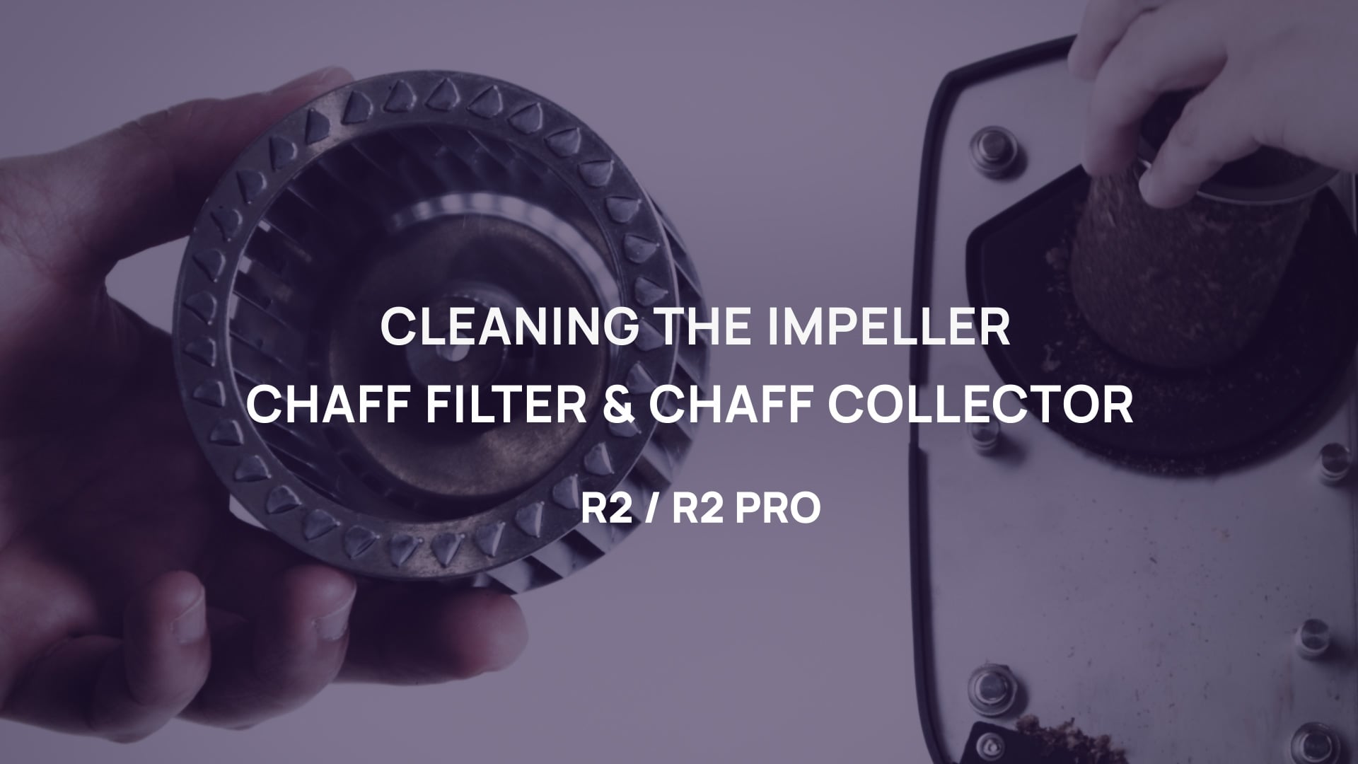

Have you been maintaining the Chaff Filter? This can happen when the Chaff Filter is completely clogged, covered in hardened coffee oil. This is a cleaning guide for the R2 Back Assembly, but the steps are identical to R1:
Please check if the issue persists after maintenance.
For your information, the Impeller should spin counterclockwise to push the air toward the Exhaust Port.
