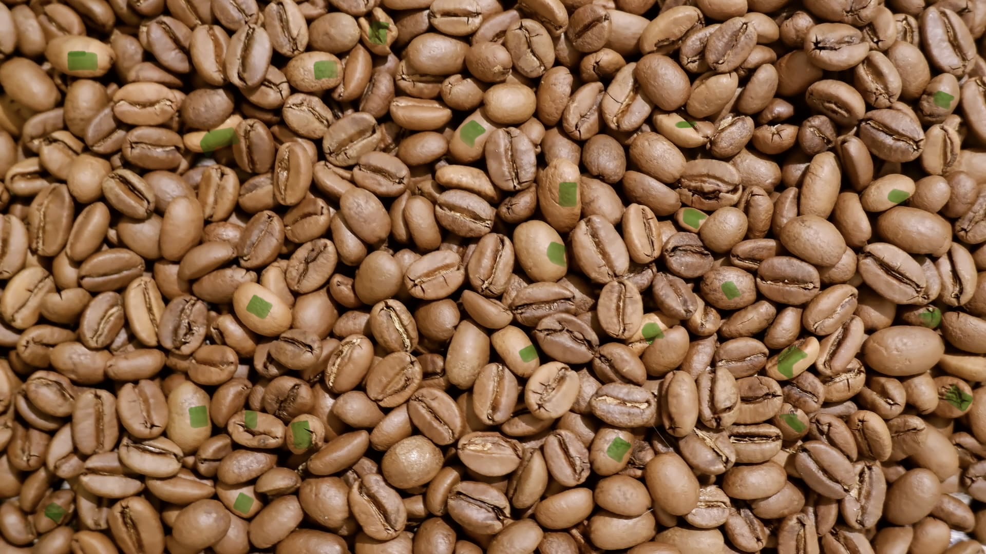

Sorting Out Imperfect Coffee Beans and Quakers
I’m sorry I can’t remember the exact video, but there was one by the Mill City Roasters or Sweet Maria’s where two guys were talking about that and one of them said: “I just leave them in.”. I’m with that guy. My personal opinion, which shouldn’t have any influence on anyone else, is that I’m not able to perceive such a great difference in cup to be worth the trouble. The quaker rich lower grade (still pretty high compared to other coffees) Yemeni coffees are spectacular with or without them. I repeat, it’s just an opinion, but if the coffee is really, really good, a few quakers can’t ruin it. Actually, for coffee to be considered specialty it must have less than 5 secondary defects, in reality from 1 to 5 depending on the defect, every 350g, which is 0.77lb. That means beans. Even if you’re roasting a full load, you shouldn’t find more than 14 defective beans, which would amount to 3-4g or around 0.0023lbs. I’m sorry, I got carried away, but it came to me while I was writing and it’s important that you get your money’s worth. I drink a lot of naturals, but I’ve never seen 5-10% defective beans. I know unripe beans (quakers) are considered fault and not a defect, but even so 5-10% is a lot. I mean, they are cupping the coffees after evaluating the green. I apologize again for the sharp turn I took.
How to Grade Green Coffee - Size, Defects, Scoring Quality. — ROCC

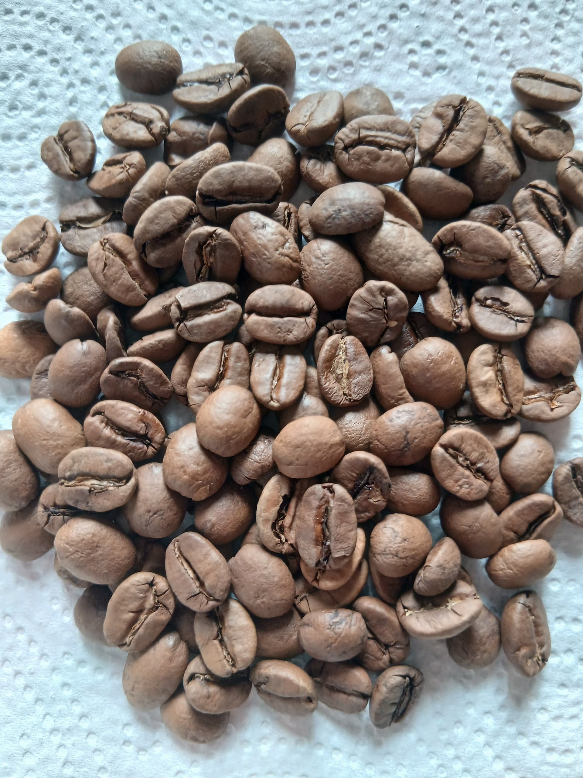

I was curious about the beans that were borderline acceptable, so I saved all the beans that were discarted and then I sorted the best ones from there. The result was a drinkable coffee, however the flavors were muted and muddied with less desireable flavors, especially when compared side by side with the sorted beans.
My conclusion is that if you want a clean cup, and a consistent result, sorting is a must. Even the borderline good beans will not add to the flavors in the cup and in fact will mute the desired flavors. I have to re examine this and take into consideration what y’all are saying, but I still lean towards removing defective, over/under roasted, and insect damaged beans.

I marked the beans I would inspect further, either because they looked lighter than the beans around them or they had some imperfection. The imperfections I look for are uneven outside, chips or missing pieces, uneven or unusual shape, and holes from insects. Also any bean that stands out among other beans that look good.
When I say inspect it means I crack them open and give them a smell and if it smells like something that would be good to drink it goes to the good pile and if not it goes to compost.
