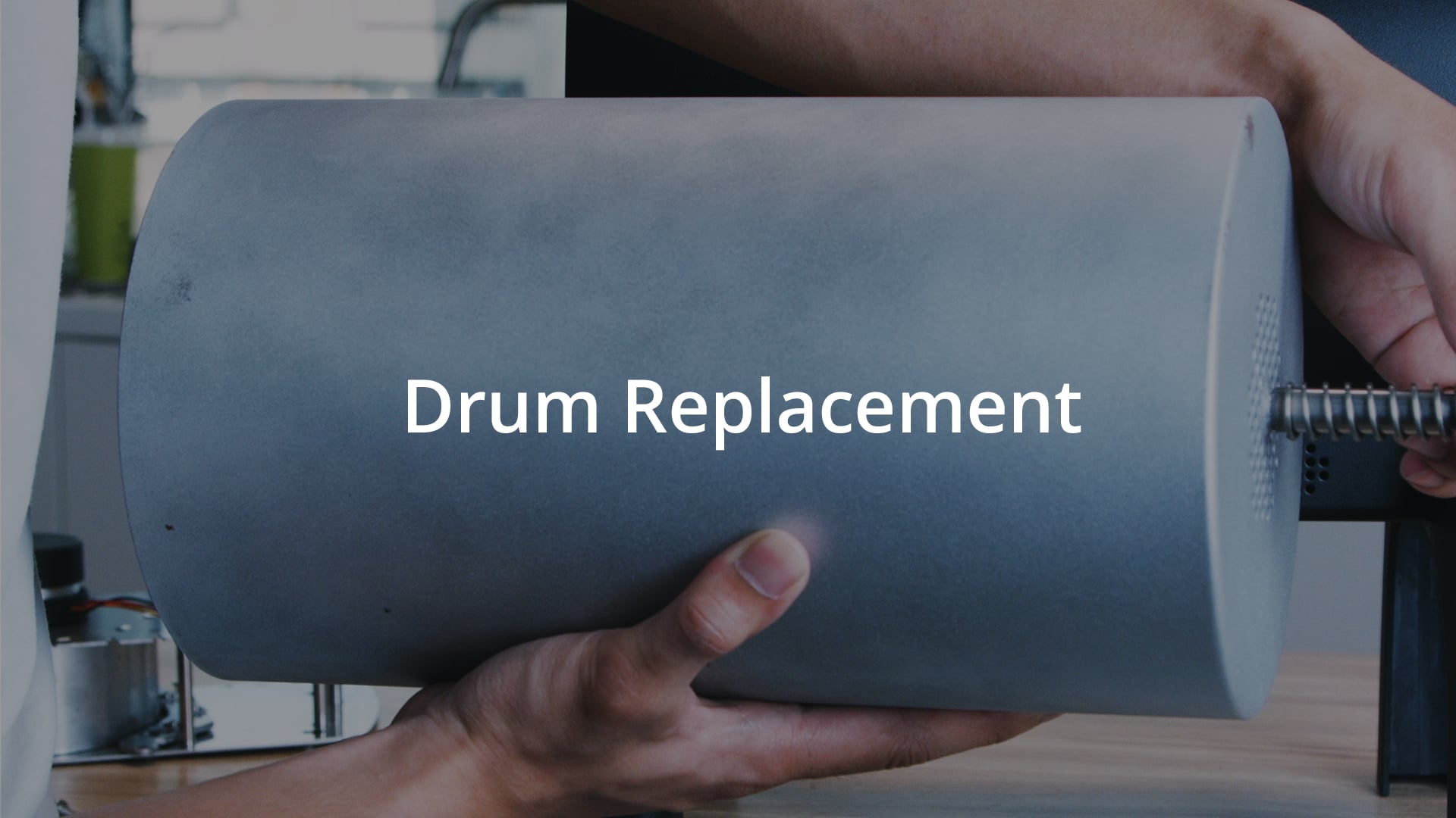

Here’s the Drum replacement guide:
You can follow this guide to access the Drum Spring, but you should mainly check if a thick Shim is still installed at the back of the Drum.

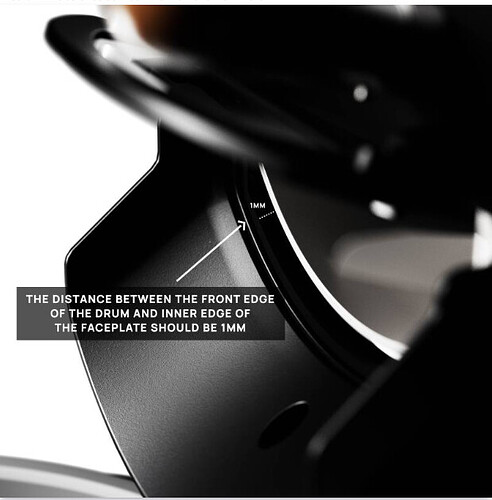

Please also check if the clearance between the Drum and the Front Plate is around 1mm:
