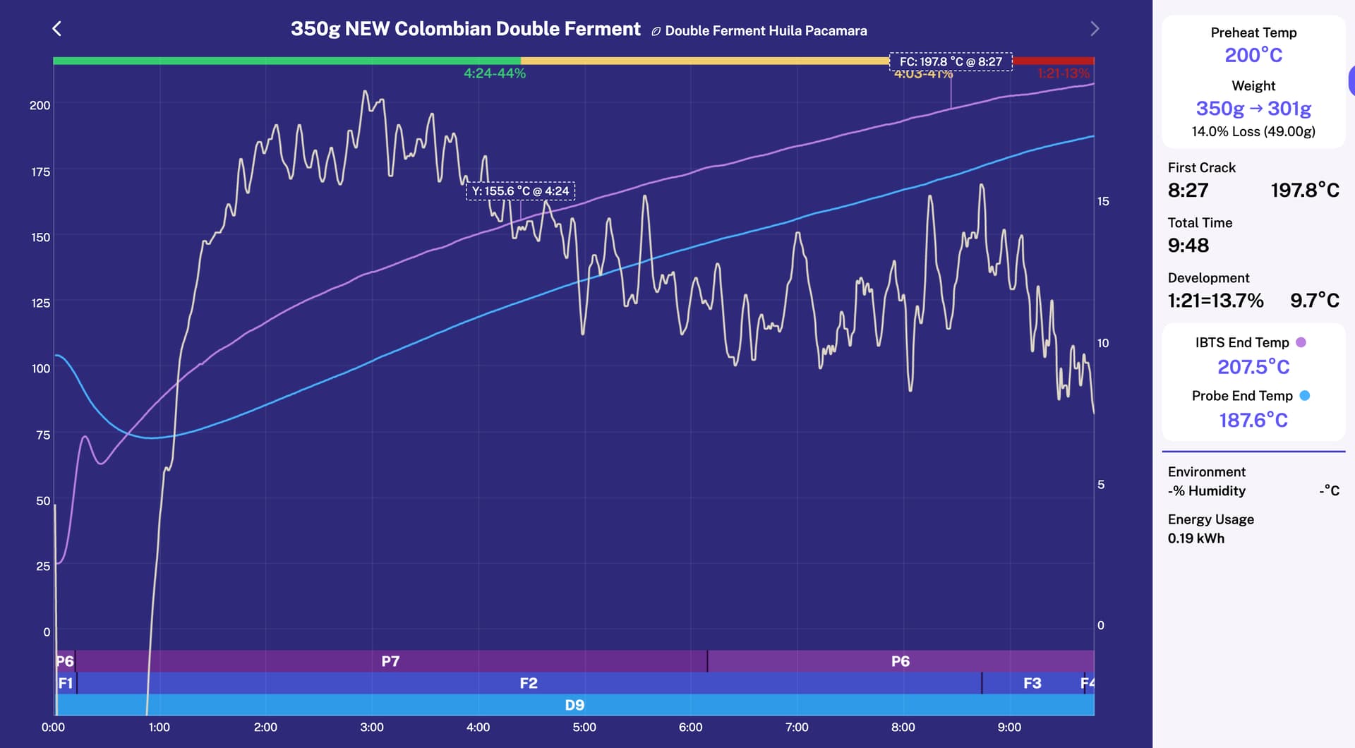

True, the PH on the smaller batch I now see was too high, so I was over-compensating (using RoR as the guide) and that caused some of the volatility in the RoR as I was lowering power to bring it down.
I’ve never accurately measured temperature at all in my prior roasting experience, and instead went based on smell, color and just intuition.
No, I’ve never measured the color. Just experience and charts. I thought a refractometer only measured the external color, but are you saying there’s a way to measure the internal development more directly?
Fair point. As mentioned in my other post, this is the first time I’ve really had any meaningful data available to me.
I definitely found myself in the mode of trying to correct the progress of the roast through power and fan, based on what I had understood was more of a need to manage RoR, Maillard time, development time, etc.
I’ll find a more natural balance with it in the next few roasts and see where that gets me.
Also, I completely destroyed 1.5 pounds of coffee in an earlier roast, so that’s why I switched to 300g but I didn’t lower the PH.
I’m thinking:
  1. Lower PH for 300g
  2. Less manipulation of power
  3. Keep fan consistent (I like that suggestion)
  4. More development time
I’ll see where that gets me.

Yes they are under developed likely with a hay or green taste. I have some observations and suggestions that might help and sorry if i write some trivial remarks along:
  • There is a lot of noise in your RoRs. BTW I suggest roasting with both RoR, from the infrared and from the probe. You will notice difference specially just before first crack.
Solution: Roast with at least 400g. You will have much less noise and more consistent reading to correct you roast afterward. Roasting at D8 also gives more precise readings but D9 seems to be ideal speed for roasting with the bullet.
  • If i look at first roast, you do not have enough heat/energy transfered to the beans at the beginning. The level of the roast curve is important too not just the shape. You need more convex (than what you have) after the turning point.
Solution: First roast, do not charge after 20 min when it says charge. Pre-Heat 45-50 min at 5 or 10 degree over the targeted charge temperature. Adopt a consistent protocol between batches. Adjust the charging temperature according to the load (i.e. 400g vs 600g) but also the size and density of your beans. This is very important and often overlook. And eventually the moisture contained in the beans (for example 13%= charge higher than 11%). If you do not have any instruments to measure that, ask your provider. He should be able to give you density and moisture. You should also know how the bean was treated (washed vs natural pulped, fermented, etc). Take also note of the ambient room temperature and humidity to reproduce roast eventually. And the temperature of the beans before charging (not the same if 19c vs 23c for example). The bullet is sucking a lot of humidity. It can drop 10% after a roast.
I suspect here that your costa rica is from Tarrazu where they grow up to 1800 meters, very dense beans (likely around 0,73g/ml). You need more heat or at least not cutting the heat too soon.
-The second graph shows different heat absorption. I guess different size, density, moist and cellulose arrangements in the bean structure. Difficult to say without knowing the beans.
My suggestions:
  • Start with 400g batches (Try once with a 600g, you will see everything goes slower).
    -Start with an easier bean (less dense) to roast, like a Brazilian bean.
    -Mostly stick to roasting the same bean often at the beginning
    -Clean the infrared before each session (not each roast).
Because of beans differences and also differences between bullet models and even between same models, it is almost impossible to gives sound advice on a specific roast. I put a watt reader on my bullet R1V2 and from day to day at the same P, it draws different watt, so heat is affected.
Anyway if you still want to roast the Costa Rica one I would try that for a light roast with a sweet cup profile.
400g I supposed size 16, density around 0,73g/ml, moist around 12%.
Room: 21-22c , 30% hum
pre-heat: 250c 50 min
Charge: 245c (BT should be around 172-175c if not, rise the charge by 5. If higher than 175c lower the charge by 5).
Start with P8, F3, D9
-Hit F4 when BT around 147-150 (infrared should be around 173-175). Should be around yellowing.
-Hit P7 around infrared 180 (Bt around 160)
-Hit P6 just before first crack (190-195 infrared 175-182 bt probe).
-Hit P5 198-202 infrared(184-190 bt probe)
-Hit P4 205 infrared (194 bt probe)
Then reduces P gradually and until
Infrared 212c Bt probe 204c.
The spread between infrared reading and BT will likely be different on your machine. I would tend to say, do not drop if BT is under 200c if you do not like lighthly under developed notes. Anyway it has not much chance to work given all the unknown factors but basically, you need more heat at the beginning. If above does not work, try briefly going to P9 between 100c and 125c with infrared returning to P8 at 125c infrared.
ps your costa rica is not bake. The batch hasn’t stalled either. It is underdeveloped. You cannot follow any indications using time per say as without kwowing the beans characteristics it does not say much. However, your timeline does not shock me for a light roast.

I apologize in advance, but I must ask why would you say that when development ran for 2m11s with DT of 12.9°C and took 30% of total roast time? Those numbers indicate overdevelopment, not under. Also, the beans have reached
Let me be clear, I’m not trying to prove anything, I’m just interested in an elaborate explanation. Also because the beans wouldn’t be underdeveloped with 10% and 5-6°C DT. Actually, light roasts have much shorter development that rarely goes over 10%, but usually less if it’s a faster roast.
Hi all. Very helpful feedback, and I’ve been incorporating it in the last two roasts. I’m still experimenting, but I got closer with this last 350g. I’m going to start doing 400g as kafcafe mentioned.
The previous batch - where I was at 11 minutes at the end - were clearly baked. I’ve never really experienced truly baked roasts to that degree, so now understanding what it’s like is a helpful learning lesson.
Mainly because the Development Time alone does not tell if the beans were well "prepared"for the DT phase. You could have twice the DT that you have here and still have underdeveloped notes in your roast or risk baking the beans). So what i mean by “prepared” is mainly what is occurring in the yellowing phase - browning phase we often called Maillard phase.
Basically the Yellowing-Maillard phase should be viewed as a conditioning stage. The DT phase often called the “flavor stage” is where the specific balance of sweetness, acidity, and bitterness is fine-tuned. But you have to have something to fine-tune first. I guess that would be the short answer. For a longer one if interested:
